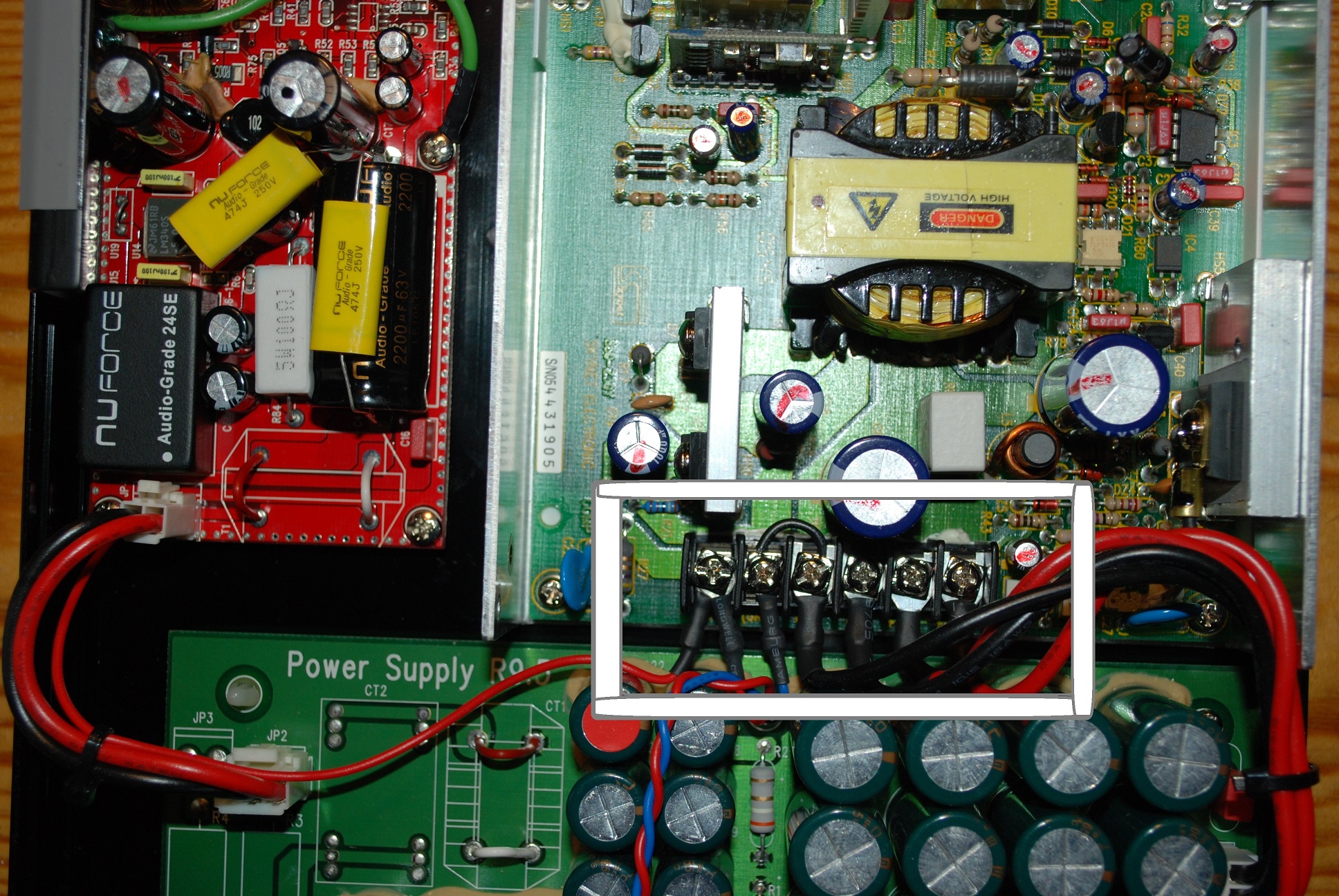

nuforce amp board hypex (or any other brand psu)
It goes to here, below JP4
attachment.php

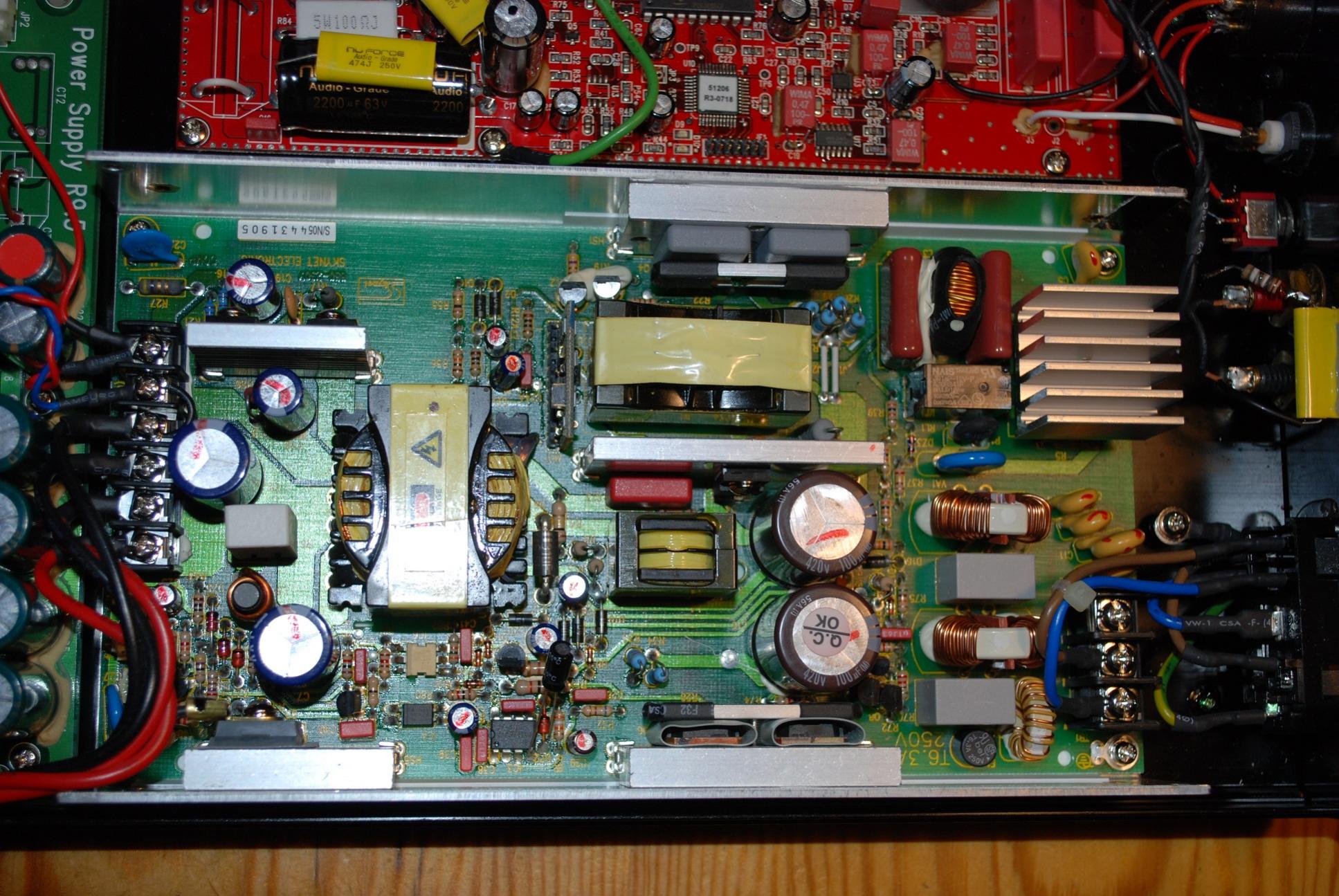

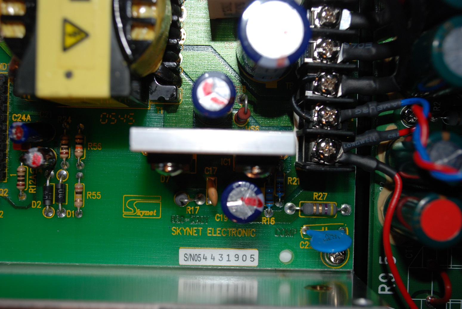

Funny Y is 52V but board states 48V you mentioned, and that would be T version 🙂 I think they are EOL, no longer in production.
The ampboard seems to need separate 5V then. (JP4 pic) A stepdown converter on aux voltage smps1200a180 ?
Voltage is right, but doesn't need to be dual rail. Any issues just using the + side of the supply?
Some people use these with their Class D amps Mean Well MW NES-350-48 48 VDC 7.3A 350W Regulated Switching Power Supply but you have to deal with the fan noise somehow (modify with a larger fan). You'd need another small 5v supply in conjunction for that other 5v rail.
What is the + side ?.According to documentation the Z30T has 2 +48V and 1 +5V, no -Volts! I would really like to not use a fan if that is possible : ). Is there any specific 5v psu that you could recommend?
