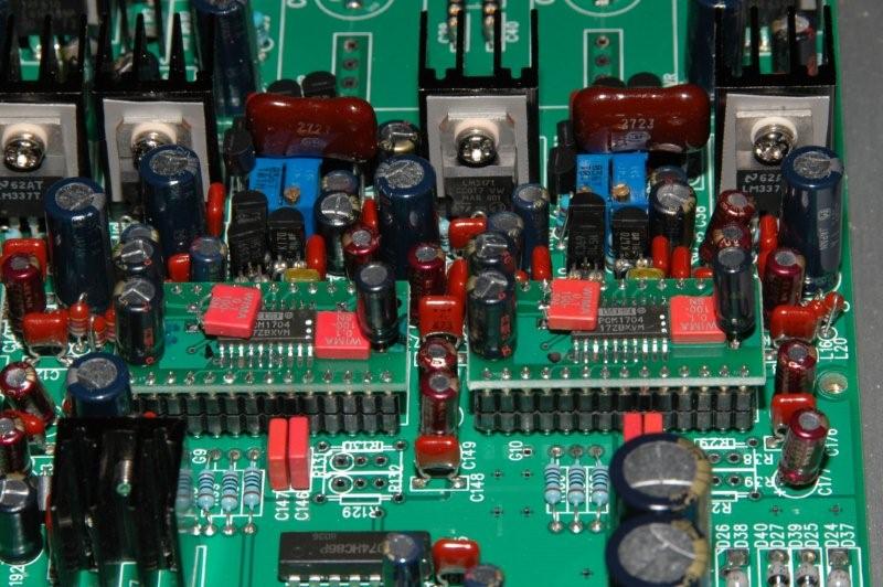

I only provide PCM63PK chips at this moment.
The converter board I use is designed for PCM1702. For Pcm1704, the digital supply +ve and -ve pin must be reverse connection and thus I need to cut trace and solder two wires at the bottom. So there is no PCM1704 converter board available from me yet and I cannot offer any price.

I forget one thing, if your new pcb have more space, I am not able to put in any more seriuos metalized 0,1uf fil cap. wima MKS will fit but smallest wima MKP will not fir in with in pcb are only 2mm and wima MKP is 3-4mm (pcb pi spacing is 5mm and OK , height not important)
I think I may order one extra kit to compare.
The D1V3 and D1V33 pcb are same size, same mounting hole position, same connector position and use same size parts for the 0.1uF film cap, ie 5mm pitch and size3x8mm. If you have a bigger size film cap, some of the location near the jfet IV section may not be fitted. For bigger size cap, you have to solder on the bottom!
In D1V33, I change to Panasonic 0.047u 50V ECQ-V or ECQ-B (old version but bigger size) and I find most of the locations can be fitted.
MKP is more expensive and may be better for signal coupling but I think MKS or mylar cap is ok for supply decouple.

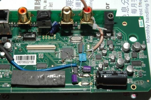

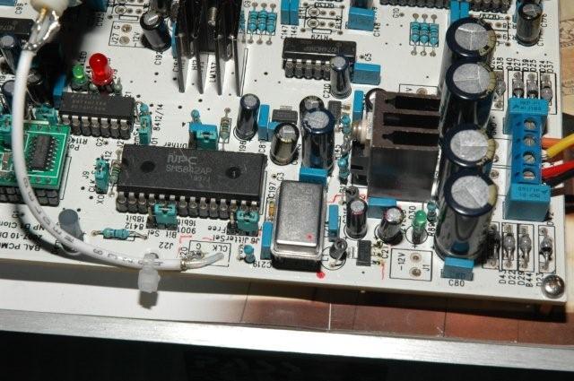

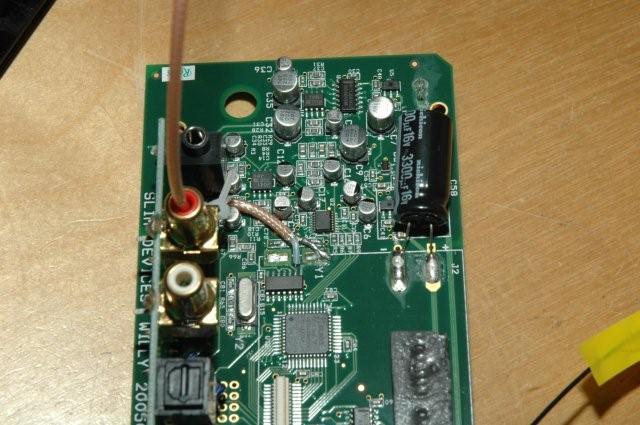

Squeezebox SB3 slave to D1V3 clock:
Put a 11.2896Mhz clock and other regulator parts in D1V3, R95 change to 330 ohm and then put a 220 ohm at J20 "CLK to G". This is to reduce the 5V clock peak peak level to about 3.3V for SB3 use. Connect the clock out via a SMA size coaxial cable and BNC socket as shown.
One the SB3 side, remove Y1, cut trace between HC04 pin 8 and crystal pad. Use the coaxial cable, connect the center wire to pin 9 of HC04. The ground pin connect to crystal pad which is then grounded to pcb to the nearest cap ground pin.
On D1V3, set jumper J9 to XO side. Power up D1V3 and then SB3. Play music as usual. Note that a hard reset on SB3 is required if the SB3 input clock is off before.
Note that I do not see much improvement on the digital out of SB3 by using linear power supply or adding a pulse transformer at the digital output.
Enjoy!
Enjoy!
