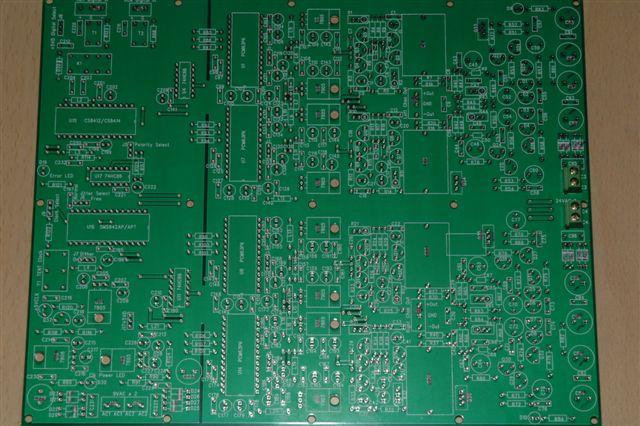

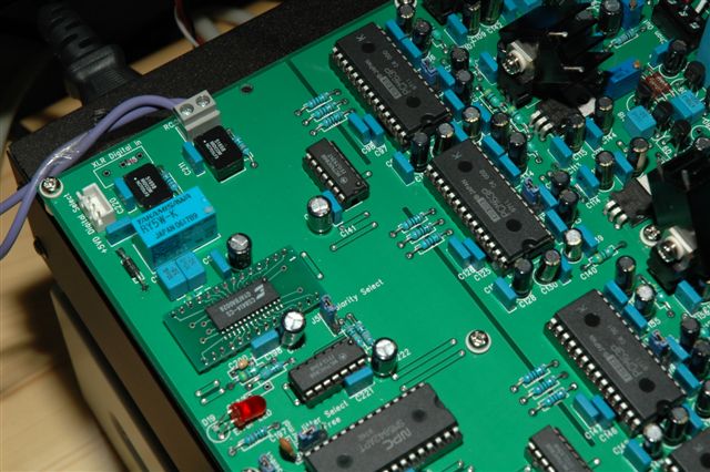

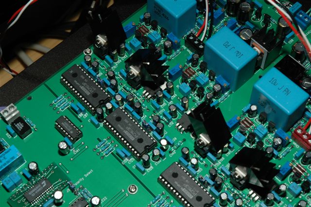

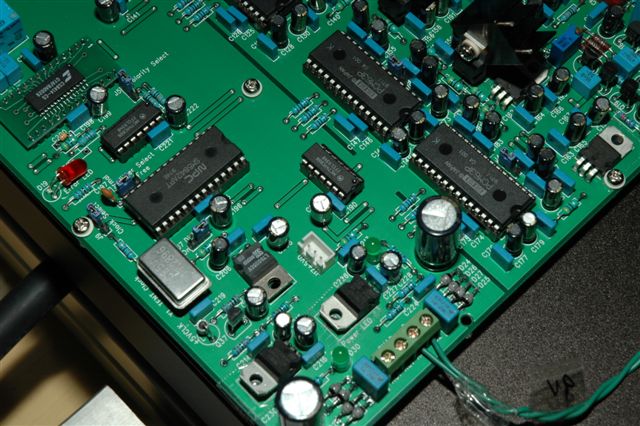

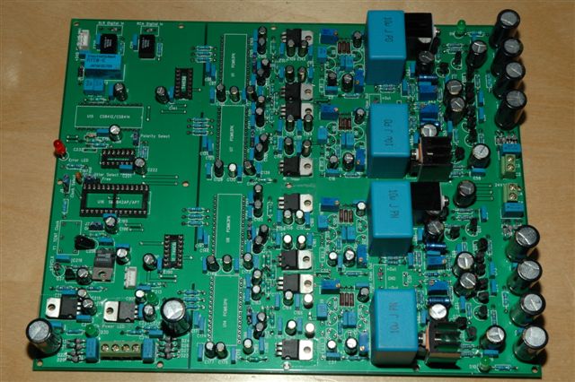

Boards received and will start soldering. See attached.
