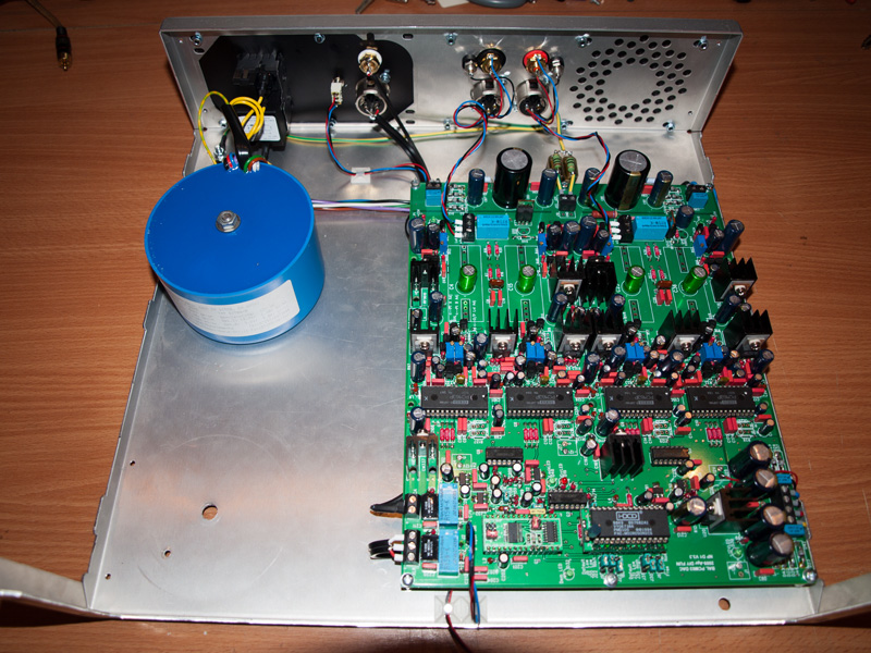

Hi @all,
after a very long time the D1 is in his temporary housing.
The inside picture is not the actually, the output caps are now black gates.
Thanks Spencer for this DAC. The tests with "WM8804" and "NPC SM5842AP" comes later after enjoying this for now. 😉
