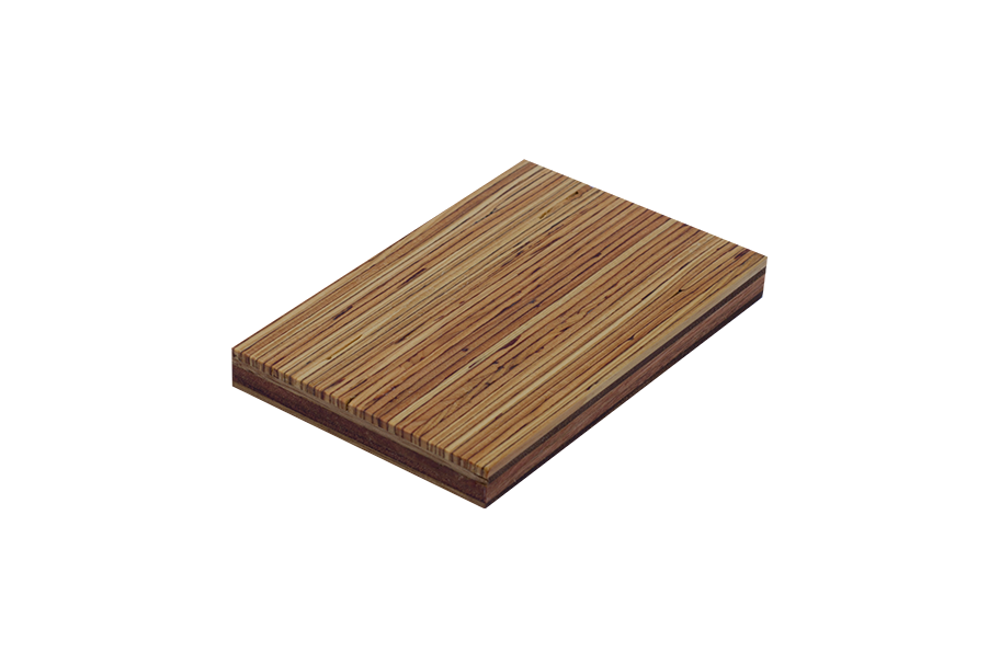

If you do want the "rustic" aesthetic of the plywood edge, again, you can get that without wasting tons of material.
Just cut the staves from plywood that ALREADY has that look. Here's a link to a seller. Pic also attached, for when the link breaks 🙂
Maxi Edge | Maxi Edge Plywood | Maxiply

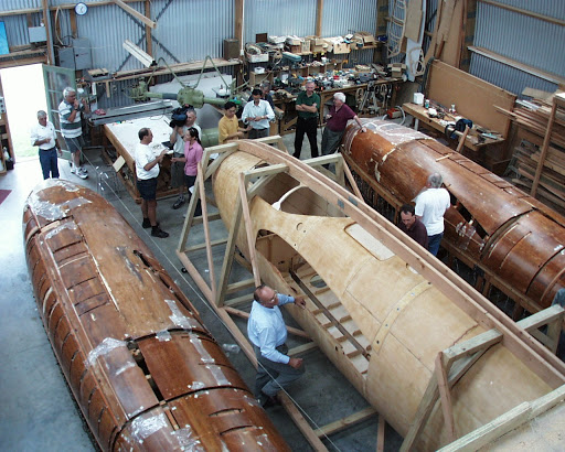

Bending wood across bulkheads and frames is how wood boat hulls are built.
The mosquito was similar (they were made with plywood pressed into concrete forms).
Low waste, good strength:weight ratio. The plywood was better (and cheaper) than aluminium, which was a super important consideration at the time.

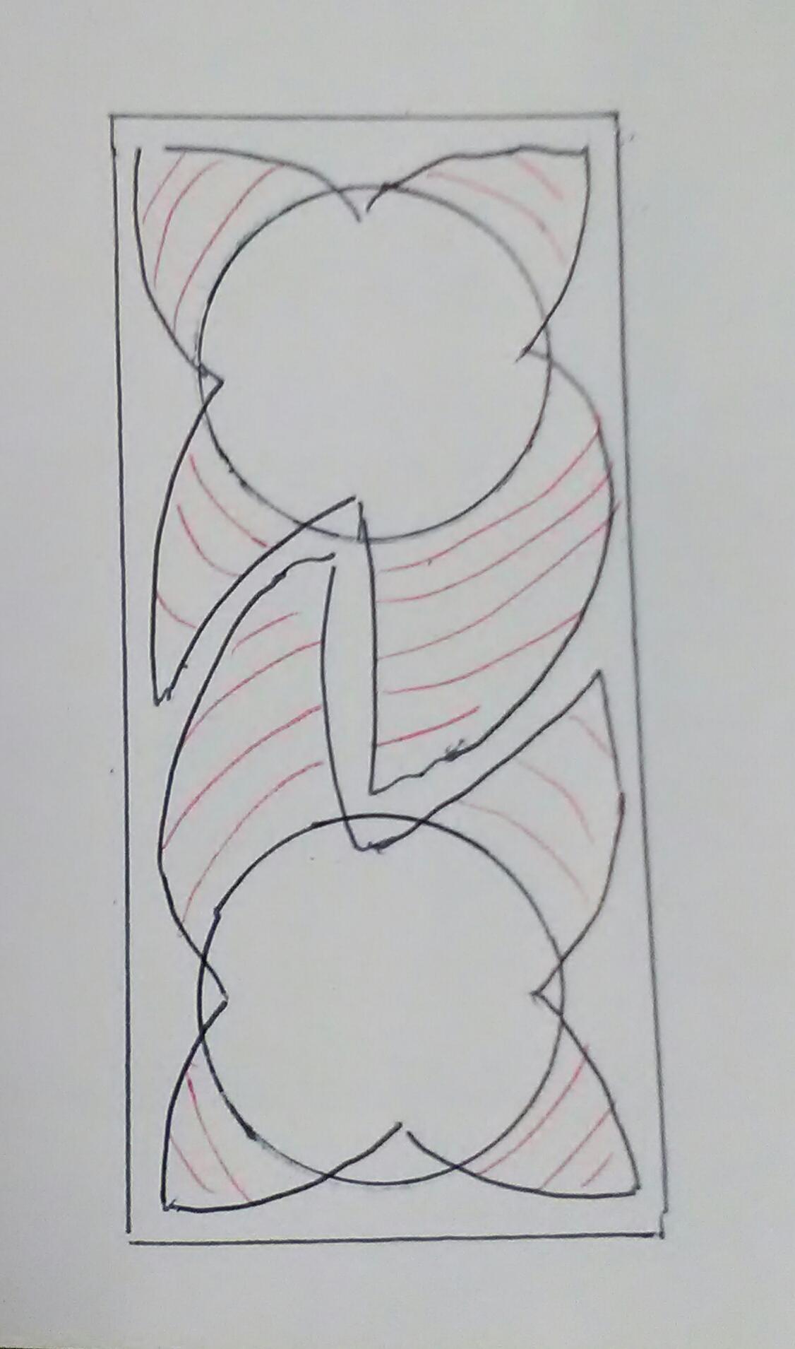

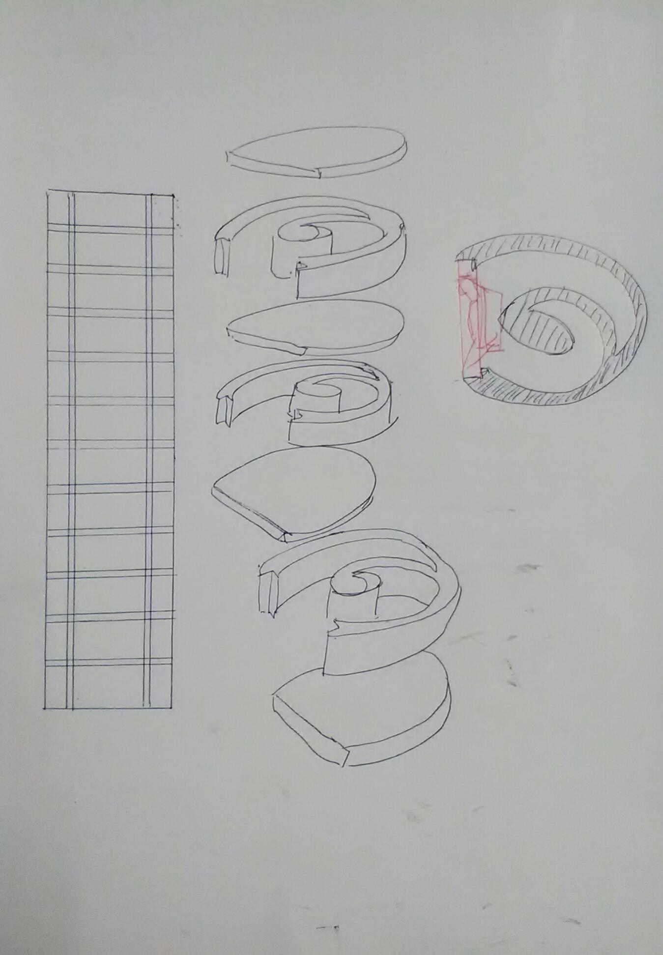

Cracked case are those middle braces in the drawing compliant mechanisms?
Pretty cool stuff could be done with 3D printing. How about trying stiffness and damping on same honey comb structure?😀
Few examples of compliant mechanisms
Metamaterials create mechanisms from a single piece of plastic - YouTube
3D Printed Compliant Mechanisms: 10 Great 3D Models | All3DP
I think that what you are referring to as a compliant brace is actually the divide between two chambers, both drivers have their own chamber ( shaped to defuse any reflecting sound waves, hence the " petal " shape ) , both chambers are then aperiodicly vented to the main enclosure. I am experimenting with compliant braces though, but it does seem very hit and miss, they're either to stiff or to soft.

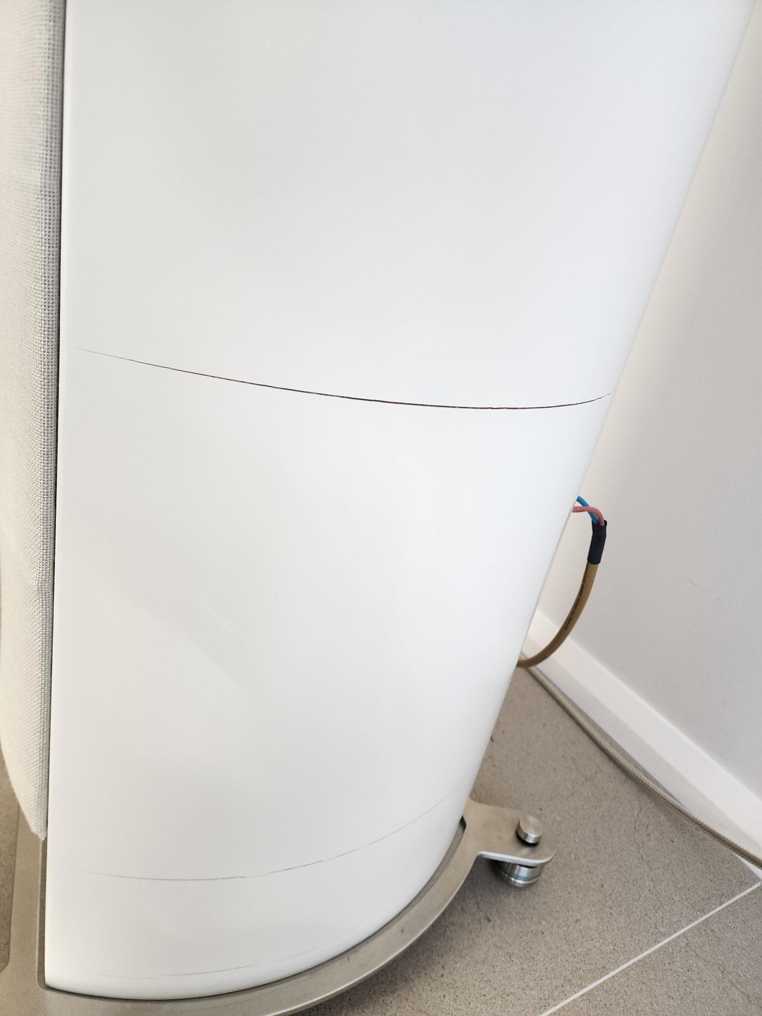

You were exactly right. I'll do a full build at some point but...
This was the 2nd main prototype
The 3rd which was to match split very quickly and badly - I hadn't completely covered the outside so the MDF shrank - I think it was 10mm shorter than the one above!
Gutted
Eventually, the 2nd started to split too - when I took the drivers out, the inside must have dried out and shrunk.
I'm all in at this stage, I've spent about £1000 on drivers and about £400 on crossover parts.
I went back to the guy I'd found to CNC the slices for me and he suggested moisture resistant MDF.
So I did 4 things (which is never great when diagnosing a problem):
1) Used MR MDF
2) Left every slice to acclimate in my living room for 2 weeks.
3) Sprayed Shellac-based primer inside and out of every slice (64 in each speaker)
4) Built each speaker in sections
However, I used the threaded rod again and clamped all the sections together to bodywork the whole speaker in one go.
When they were perfectly sanded (about a months work) I undid the rod and split them:
Then I put based coat and clear coat while they were together again, then split them for colour sanding and machine polishing.

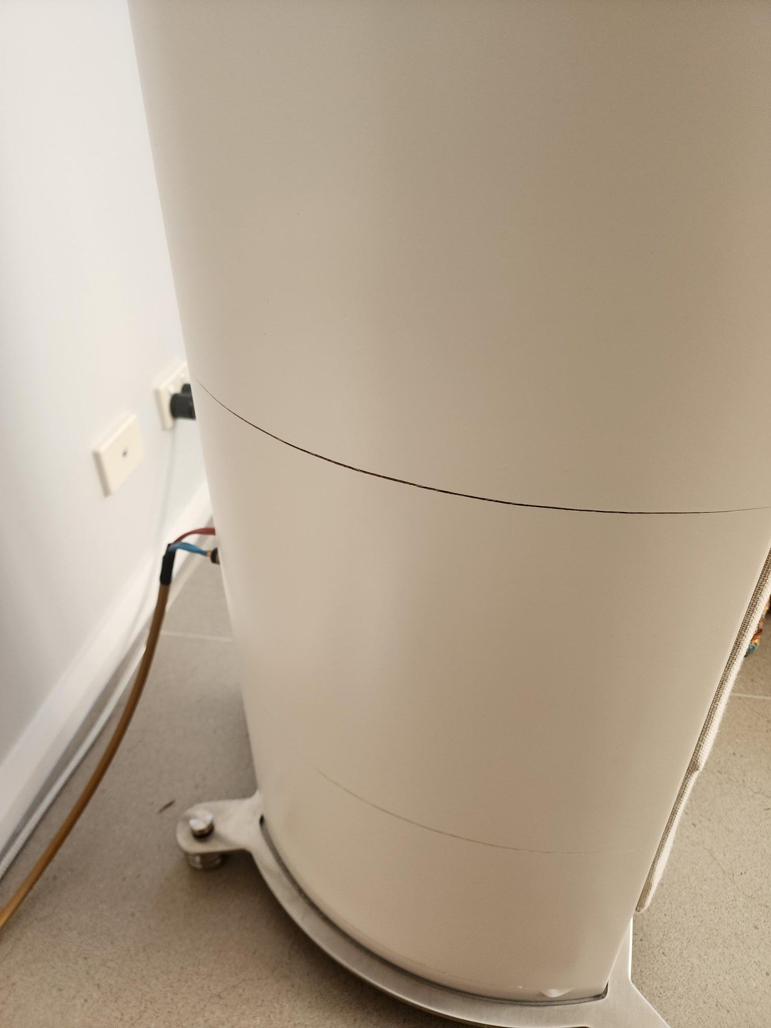

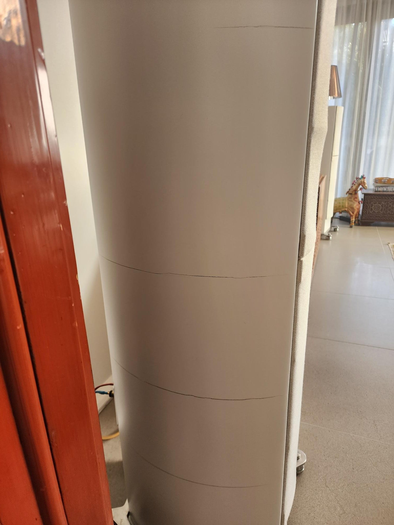

Hi rngDeadeye,
It was interesting to read about your Translam speaker cabinet build. Great insights. How is your last build from 2021. The one with 64 slices. Are they still sound and looking great?
i completed a build last year and my speakers have started to develop lots of cracks. Even after the first two month cracks were forming, now with a change in humid lots are appearing. it’s a dry Sydney winter. it would be a costly shame to scrap the cabinets.
just contemplating whether to try again using your method (follow the 4 steps) or try something different.
any feedback would be great.🙂
