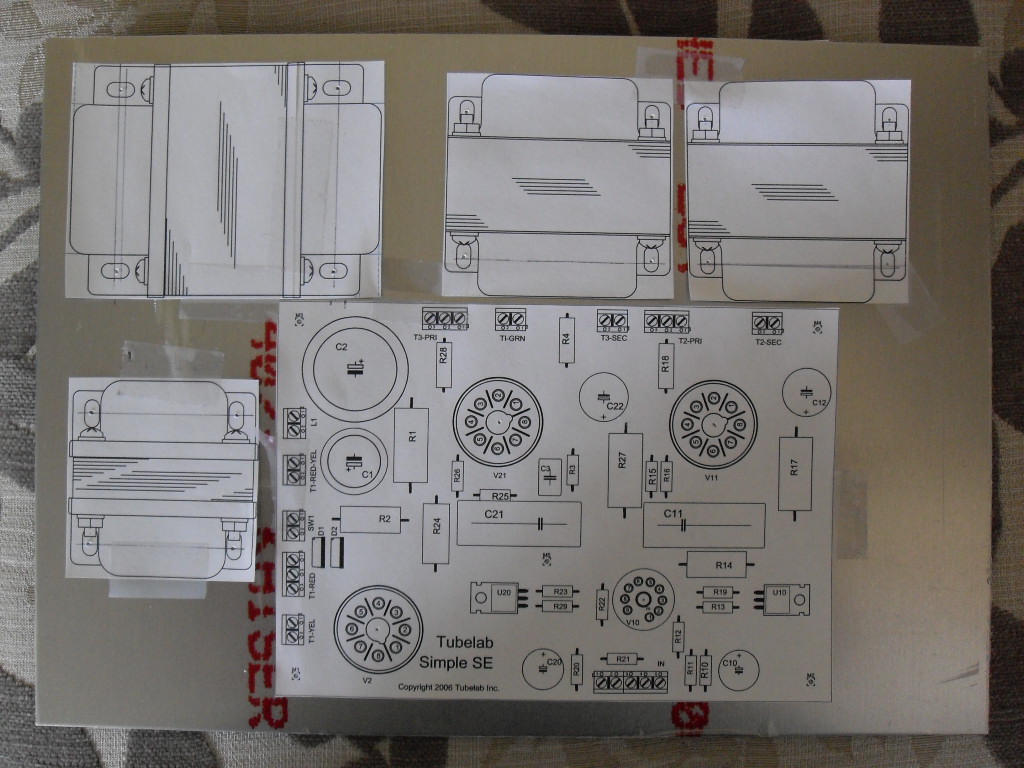

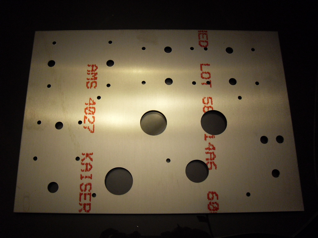

Started working on the simple se top plate. I will be posting pictures of chassis this weekend
Nice! paper templates......they work great!

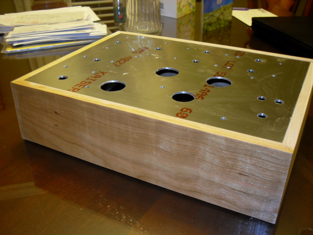

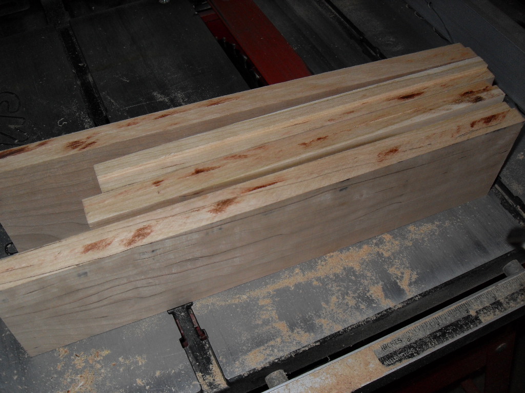

Judging from the tool marks, a table saw?Your case work looks excellent. I'm planning and SSE project myself, was thinking along similar lines. What tool did you use to cut the 2mm? recess along the edge of the 4 pieces of wood?
Thank you for the compliment, I used a table saw for the recess and just mitered the corners. Blade must have some varnish build up. The top plate is from online metals. I would wait to have the metal on hand befor making any cuts, they only guaranty size to + or - 1/8"

Hah! I must have missed that little detail when I ordered mine. It was "close", but it took some work with the belt sander to get that panel squared up.Thank you for the compliment, I used a table saw for the recess and just mitered the corners. Blade must have some varnish build up. The top plate is from online metals. I would wait to have the metal on hand befor making any cuts, they only guaranty size to + or - 1/8"
SSE is running! Sounds awesome! There is enough iron mounted on top this thing to make a half dozen smart cars. I put this together in a basic configuration, I will be adding a aux cap soon. I most say the volume is quite satisfying, which I was alittle worried about. I will post pictures soon.
