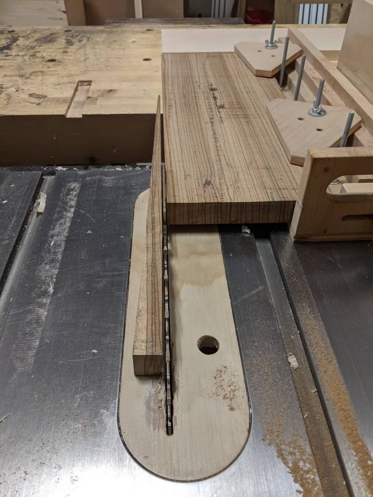

I started off cutting a piece to rough length then trimming it to width using a home made tapering jig on the table saw. This allowed my to get the grain running straight across, this is the centre MTM speaker.

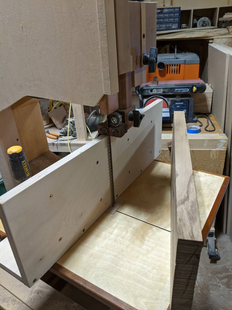

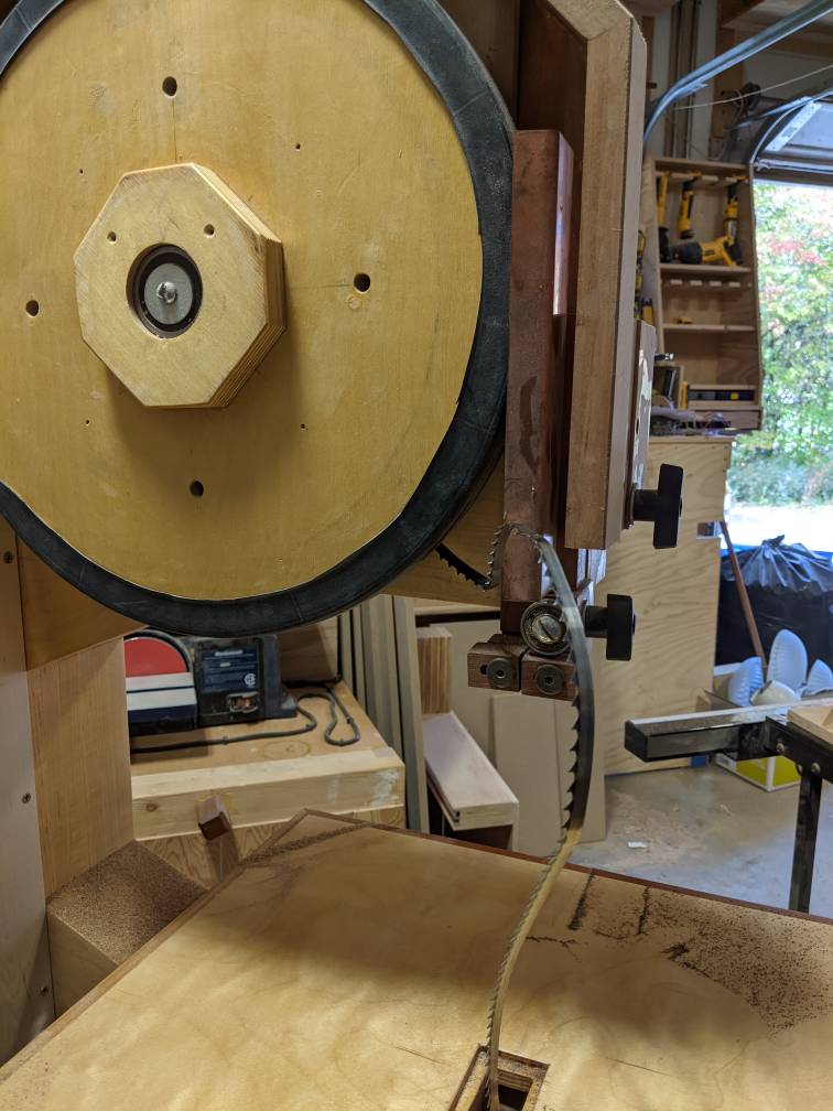

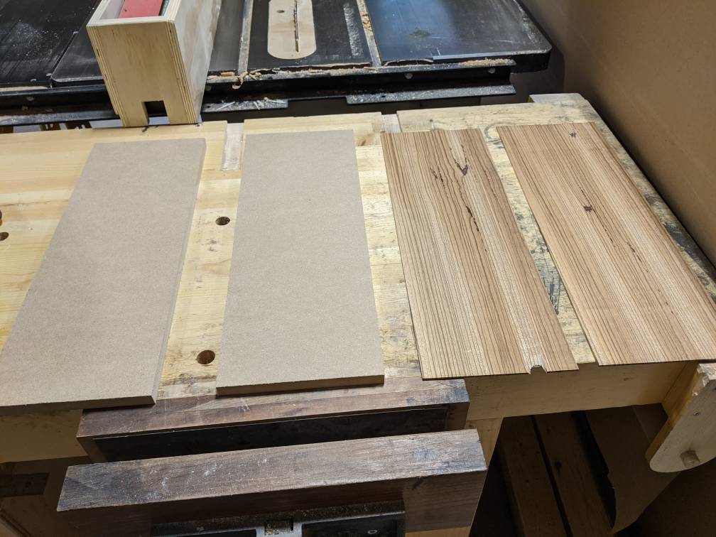

I used a high square fence on the homemade band saw to resaw the board down to about 3/16" thickness. In between each slice I put the stock back through the planer to clean up the face. All the panels were thicknessed again to a little over 1/8".

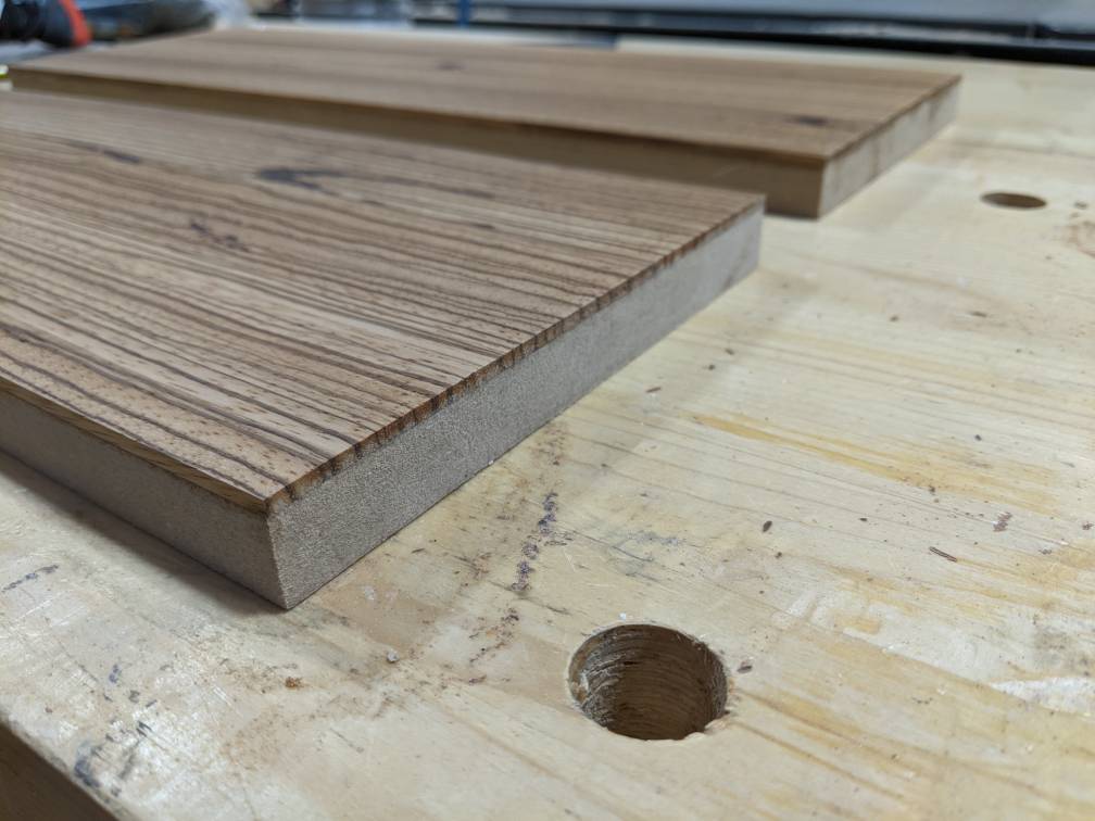

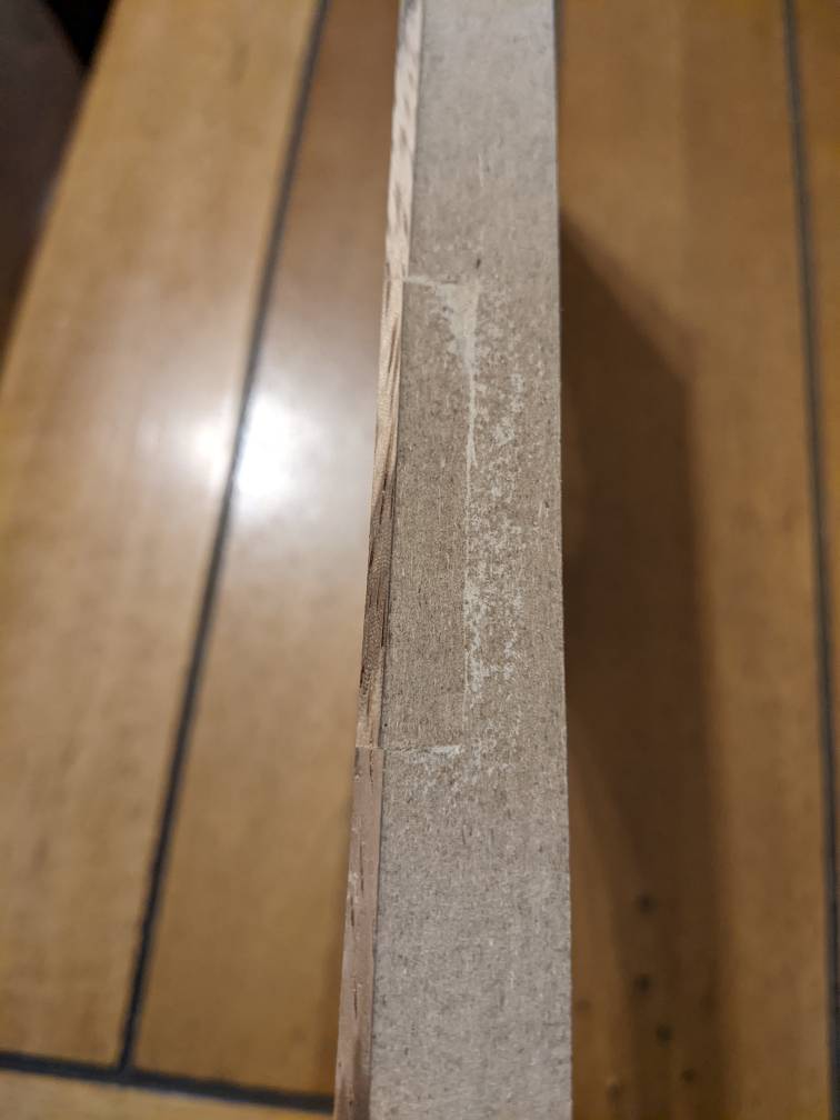

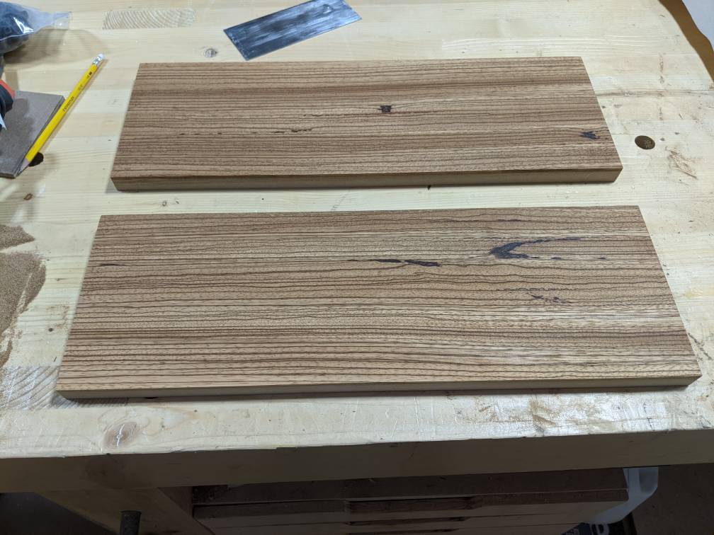

Finally I glued the veneers to the 5/8" MDF substrate so I should end up with panels just over 3/4" thickness.
I used polyurethane construction adhesive, spread thin, because I'm hoping this will be less likely to cup than water based glues. If it does cup, then I'll make these two panels again and put veneer on both sides.

I think the only risk is if it's too thick the it will still move with the seasons. From what I've read anything up to 3/16" should be fine. The bigger problem will be any cupping due to me only veneering one side. I plan to do the same with all the other panels for the cabinets, bit they will be cherry veneer.

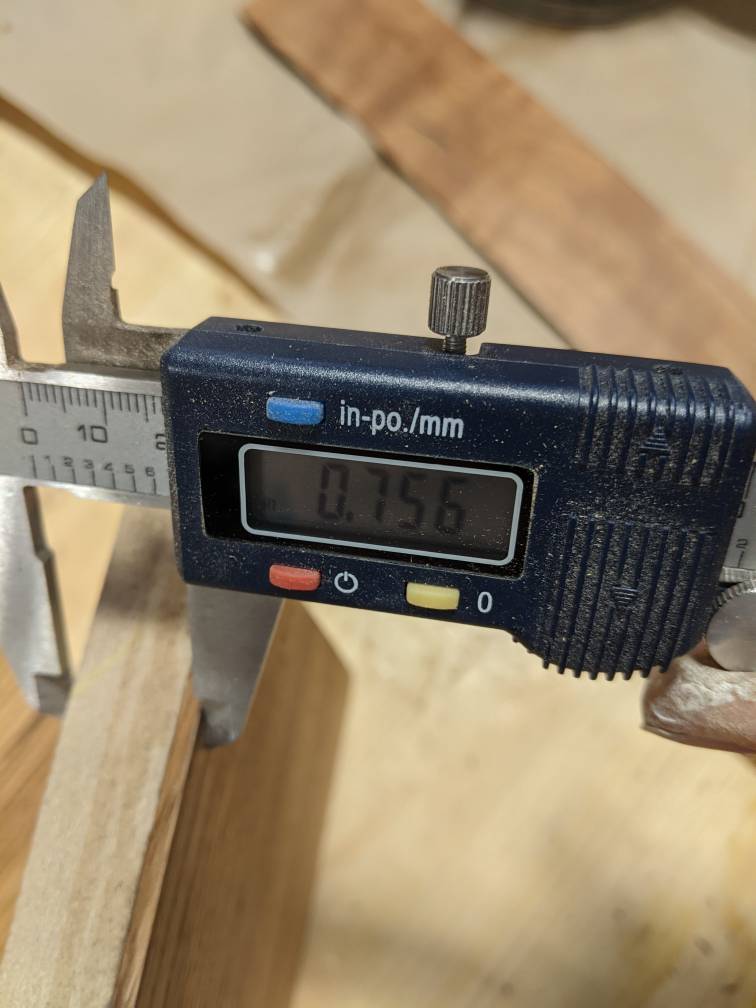

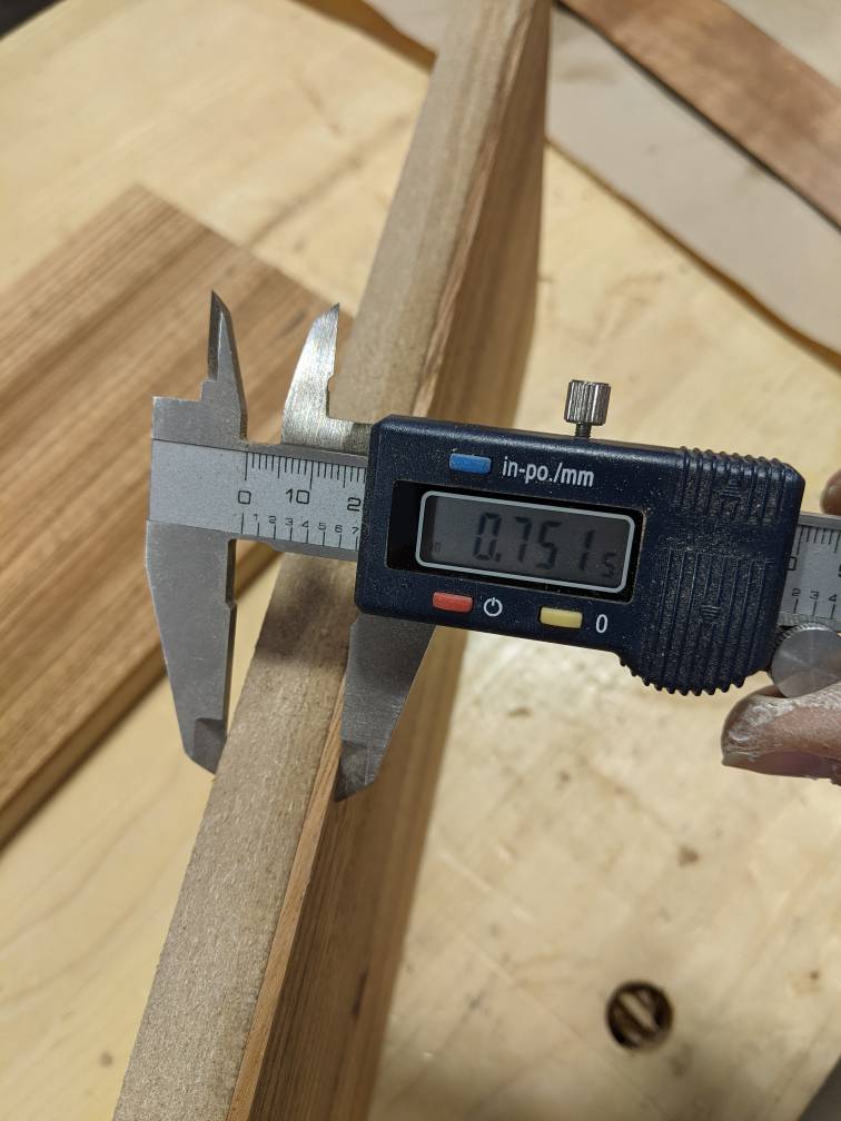

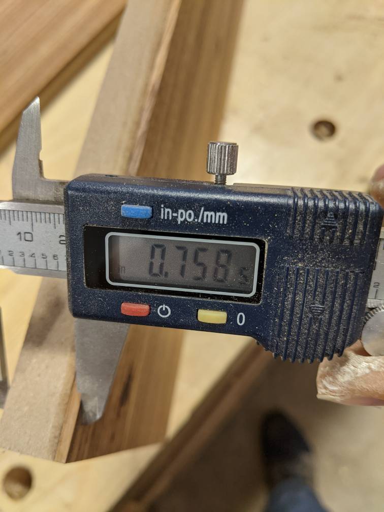

Looks like I got away with it, no bowing or cupping after taking the panels out of clamps. I trimmed them square, about 1/8" bigger than I need so I can finesse for final fit into the cabinets. Sanded to 240 grit and put Ona couple of coats of clear shellac to get an idea of the finish. Measuring with callipers I am between 0.750 and 0.765 all the round both panels so very happy with that.

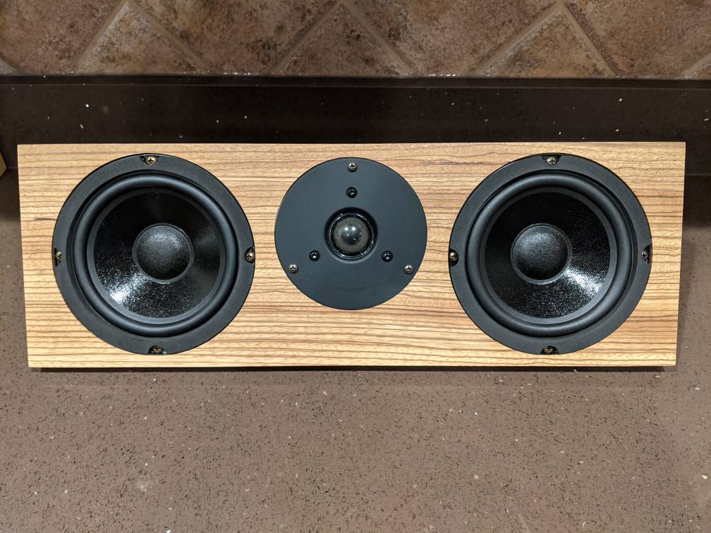

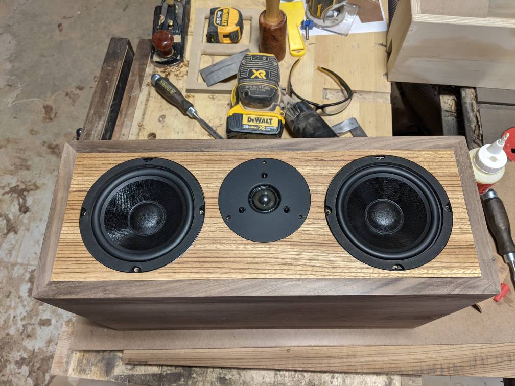

Small update, I cut the holes in the baffle using a router and circle cutting jig then fitted the three drivers. I used antique bronze screws to add a subtle bit of colour, I have an idea to continue this later in the build.
I'm pleased with the look so far, I'll make up the back panel while I have the circle jig out and then go back to milling lumber and cutting veneers for the sides. I did find a few boards of walnut so I'm thinking now about walnut instead of cherry veneer for the cabinets. This would give more of a contrast.PXL_20201012_183127315.jpg

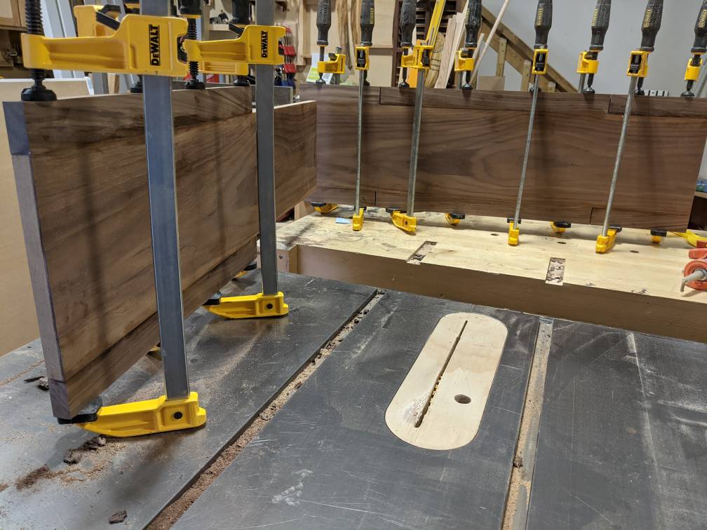

Well I was slowed down a bit yesterday because my band saw blade decided to go off on a scenic route. Unfortunately I didn't have another wide blade and so that stopped me making the walnut veneer. I did manage to pick up a new blade later in the day and glued up a pair of walnut veneer panels over night.
Today I milled some more solid walnut to create a thick edge band along the panels. I used polyurethane construction adhesive again as a glue, it is much more effective than PVA glue on MDF, I also added some biscuits for alignment and a little extra strength.
Tomorrow when the glue is dry I should be able to finally cut the pa else to size and mitre the edges so I can finish assembling the first speaker.PXL_20201013_152924651.jpgPXL_20201014_195612732.jpg

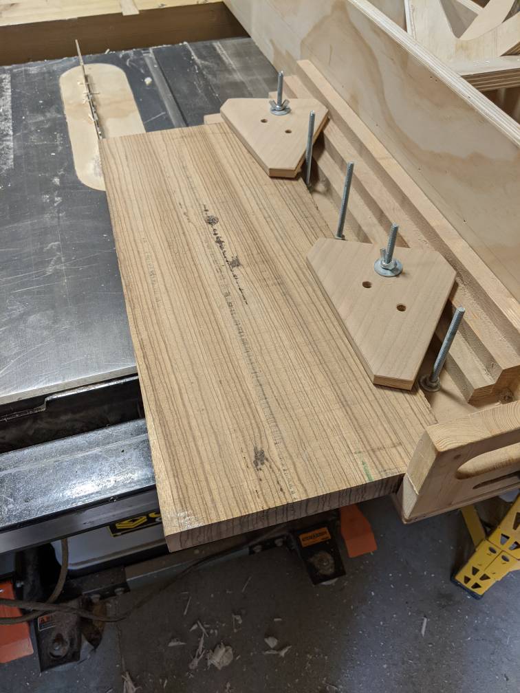

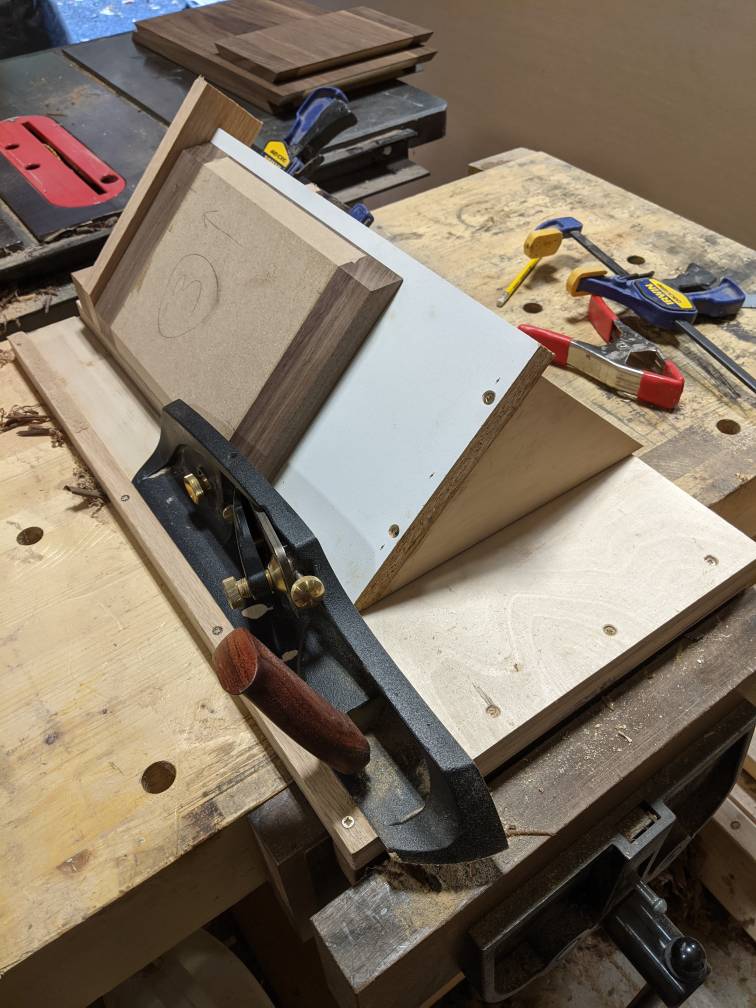

I wasn't quite getting a perfect long mitre on my table saw, not sure if it was the blade flexing a little or some problem with the setup. So I made a 45° ramp for my shooting board and used a hand plane to true them up.

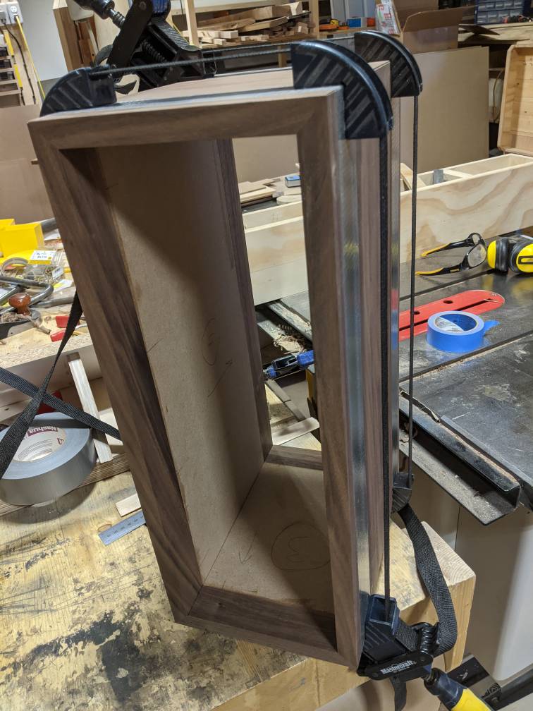

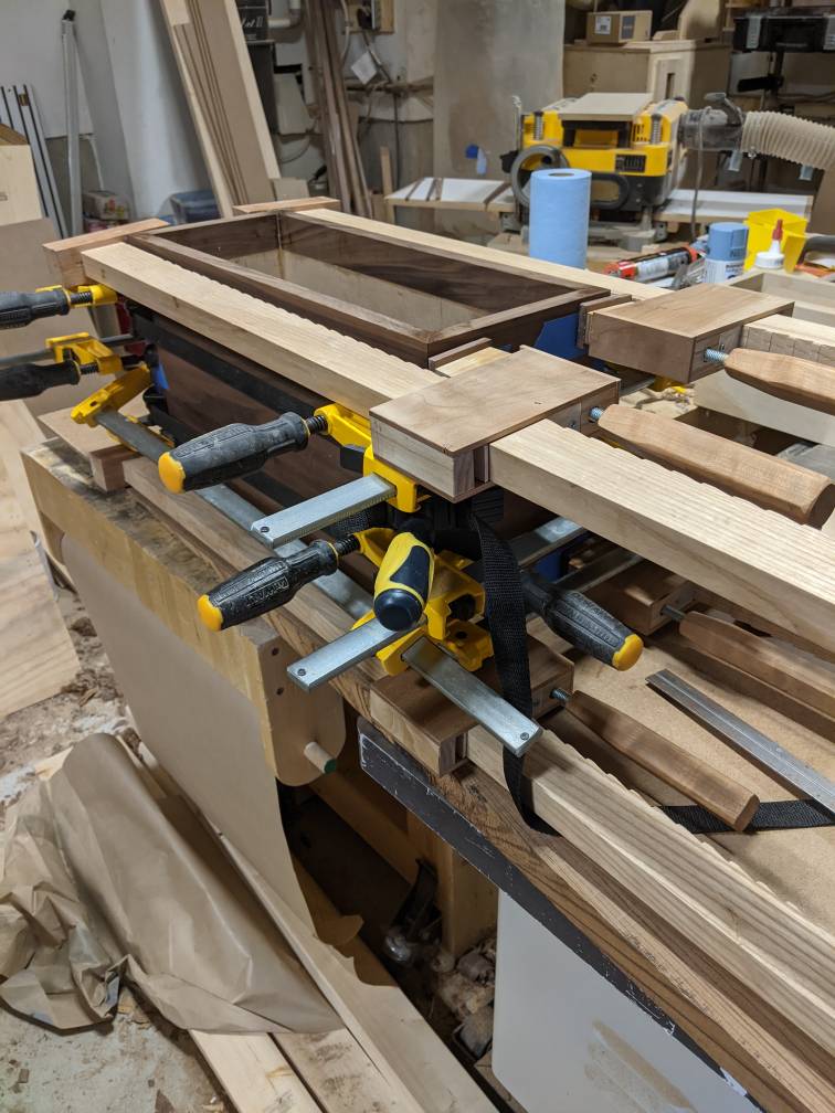

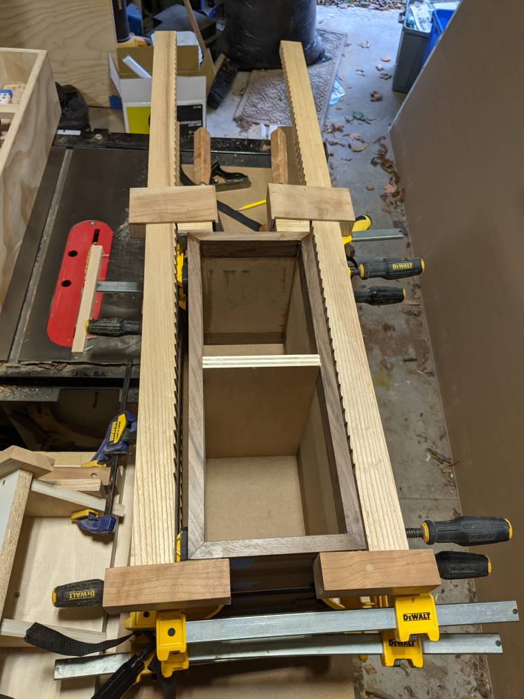

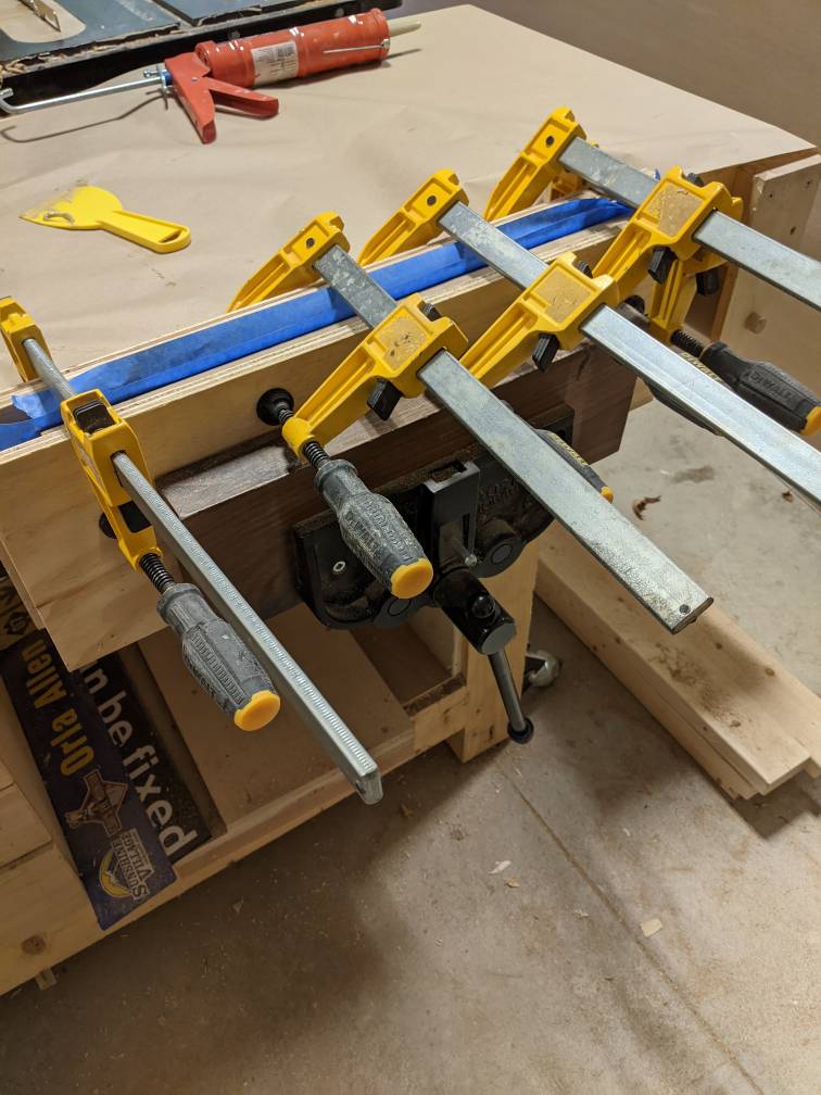

Dry fit looked good so I put polyurethane construction adhesive on every surface, taped and then clamped the cabinet up. There was a tiny amount of bowing on the long sides so I added a temporary brace to keep them parallel.
All the mitres look good and tight and the angles all seem to be a perfect 90°. I'll let it dry overnight and then fit the front and back panels to finally finish my first speaker.PXL_20201015_180500805.jpgPXL_20201015_182604887.jpgPXL_20201015_193308916.jpgPXL_20201015_201649851.jpg

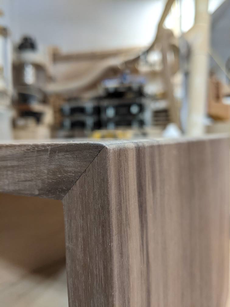

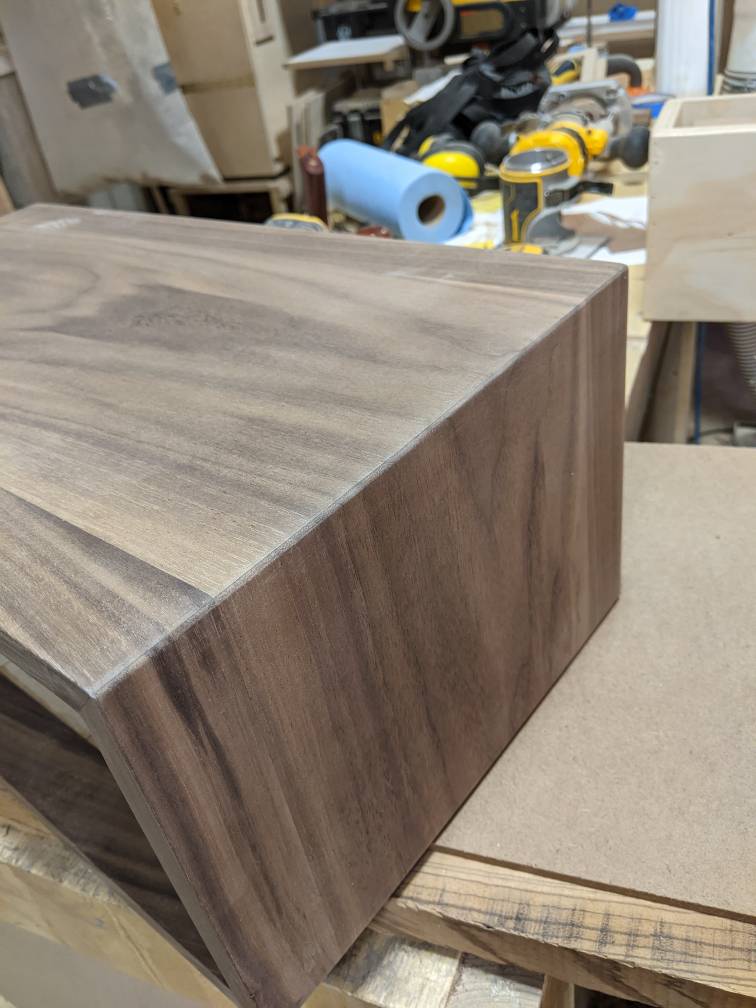

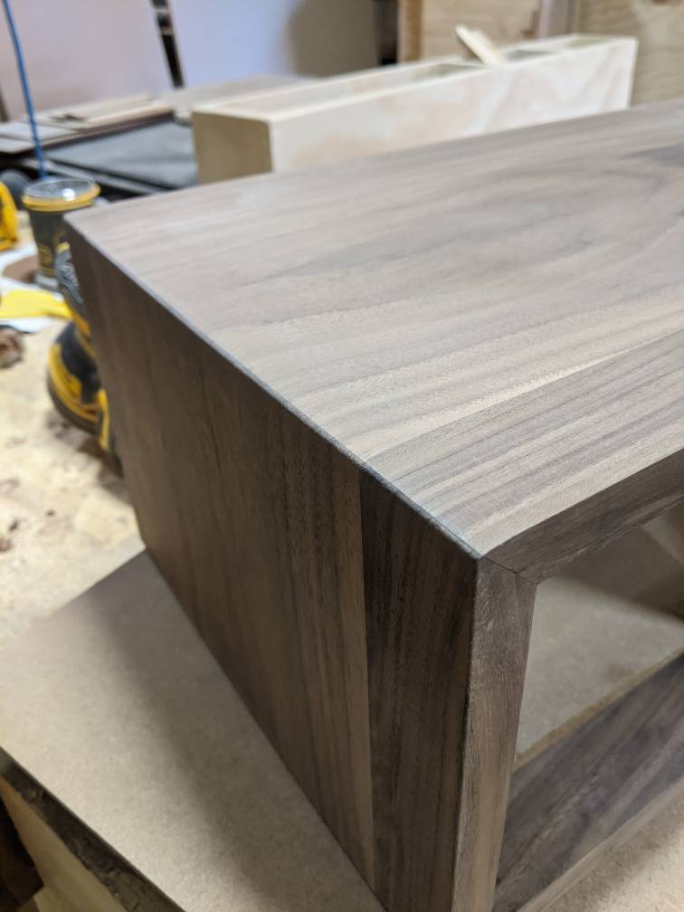

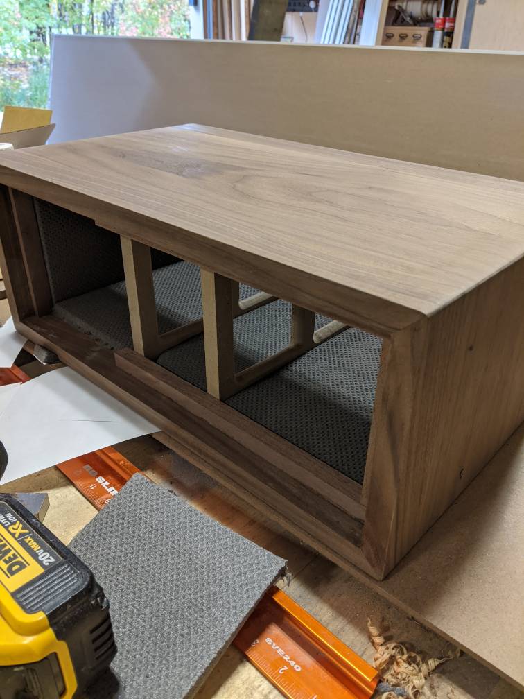

The glue up went well, the mitres were tight and because I used thick veneer I was able to put a nice roundover on the corners.

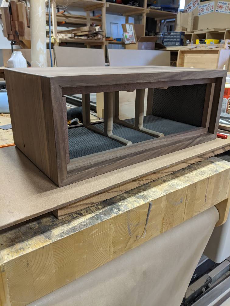

I put in some braces to provide vertical strength and added some cleats to support the front and back panels. I'm not glueing the panels in yet, they are a good tight friction fit and I still have some aesthetic detail I want to add to them.
I did put in the foam and then fitted the drivers, crossover, terminal cup and port just so I could confirm that the speaker actually works.PXL_20201016_142045692.jpgPXL_20201016_142056025.jpgPXL_20201016_142116755.jpgPXL_20201016_191546912.jpgPXL_20201016_191600409.jpgPXL_20201016_154748608.jpg

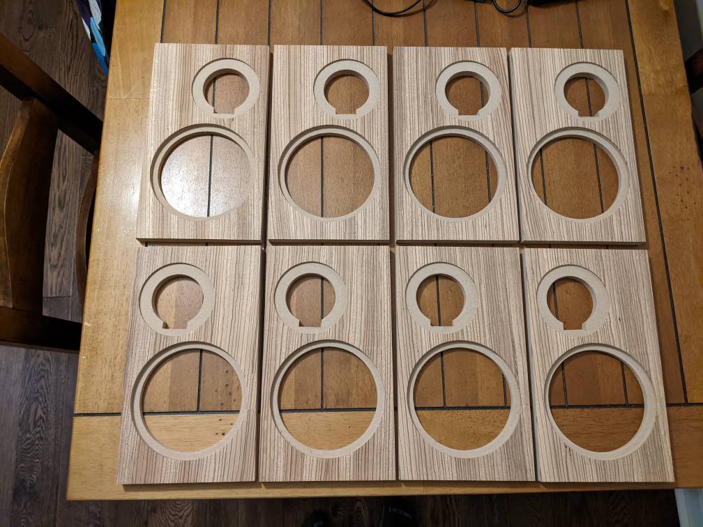

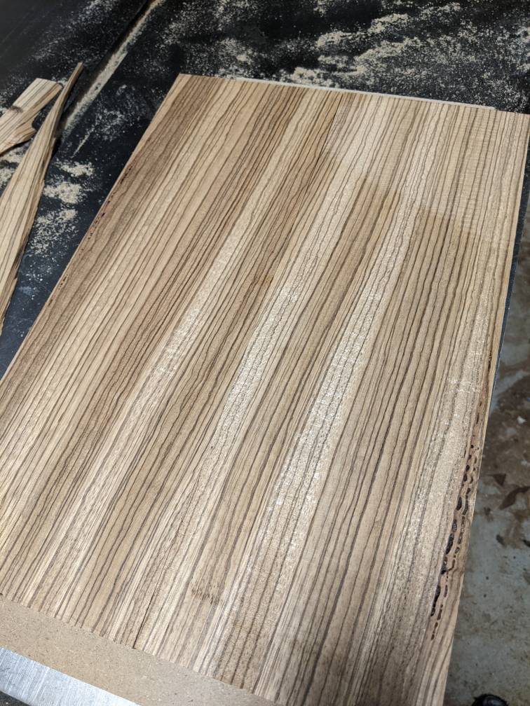

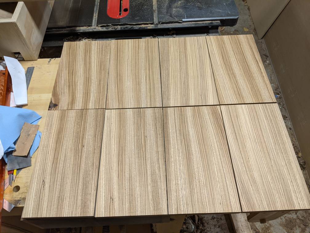

A little more progress, eight boards veneered for the eight BR-1 bookshelf speakers. Same process as before, zebra wood milled and resawn to about 3/8" thick then glued with polyurethane construction adhesive to 5/8" MDF. Boards then brought down to a total 3/4" thickness and cut to just over the final length and width. I was unable to avoid the discolouration defect in one piece, but that can be one of the rears. I do have some spare damaged veneers so I may glue a couple of those onto on other board and process the same way to see if it comes out any better.PXL_20201021_220435572.jpg

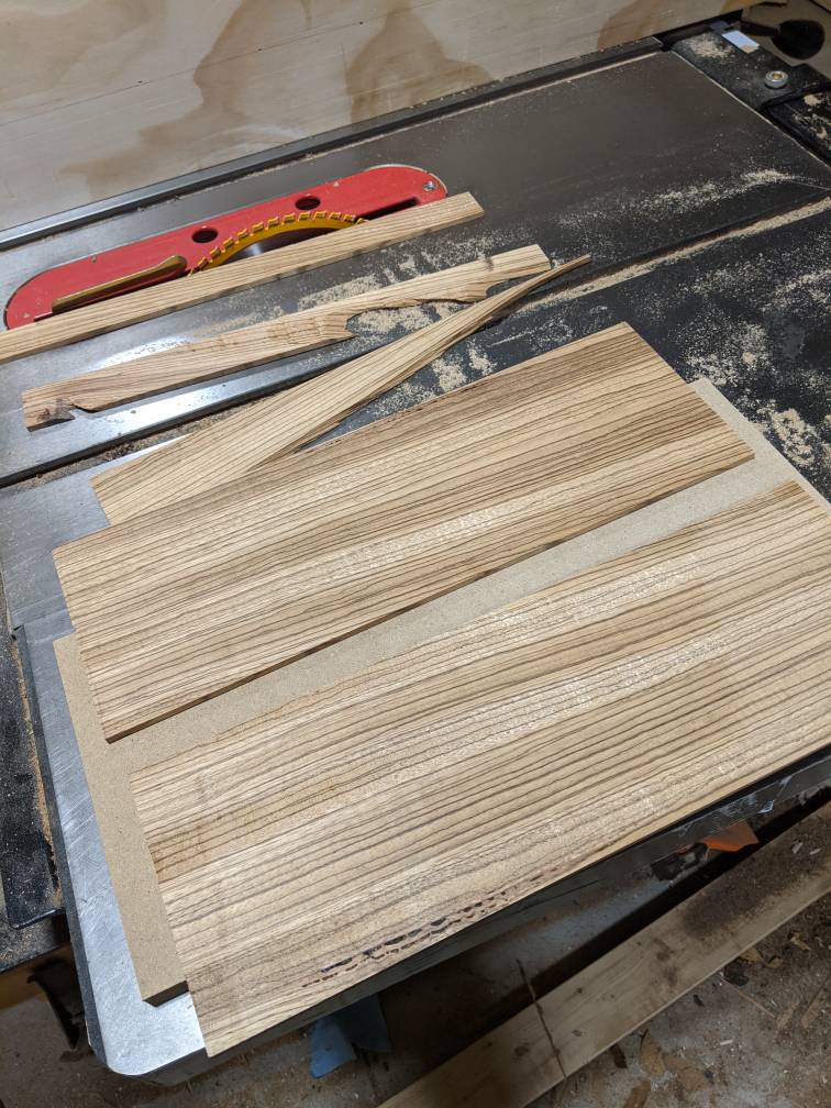

Well I couldn't finish for the day knowing I wasn't happy with that one panel. So I ripped down a couple of scraps which had been broken earlier on the process. Jointed the edges and glued them together on another piece of MDF. With this grain pattern the seam is going to be pretty much invisible.PXL_20201021_222535973.jpgPXL_20201021_222549878.jpgPXL_20201021_224031296.jpg

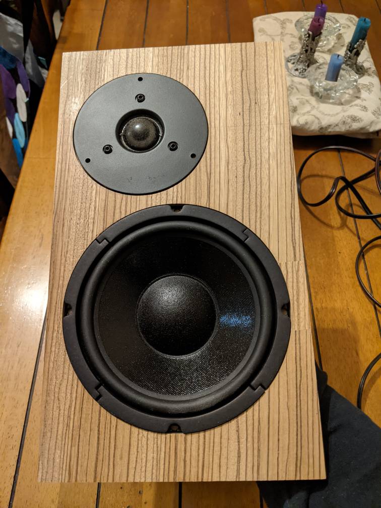

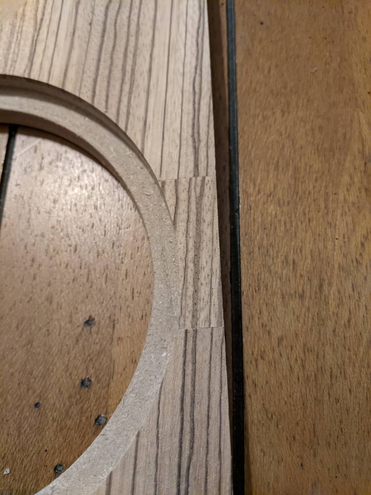

I cut all the front panels today, lots of dust but pretty successful. I did have one problem when the router slipped a little cutting one of the large recesses. I decided to cut out a rectangle and then use a scrap, cut from one of the circles from another panel, to patch it. With this grain pattern I think it will be hardly noticeable.

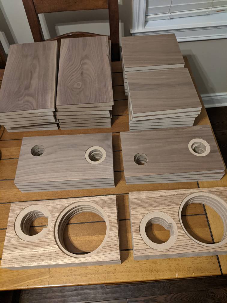

I finally finished veneering and milling all the panels. They are all 1/8" thick veneer on top of 5/8" thick MDF. I still need to make all the solid walnut edging and then start cutting all the mitres. With luck by next week I should have some of the speakers assembled.PXL_20201102_234728115.jpg
