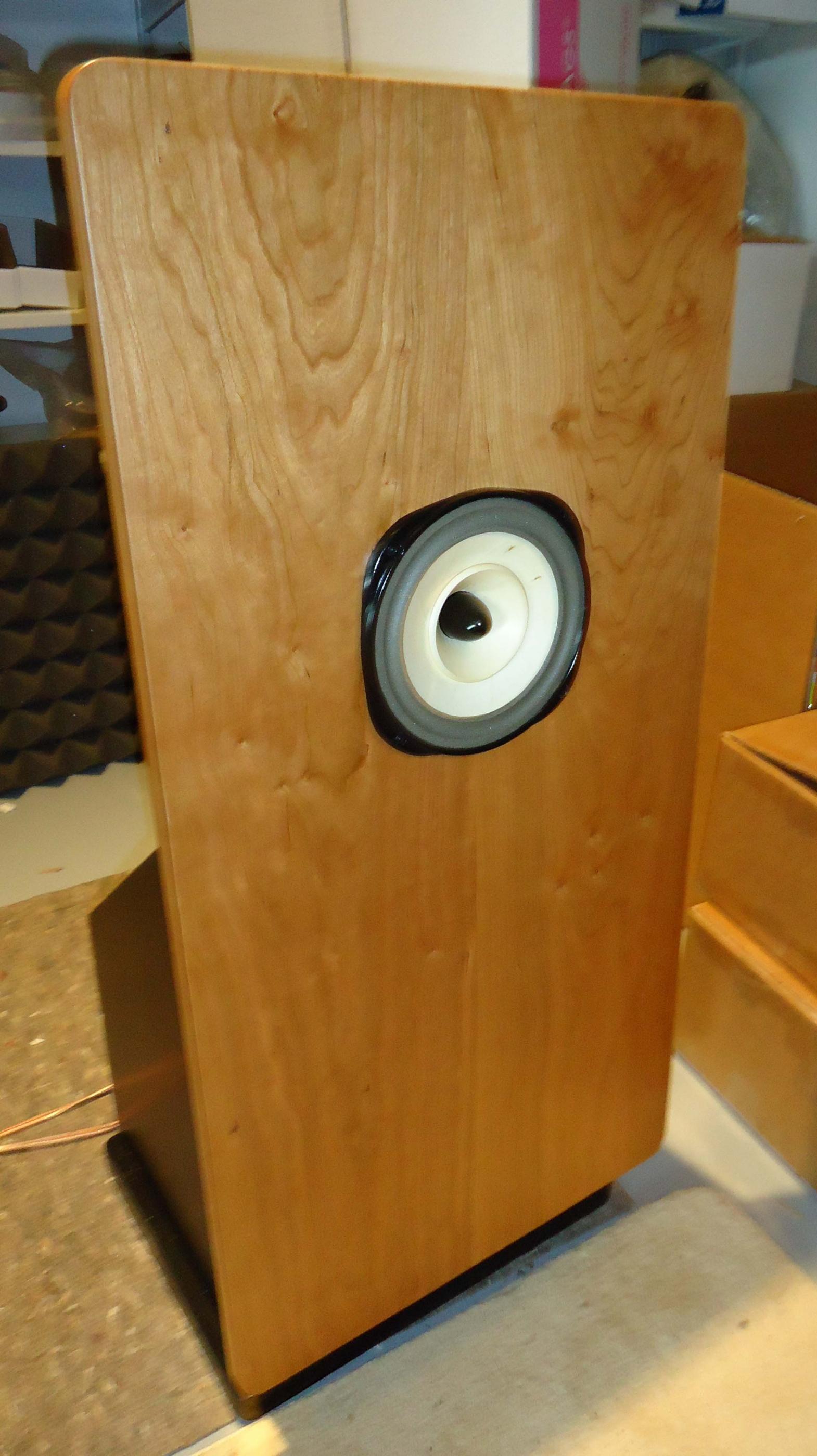

Nelson's latest OB?
Nelson,
I looked for your latest OB design and only found one photo from a rear high 3/4 angle in a magazine write-up. Do you have a link to more information or a couple of photos you can post?
Z
...You might take a look at the OB I showed at the last Burning Amp Festival... 😎
Nelson,
Z

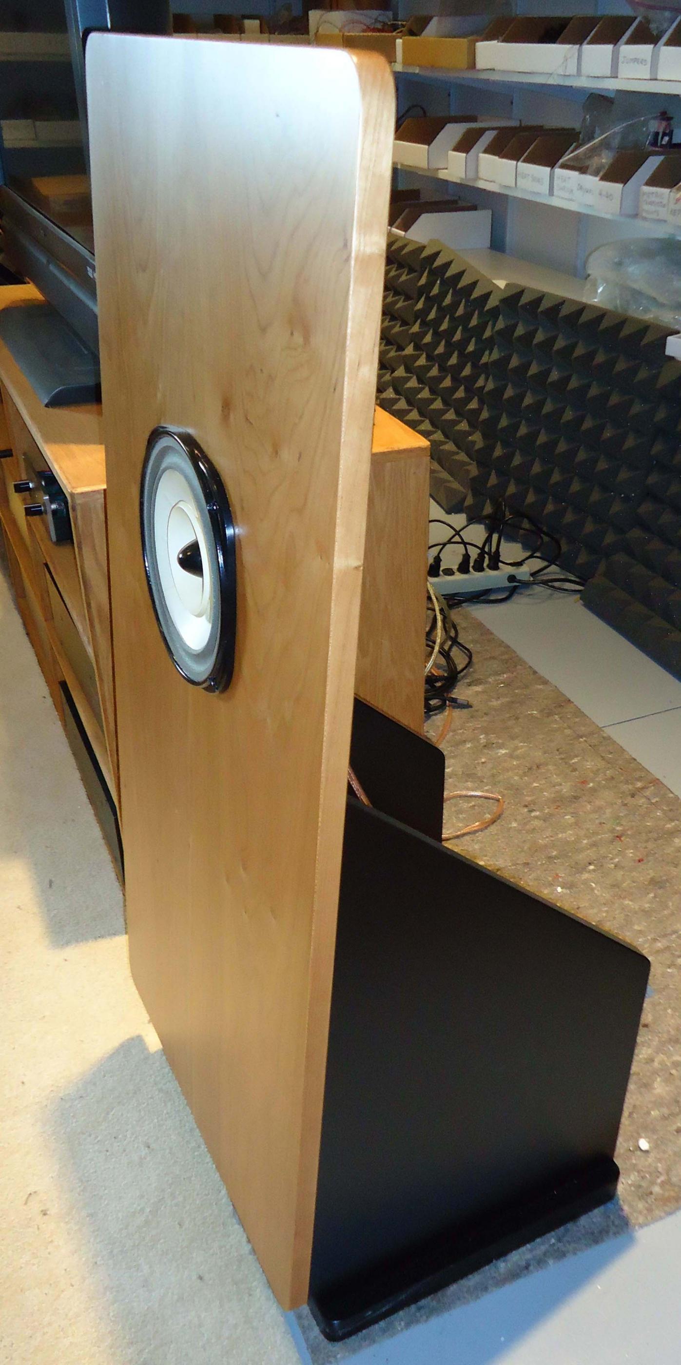

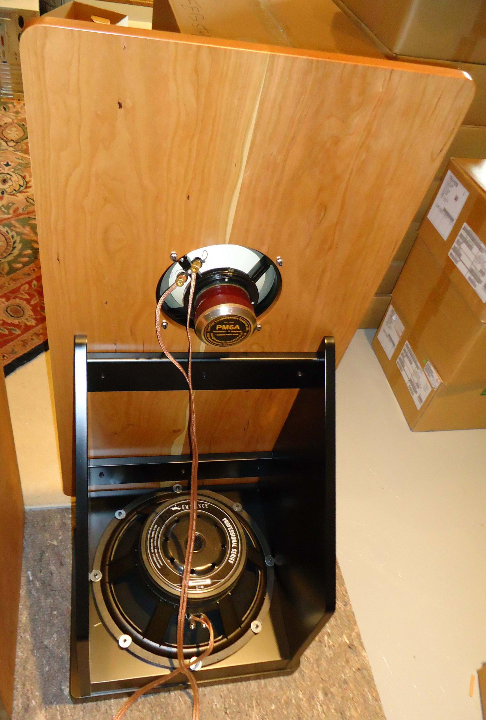

Sorry, here you go. 😎
Nice work, looks like you really upgraded your woodworking!
What was the thought re the horizontal slot at floor level? Was this just to allow a lower profile overall or is there some significant acoustical effect from radiating into pure 1/2 space?
How is this on vibration from the woofer since there is no force canceling?
So many questions???

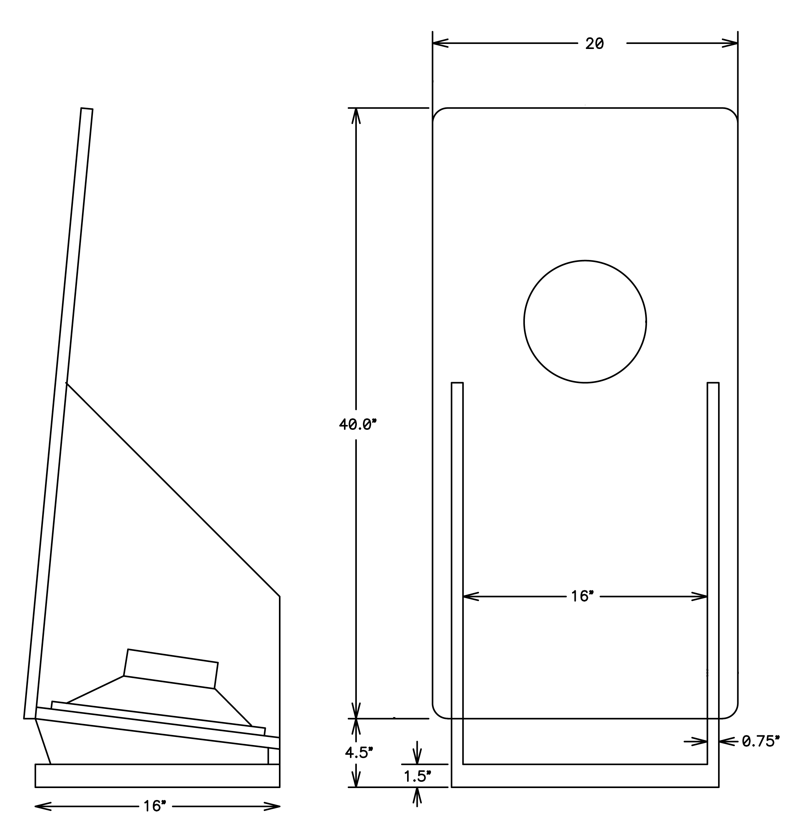

Mr Pass,
This is a very simple and clever design to add floor loading to the woofer: +3dB on the bass for free - bingo! I think the substantial 3/4in thick box and slot and fact it is floor mounted probably really reduce any vibration issues. Your 6 driver slot loaded OB was the inspiration for my cardboard OB ( http://www.diyaudio.com/forums/full-range/249984-cheap-fast-ob-literally.html ) - which works terribly well for using only $40 (6x$5+$10) worth of drivers.

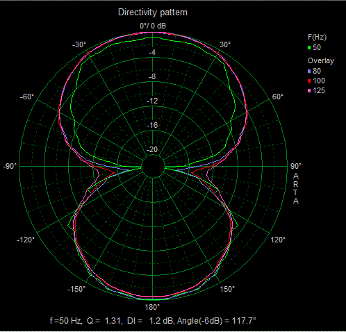

That's a fantastic project.Been building open baffle dipole loudspeakers since 2009. Inspired by Linkwitz, Martin J King and John Kreskovsky, an idea always starts as "I could just make holes in a board and... poof- I would have a OB panel that would look like an electrostatic once a grill was on." Each time the reality was much harder: after a support structure and a box for the bass radiators was designed, it morphed into a much more ambitious project. Then, after countless weekends of woodworking & finishing, each project would end with tendonitis in my elbows and MDF dust in my sinus tract and eyes. (Never had any energy left to finish a grill on any project.) Each time my friends were amazed with the open sound, but the measurements were not as good as I wanted (I keep getting more picky about the directivity). Rinse and repeat.
Woofer Directivity
The various iterations left me with know how concerning cut-outs in the baffle to shape the directivity, constrained layer damping (CLD) to lower baffle vibration and shaping the rear of a U-frame to minimize resonance. My wife was pressing for something smaller (and with less wires!) With my elbows recovered last Spring I tried again. At one point, I had purchased about 80 Aura/ NS6-255-8A woofers for $6 each after finding them to have a surprisingly linear motor. Using these in the slot-loaded OB woofer concept that Nelson Pass had documented in conjunction with a small U-frame, a reasonably small OB concept emerged. The force-canceling of the slot set-up would minimize vibration from the woofers which was always unsettling in previous designs.

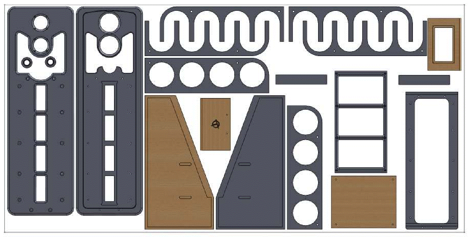

I decided to get all of the parts CNC cut; finishing would be limited to just a spray coat of clear shellac. Then it would be just assembly and wiring- able to be done in just a couple of weekends. The grill would be integrated into the design with fabric stretched over the baffle. Instead of a stack of external amps and a DSP crossover, I would spring for Hypex AS2.100d modules (a DSP crossover and bi-amp plate amp) and integrate them into the speakers.

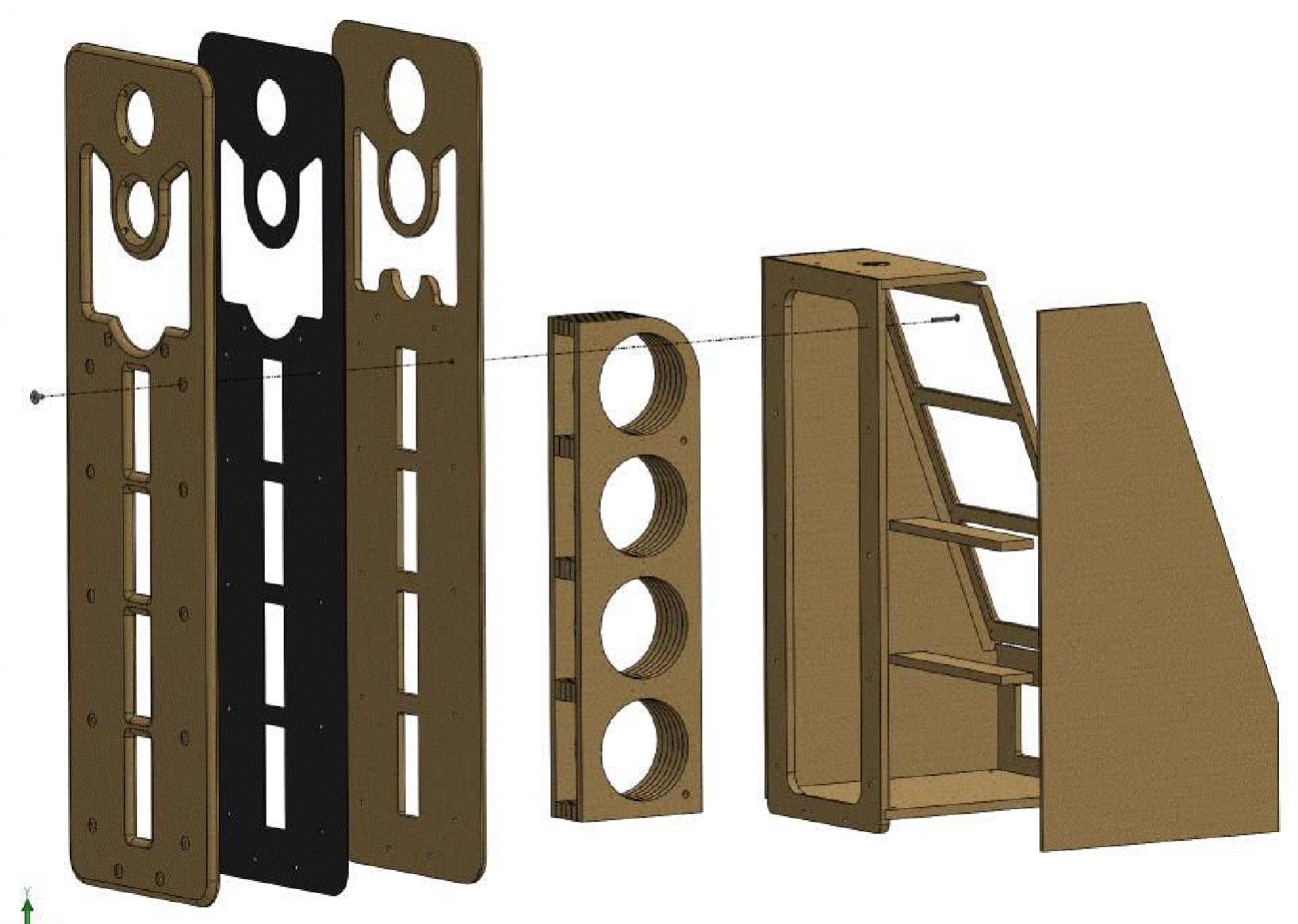

Exploded View
The results were so good, especially with respect to lowering the effort, I thought that others would be interested in how these went together. So here's how it went-
The idea was to get all of the parts for one speaker cut from a single sheet of 1/2 inch MDF. This allows the CNC to cut all from one side in one pass (no need to turn over the pieces and register them for cuts on the backside), so the cutting cost is low. The front baffle is a lamination of two of the 1/2 inch parts sandwiched over a viscoelastic layer to form a 1.06" (27mm) thick baffle. The woofer slot assembly is glued into the baffle. The rear U-frame box bolts on to the baffle/slot assembly and holds the Hypex modules. (See exploded view.)
All from one sheet of MDF
An ME I work with helped me develop the SolidWorks 3D model one Saturday afternoon from sketches. Construction was indeed completed in a couple of weekends, measurement and tuning of the Hypex crossovers was perfected over a few more days. They looked so good in just clear shellac that I still have yet to install the grill fabric- LOL.

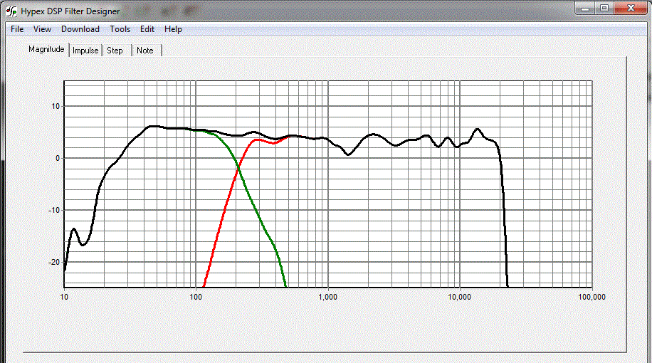

The midrange section is a 1-1/2 way setup using two 3-1/2" Vifa/TC9-FD-18-04 (with a 1.3mH inductor in series with the top one). The tweeter is a Vifa/OX20SC00-04 in a waveguide robbed from a Nuance/TW5-073LR; this combination has very constant directivity above 4kHz but the Vifa mids sounded so good equalized to 20kHz, that I never put in the effort to build the crossover for the tweeter- so right now it's "justfa show". The slot loaded woofer is made using eight NS6-255-8As for a total radiating area (Sd) of 1088sq-cm, about the same area as a 20" woofer!
On Axis Response
The overall results were impressive, especially considering the total cost was under $1,000 for a pair, complete with electronics. The Hypex modules are a bit pricy, but they have analog, SPDIF & USB inputs and dedicated (stereo or mono) subwoofer outputs (if you really NEED that last bottom octave). And you can switch inputs and control volume with an IR remote. The system is a complete stereo without the rack. My son uses his iPod as a source, I listen using my laptop as the source.
MF-HF Directivity
I will let the data speak for itself, but everyone who has heard them has been impressed with the rock solid imaging and tonal balance. I was slightly disappointed with a "shoulder" in the directivity plot around 1.3kHz, but overall it's very good. Response is +/-2dB from 35-20kHz on axis except for a 3.5dB dip around 1.3kHz that's on purpose. The true standout though, is the bass; the directivity is an almost perfect dipole as the outdoor measurements below show (un-gated, 2m ground bounce). A double bass, cello or a kick drum sounds like it's in the room, really. The speakers don't get at all muddy if you want to listen to Slipknot (which I don't). Toms hit you in the chest. You can feel no bass vibration in the baffle, the woofer force-canceling really works. Mid frequency vibration in the baffle is very low, the damping layer works.

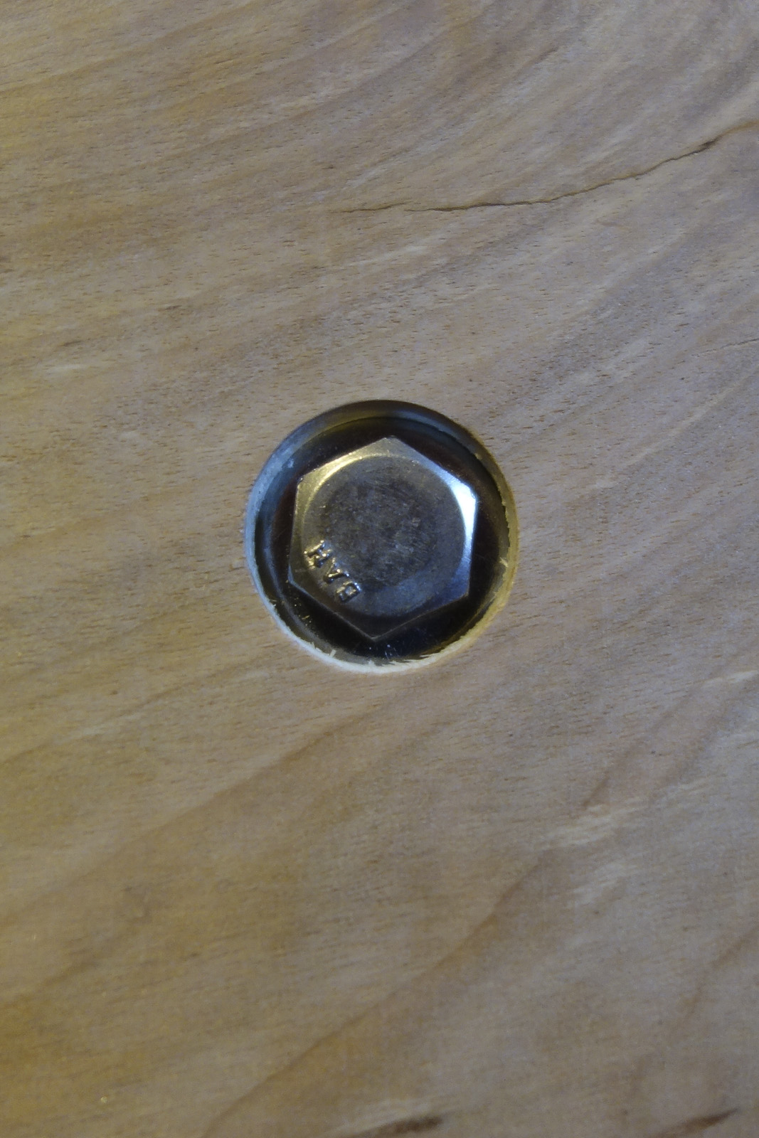

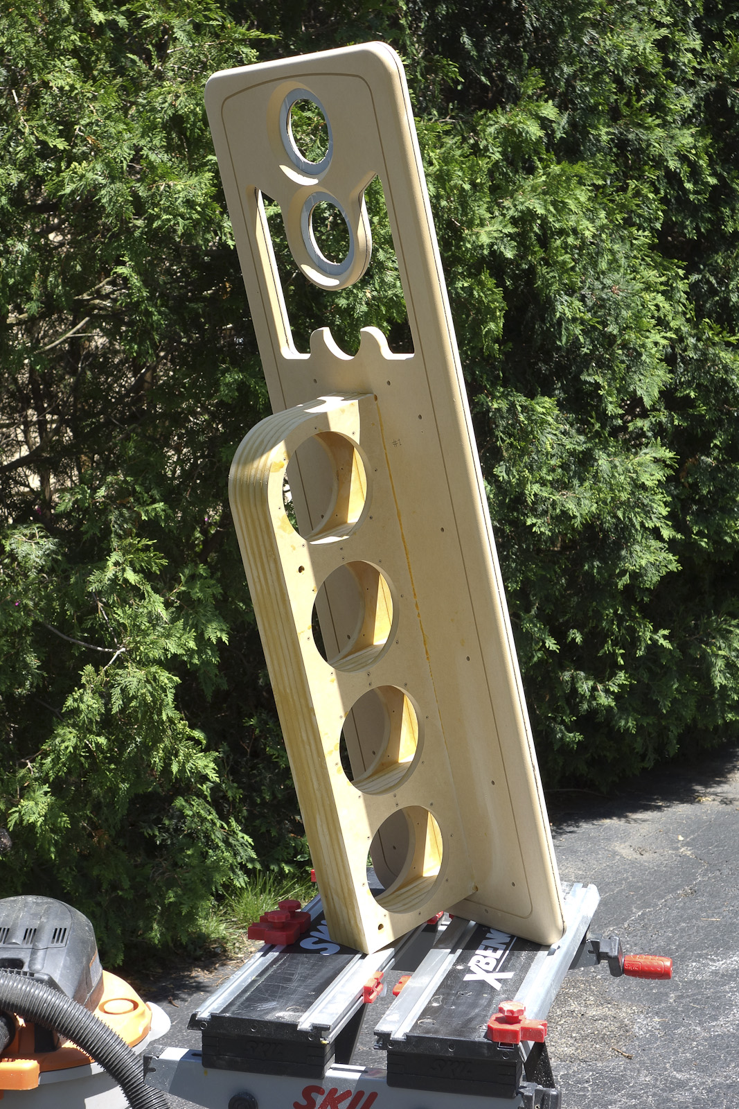

Baffle before shellac & drivers.
Notice black line on the edge- it's the damping layer.
What do you think it is?
As for the construction- I am never going to cut another board again unless it's for a test baffle. Everything fit perfect and tooling holes made the alignment of the parts during gluing a breeze. The damping layer was a bit of a challenge to trim, but still easy in the light of past projects.

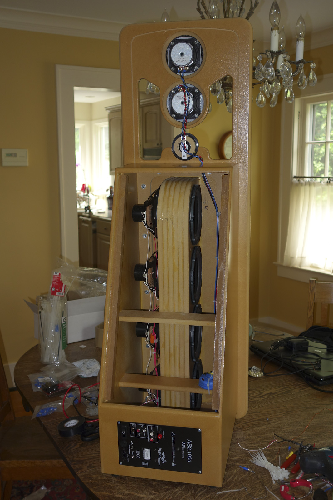

Done in two weekends- ready to tune.
Looking forward to comments. I have more data/pictures.

Do the cut outs around your mid/ high frequency drivers help with imaging?
Or is this to assist dipole cancellations, or both?
Appreciate the compliments, as you have read, it was more about avoiding effort and annoyance that it was about craftsmanship- but the end result was good.
With respect to the cut-outs, I have been trying different cut-outs in baffles since I started in 2009. Sometimes with good results, sometimes just OK. The idea is to have uniform (dipole) cancellation with frequency which increases the direct amplitude relative to the reflected power- this increases imaging (given good source material). The reflection from the wall behind the speaker is strong-ish, but it's delayed enough to be perceived as ambiance and not a smeared image. Having the baffle cut out underneath the mid range specifically helps reduce ground bounce.
In this example you can see from the data, that the directivity vs frequency is pretty good, much better than a typical two-way. Some test baffles have done better, but for this effort I just guessed on the cut-outs, in keeping with my low-effort mantra for this pair.

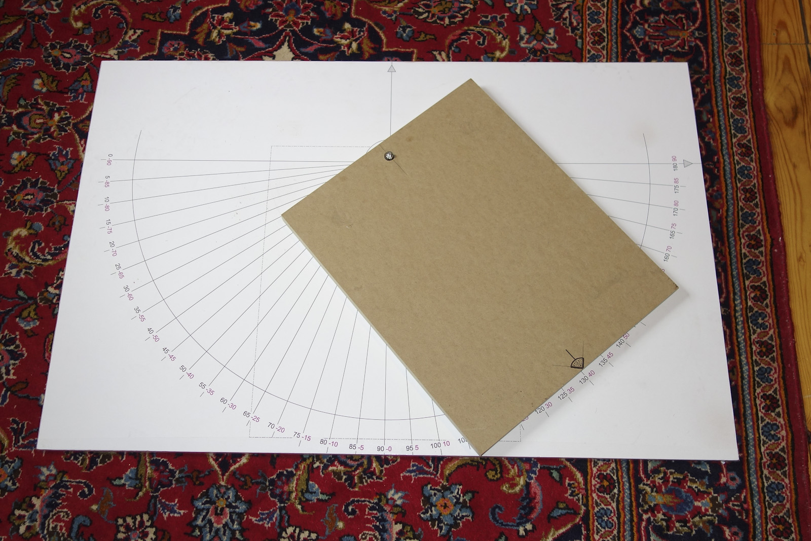

Poor man's turntable
A couple of people have asked me about the turntable used to perform horizontal polar measurements. Below are details of the turntable I whipped up. This saved me a lot of time. What I used to do before was move the speaker around on a piece of paper with angles marked on it. But that was problematic, time consuming and especially difficult when I used a raised platform like a stool or stand to hold the speaker.
I wanted something low profile so it would not disturb ground plane measurements, when I made them. Doesn't get much lower profile than this:
The Completed Manual Turntable
The design is nothing special, but it was very fast to make and used only a 24" x 36" piece of 1/2 inch birch plywood and a 14" x 17" platform of 3/4 inch MDF and a single 5/16" bolt+nut. It's very effective and easy to transport to outdoor sites.

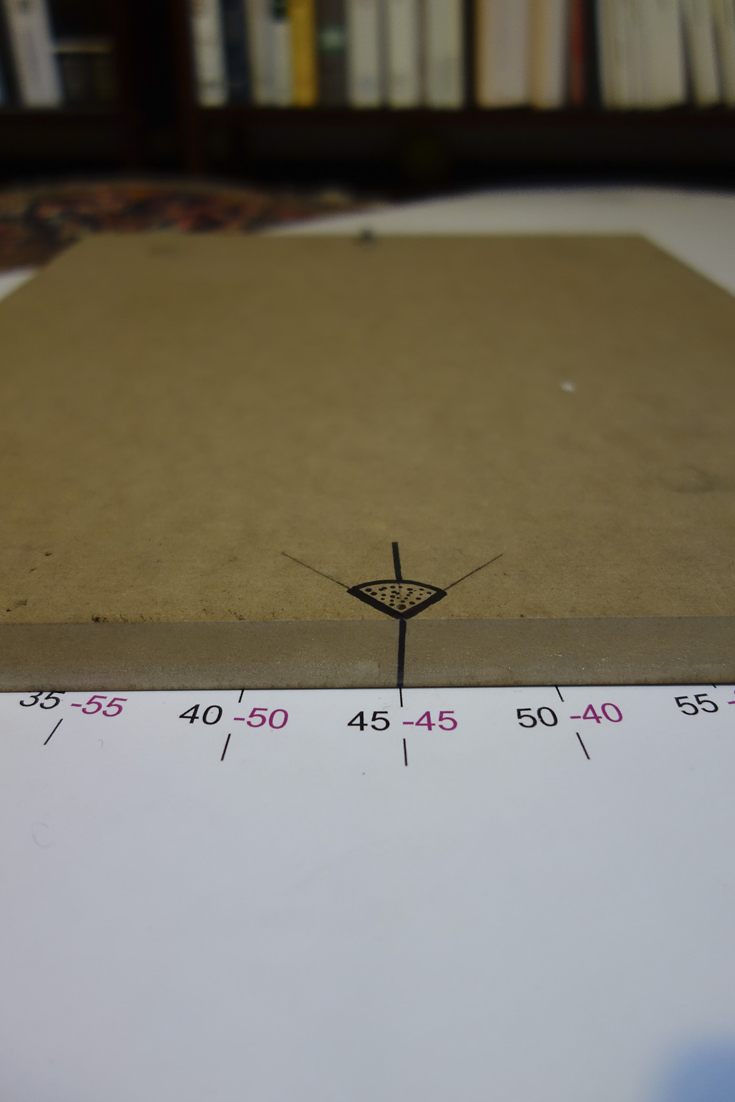

Easy to Set the Angle
This is how you make one:
1. Cut the plywood rectangle and the MDF rectangle. (You can get this done at a home center like Home Depot if you don't have a table saw.)
2. Draw and print a protractor pattern on a an ANSI E size sheet (34" x 44") with a medium format printer. (You can get this printed at your local Kinko's, etc. if you don't have access to a plotter.) The pattern I used was designed to work from 0-180 degrees (black numbers) or +90 to -90 degrees (red numbers).
3. Use the print to mark the hole in each piece. Pilot drill, counter bore to the diameter of the washers so the hardware will be flush or below the surface, then drill the hole for the bolt.

4. Draw a line in the center of the MDF rectangle as shown in the photo.
5. Adhere the printed sheet to the plywood with light duty spray adhesive.
6. Install the stainless steel 5/16" bolt as a pivot, with washers and a nylon-insert lock-nut.
7. Apply a coat of paste wax on the back of the platform (the side that slides against the printed sheet) this leaves it with just the right amount of friction. It moves easily under load, but won't overshoot past the mark.
-Finished.
Even though the platform is only 14" wide I have used it with speakers up to 20" wide and it works well with a stool or a speaker stand. The pivot is not forever, but for the hobbyist, it should last for years.
