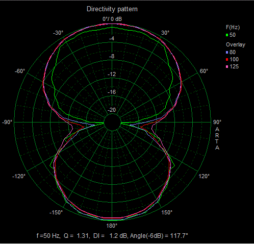

Been building open baffle dipole loudspeakers since 2009. Inspired by Linkwitz, Martin J King and John Kreskovsky, an idea always starts as "I could just make holes in a board and... poof- I would have a OB panel that would look like an electrostatic once a grill was on." Each time the reality was much harder: after a support structure and a box for the bass radiators was designed, it morphed into a much more ambitious project. Then, after countless weekends of woodworking & finishing, each project would end with tendonitis in my elbows and MDF dust in my sinus tract and eyes. (Never had any energy left to finish a grill on any project.) Each time my friends were amazed with the open sound, but the measurements were not as good as I wanted (I keep getting more picky about the directivity). Rinse and repeat.
Woofer Directivity

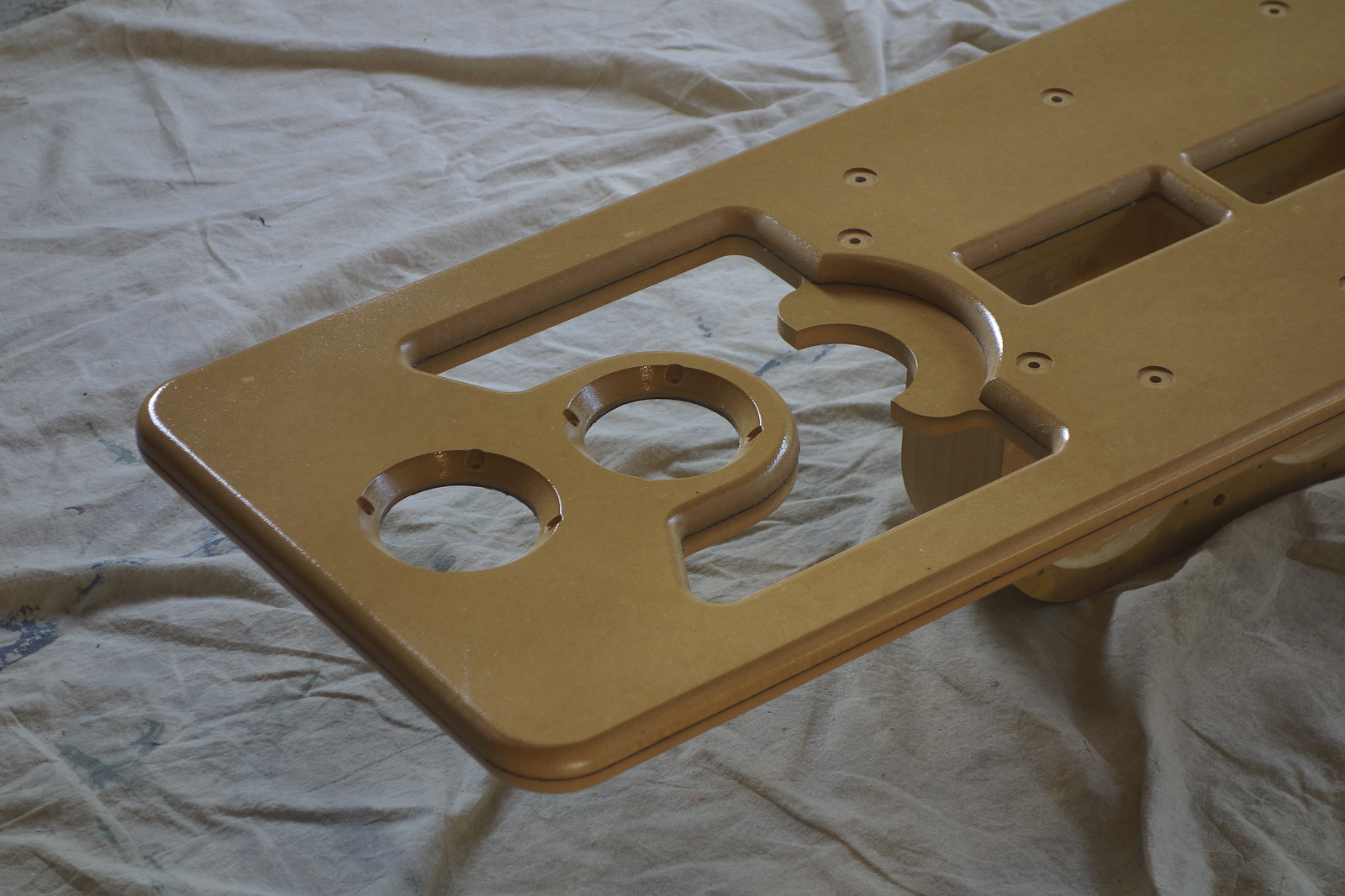

The various iterations left me with know how concerning cut-outs in the baffle to shape the directivity, constrained layer damping (CLD) to lower baffle vibration and shaping the rear of a U-frame to minimize resonance. My wife was pressing for something smaller (and with less wires!) With my elbows recovered last Spring I tried again. At one point, I had purchased about 80 Aura/ NS6-255-8A woofers for $6 each after finding them to have a surprisingly linear motor. Using these in the slot-loaded OB woofer concept that Nelson Pass had documented in conjunction with a small U-frame, a reasonably small OB concept emerged. The force-canceling of the slot set-up would minimize vibration from the woofers which was always unsettling in previous designs.

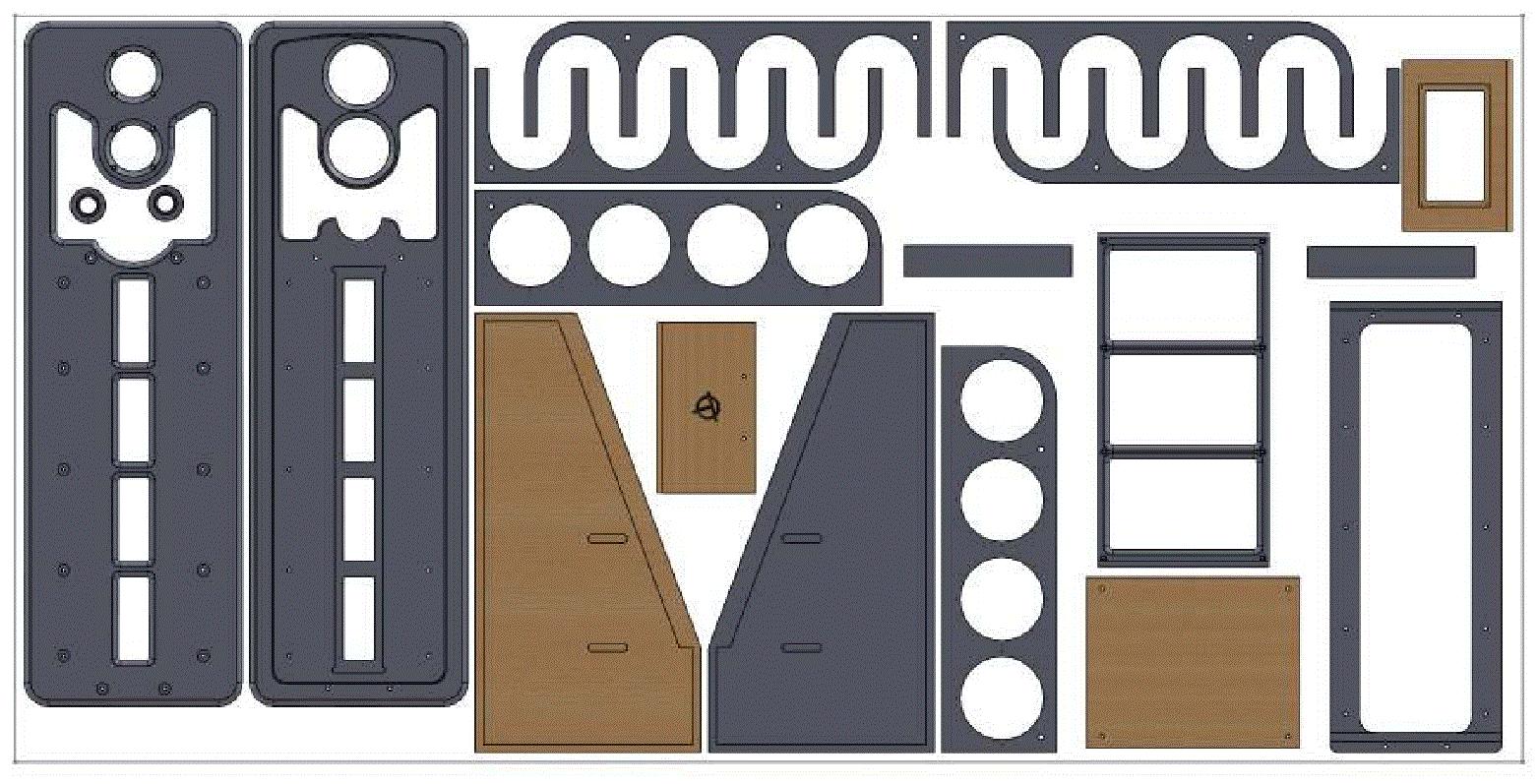

I decided to get all of the parts CNC cut; finishing would be limited to just a spray coat of clear shellac. Then it would be just assembly and wiring- able to be done in just a couple of weekends. The grill would be integrated into the design with fabric stretched over the baffle. Instead of a stack of external amps and a DSP crossover, I would spring for Hypex AS2.100d modules (a DSP crossover and bi-amp plate amp) and integrate them into the speakers.

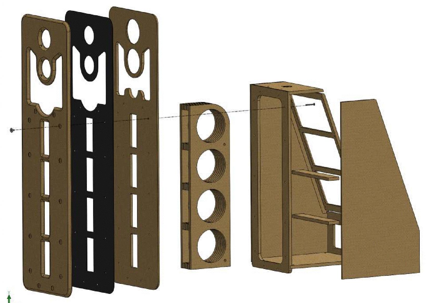

Exploded View

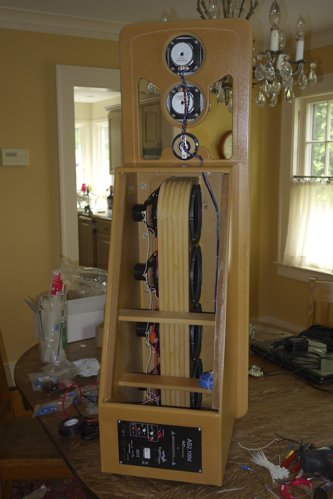

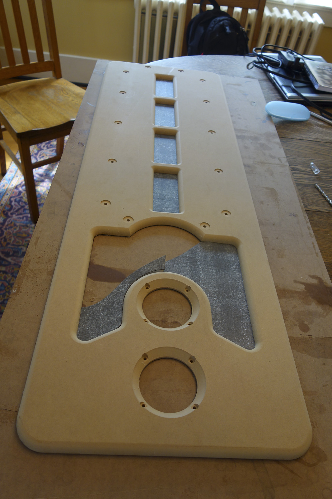

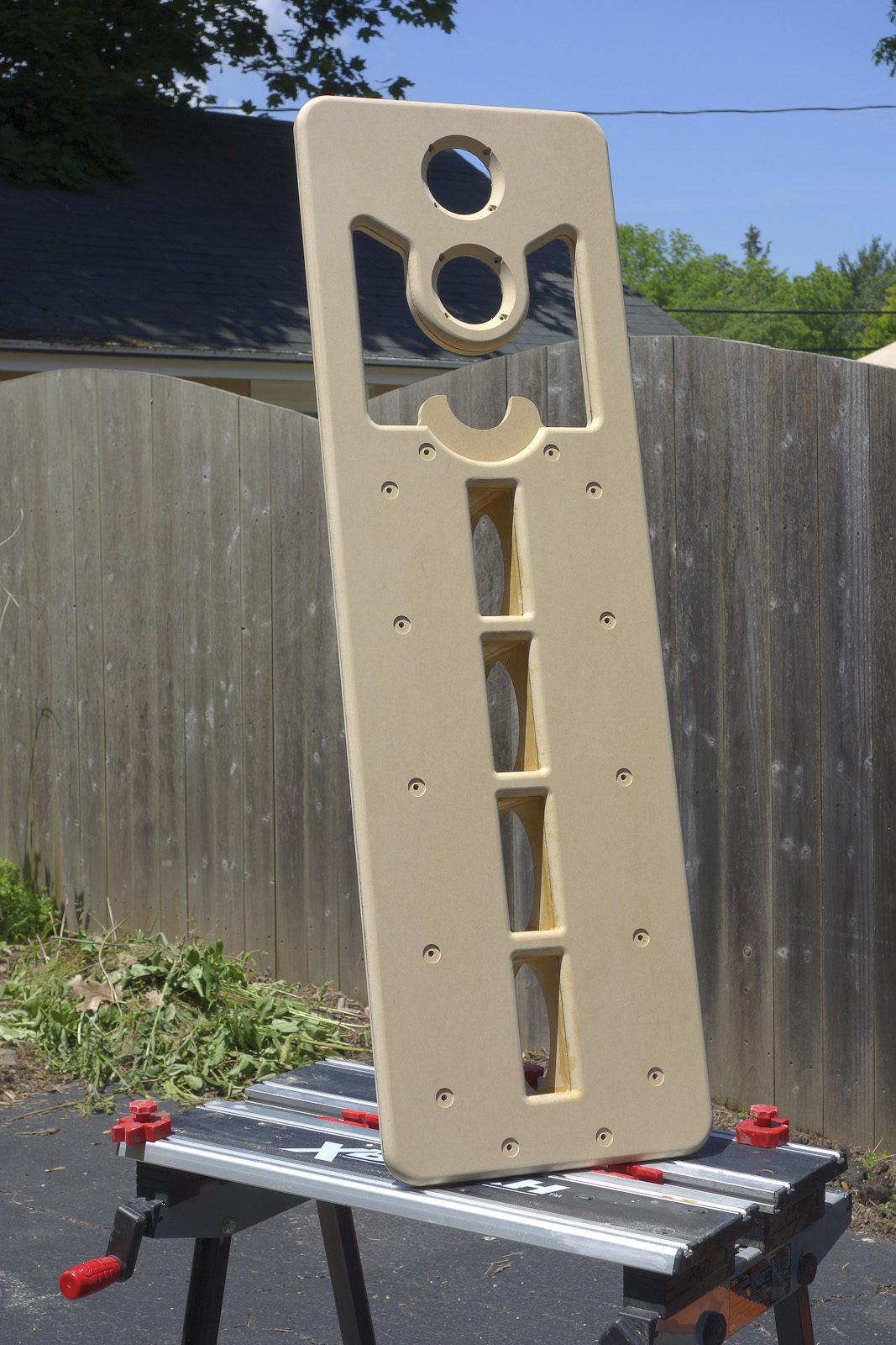

The results were so good, especially with respect to lowering the effort, I thought that others would be interested in how these went together. So here's how it went-
The idea was to get all of the parts for one speaker cut from a single sheet of 1/2 inch MDF. This allows the CNC to cut all from one side in one pass (no need to turn over the pieces and register them for cuts on the backside), so the cutting cost is low. The front baffle is a lamination of two of the 1/2 inch parts sandwiched over a viscoelastic layer to form a 1.06" (27mm) thick baffle. The woofer slot assembly is glued into the baffle. The rear U-frame box bolts on to the baffle/slot assembly and holds the Hypex modules. (See exploded view.)
All from one sheet of MDF
An ME I work with helped me develop the SolidWorks 3D model one Saturday afternoon from sketches. Construction was indeed completed in a couple of weekends, measurement and tuning of the Hypex crossovers was perfected over a few more days. They looked so good in just clear shellac that I still have yet to install the grill fabric- LOL.

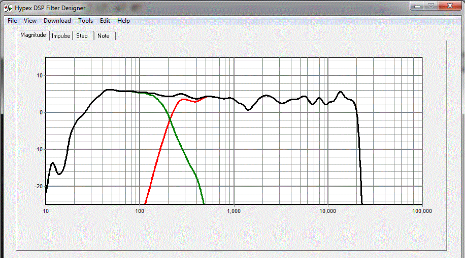

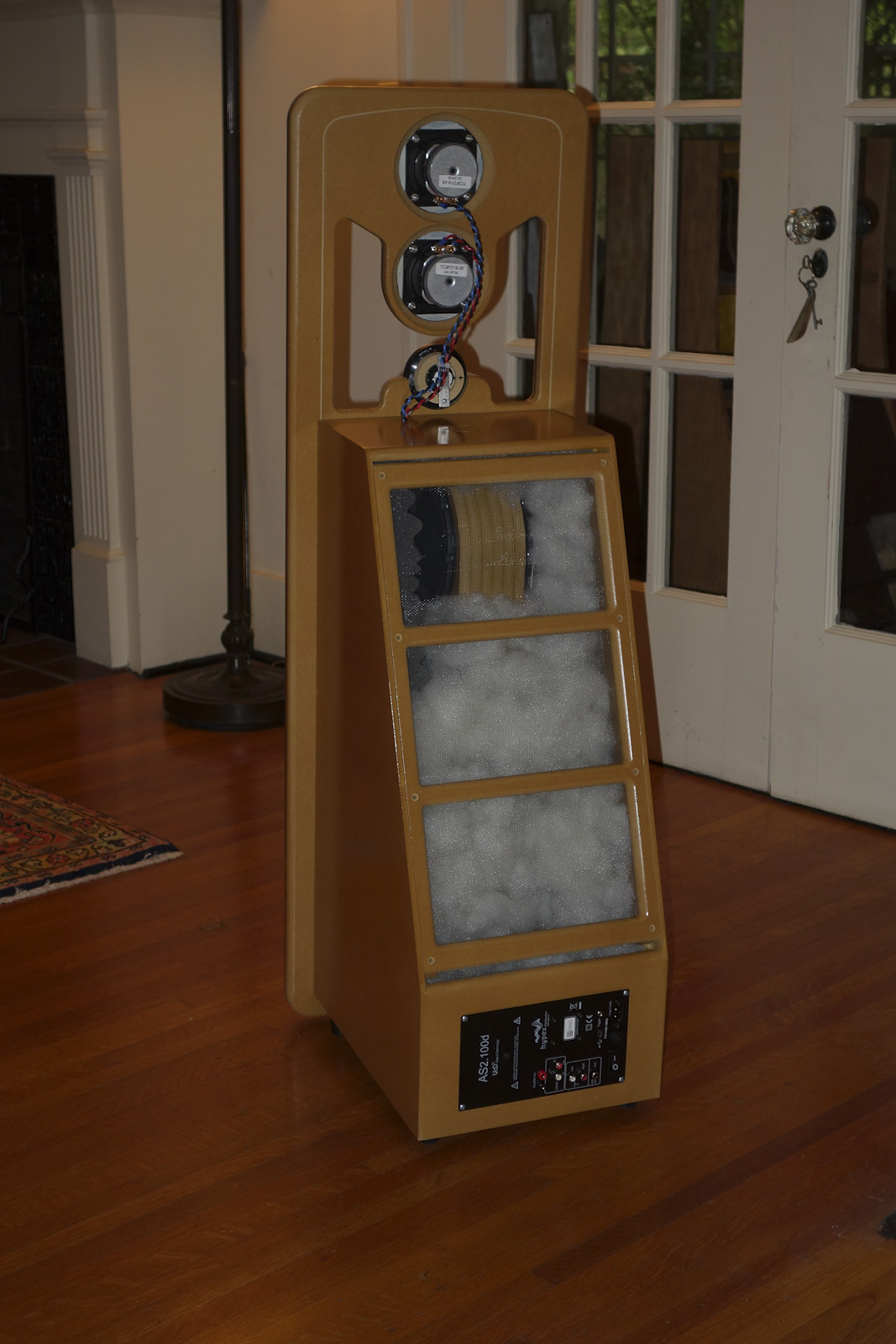

The midrange section is a 1-1/2 way setup using two 3-1/2" Vifa/TC9-FD-18-04 (with a 1.3mH inductor in series with the top one). The tweeter is a Vifa/OX20SC00-04 in a waveguide robbed from a Nuance/TW5-073LR; this combination has very constant directivity above 4kHz but the Vifa mids sounded so good equalized to 20kHz, that I never put in the effort to build the crossover for the tweeter- so right now it's "justfa show". The slot loaded woofer is made using eight NS6-255-8As for a total radiating area (Sd) of 1088sq-cm, about the same area as a 20" woofer!
On Axis Response

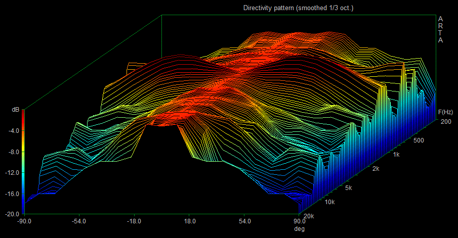

The overall results were impressive, especially considering the total cost was under $1,000 for a pair, complete with electronics. The Hypex modules are a bit pricy, but they have analog, SPDIF & USB inputs and dedicated (stereo or mono) subwoofer outputs (if you really NEED that last bottom octave). And you can switch inputs and control volume with an IR remote. The system is a complete stereo without the rack. My son uses his iPod as a source, I listen using my laptop as the source.
MF-HF Directivity
I will let the data speak for itself, but everyone who has heard them has been impressed with the rock solid imaging and tonal balance. I was slightly disappointed with a "shoulder" in the directivity plot around 1.3kHz, but overall it's very good. Response is +/-2dB from 35-20kHz on axis except for a 3.5dB dip around 1.3kHz that's on purpose. The true standout though, is the bass; the directivity is an almost perfect dipole as the outdoor measurements below show (un-gated, 2m ground bounce). A double bass, cello or a kick drum sounds like it's in the room, really. The speakers don't get at all muddy if you want to listen to Slipknot (which I don't). Toms hit you in the chest. You can feel no bass vibration in the baffle, the woofer force-canceling really works. Mid frequency vibration in the baffle is very low, the damping layer works.

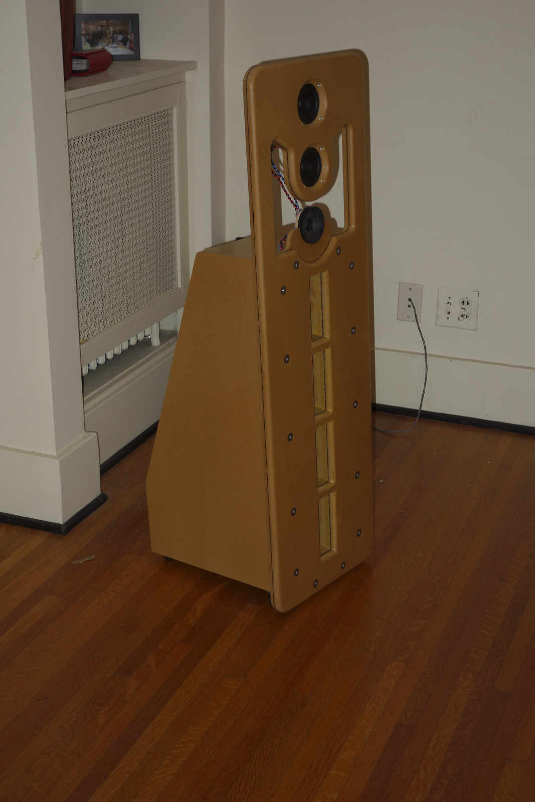

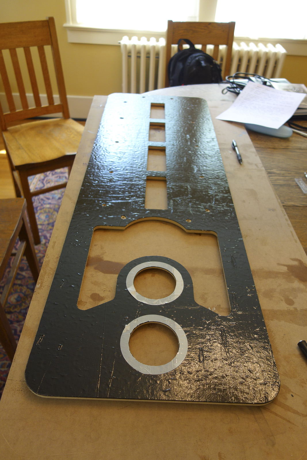

Baffle before shellac & drivers.
Notice black line on the edge- it's the damping layer.
What do you think it is?
As for the construction- I am never going to cut another board again unless it's for a test baffle. Everything fit perfect and tooling holes made the alignment of the parts during gluing a breeze. The damping layer was a bit of a challenge to trim, but still easy in the light of past projects.
Done in two weekends- ready to tune.

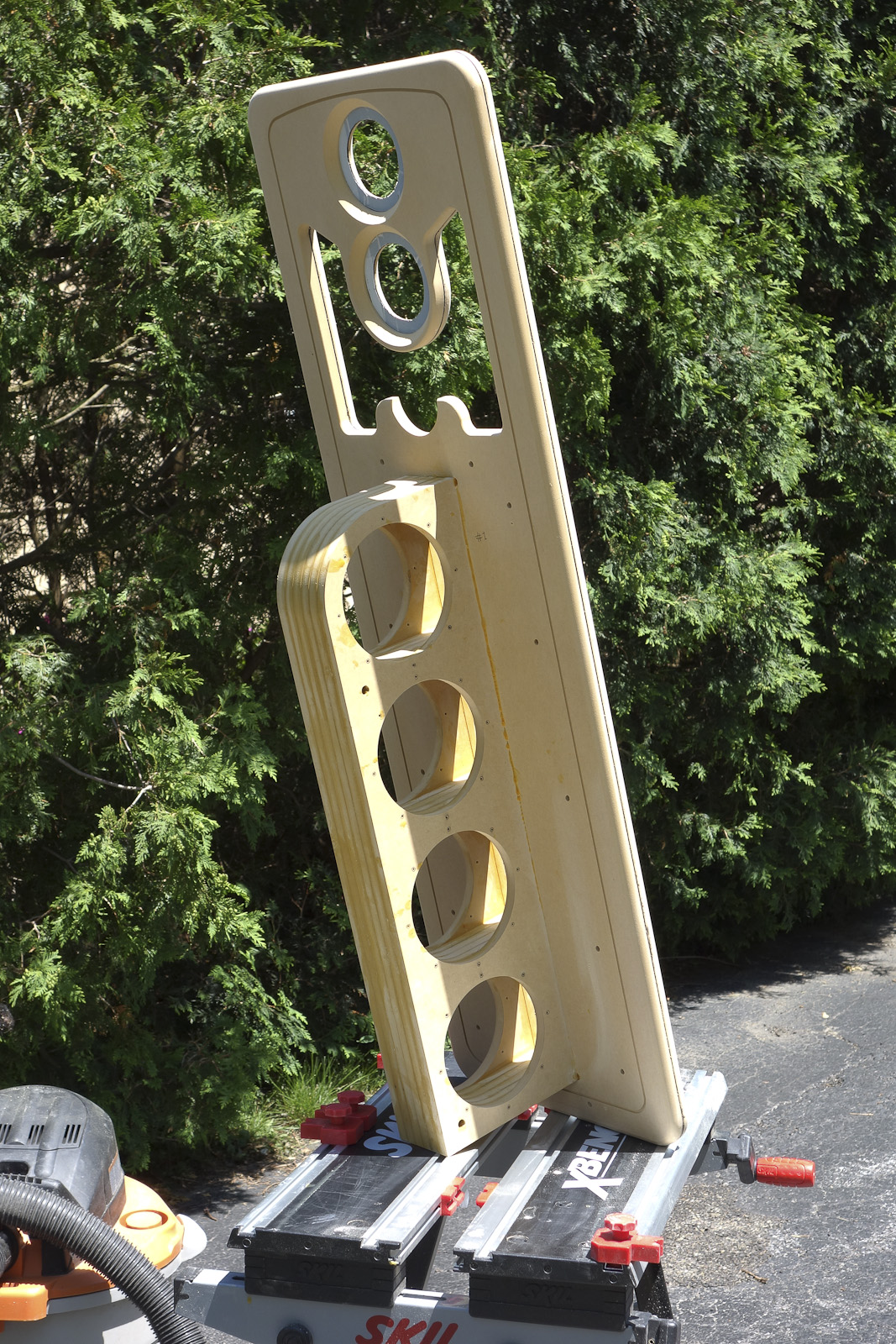

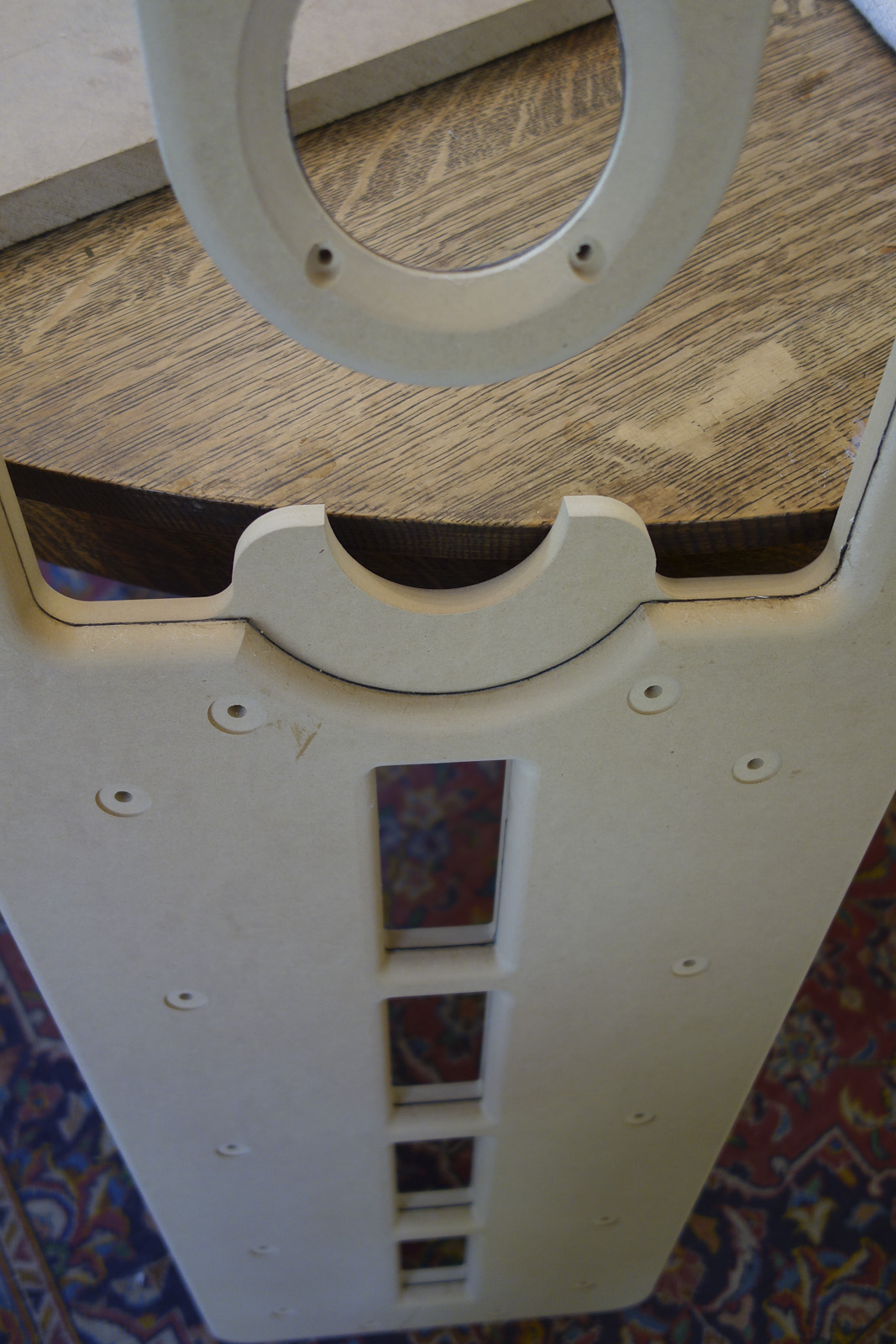

How to make the constrained layer damped baffle.
I can't believe no one has asked about the specifics of the damping layer in the baffle. Here is how the baffle is put together:
The damping sheet is roofing "ice shield" commonly used here in the Northeast to stop water from backing up underneath shingles and leaking in the winter. It's made from a combination of slag, asphalt and binders with an aggressive pressure sensitive adhesive (PSA) on one side and a thin plastic "foil" on the other. It's heavy and just a little gooey- and completely dead. A roll big enough for all the hobby speakers you ever want to build costs $75.
I compared this ice shield side by side with 30# roofing felt in various constructions. (The roofing felt was recommended by Vance Dickenson in "The Loudspeaker Design Cookbook".) The ice shield definitely provides better damping and is easier to use overall. (Both of these materials don't like being routed after assembly- they make a gooey mess of a router bit and the workpiece.)
So, first you use spray adhesive to adhere the non (PSA) side of the ice shield to the front of the baffle and trim with a knife:
Then you remove the PSA backer:

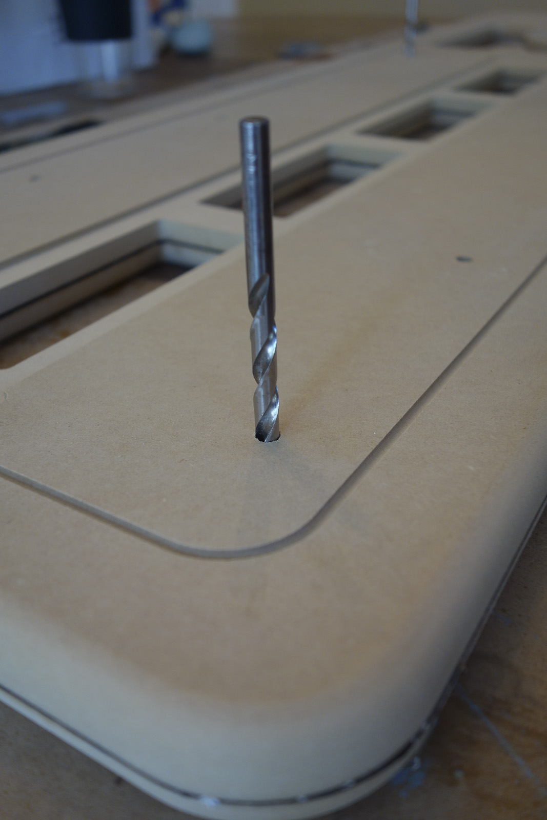

Finally you use registration pins (drill bits) in the tooling holes to make sure the baffle is aligned during assembly and place the back of the baffle on the stack:

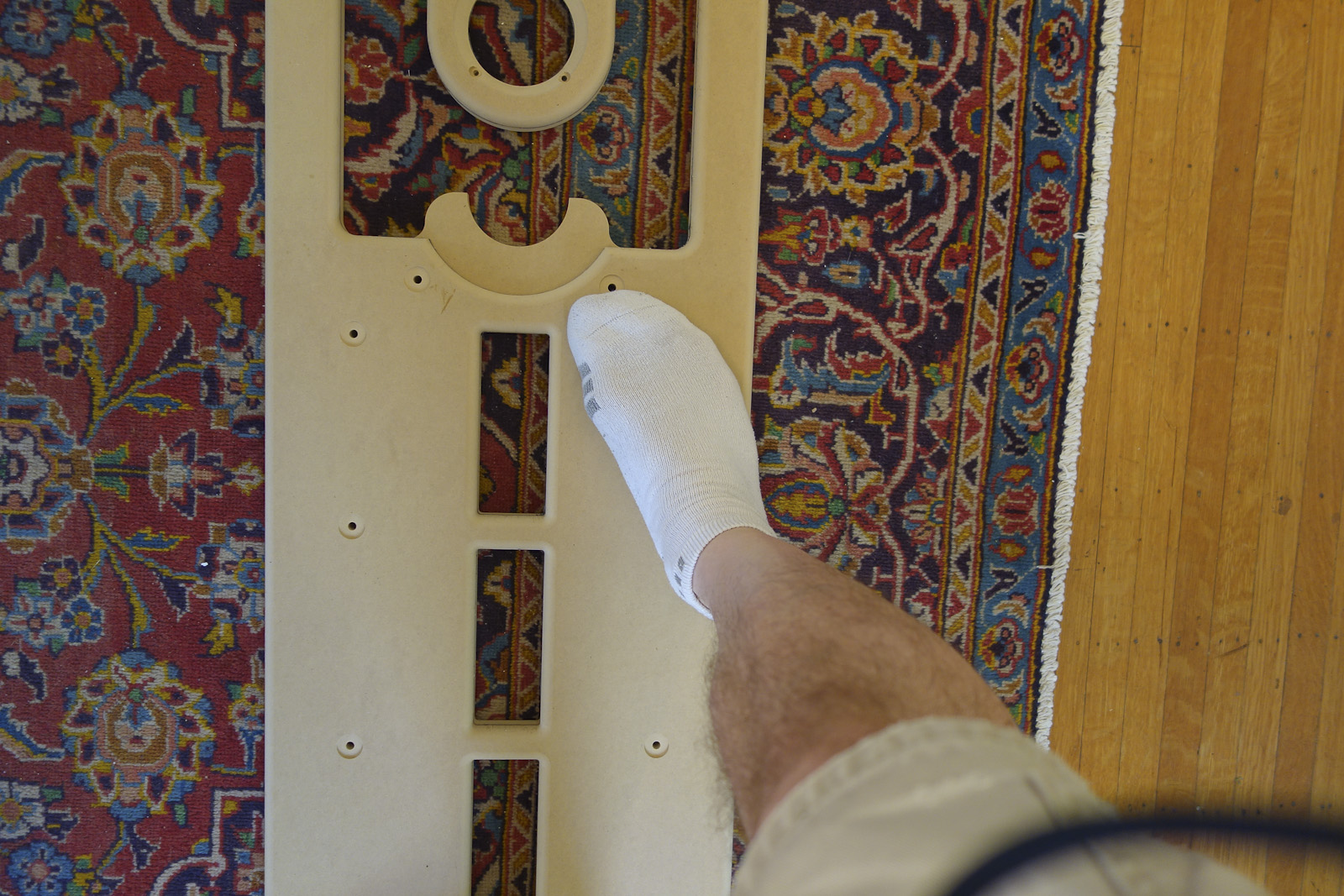

Apply pressure (photographer's foot):

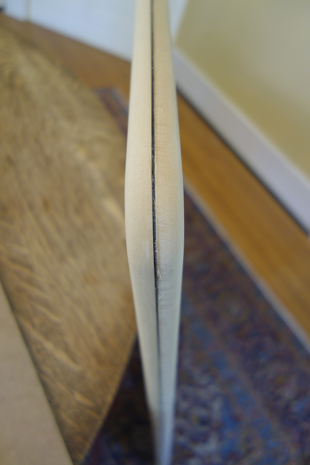

Here you can see the sandwich up close:

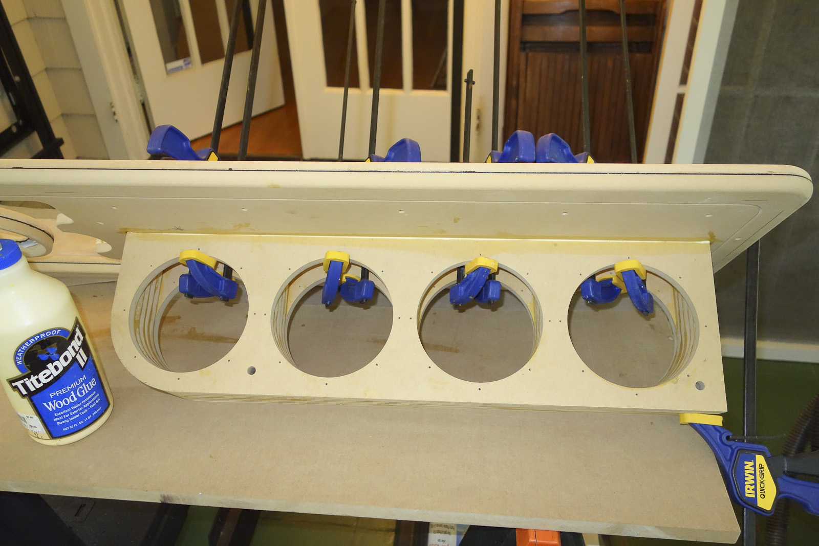

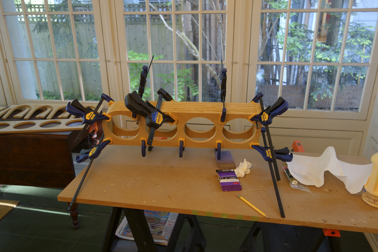

Then glue together the woofer slot assembly (notice the registration pins again):
And glue the slot assembly to the rear baffle half:
To end up with the completed baffle:
As an added benefit, because of the sandwich construction, you end up with cut features (round-overs, bevels, counter-bores, etc.) on both sides of the baffle even though you only paid to have CNC cutting done on one side of a sheet. Not too shabby :D.
I wish I could convey how a knuckle whack sounds like a "thud" instead of a "knock" when you strike the baffle, but it really works well. Between this solid, damped construction and the woofer force canceling, you can't feel any woofer vibrations in the panel. Baffle vibrations from the mid-range drivers are muted too.

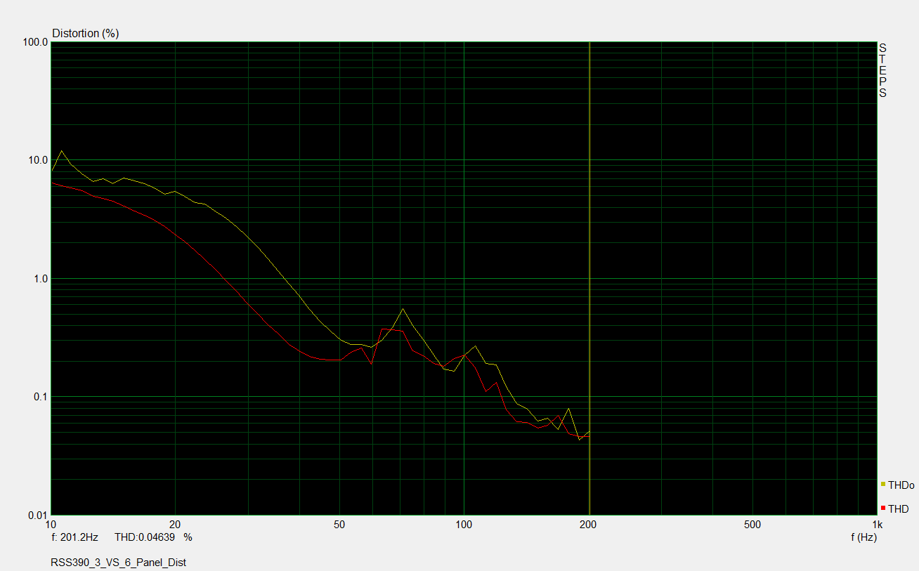

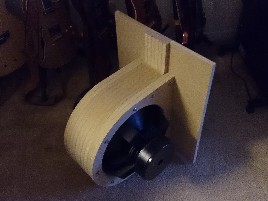

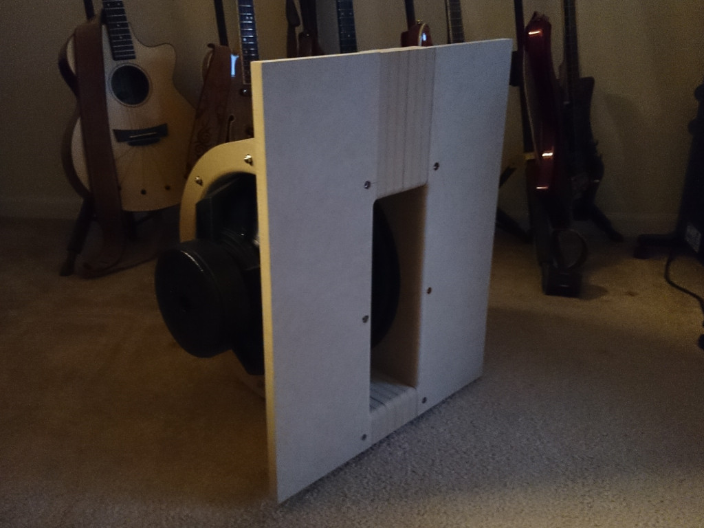

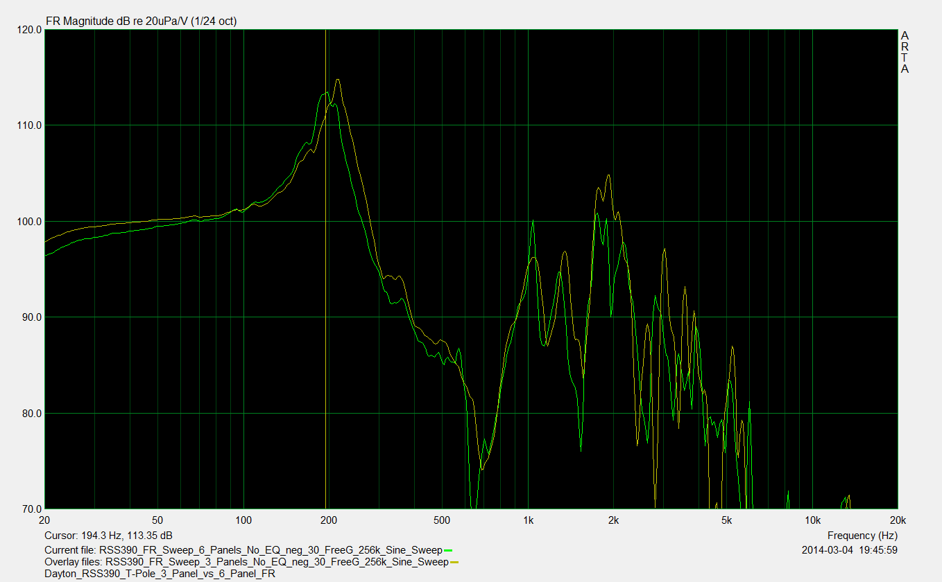

I was inspired by Linkwitz and the Nelson Pass slot loaded speakers as well. This is part of the my speaker, just the sub woofer section to test the slot width. The baffle will extend up for the bass, midrange and tweeter. One thing I can say is the Dayton RSS390 is a beast.

You are going to have a 1/4 wave resonance at about 220Hz from the slot depth. Are you planning to use this sub above 100Hz?
Fortunately the guitars are safe, the enclosure was just setup there for initial testing ;). The sub will only be used up to ~75Hz. 220Hz is a good guess, the resonance is at 194Hz:
