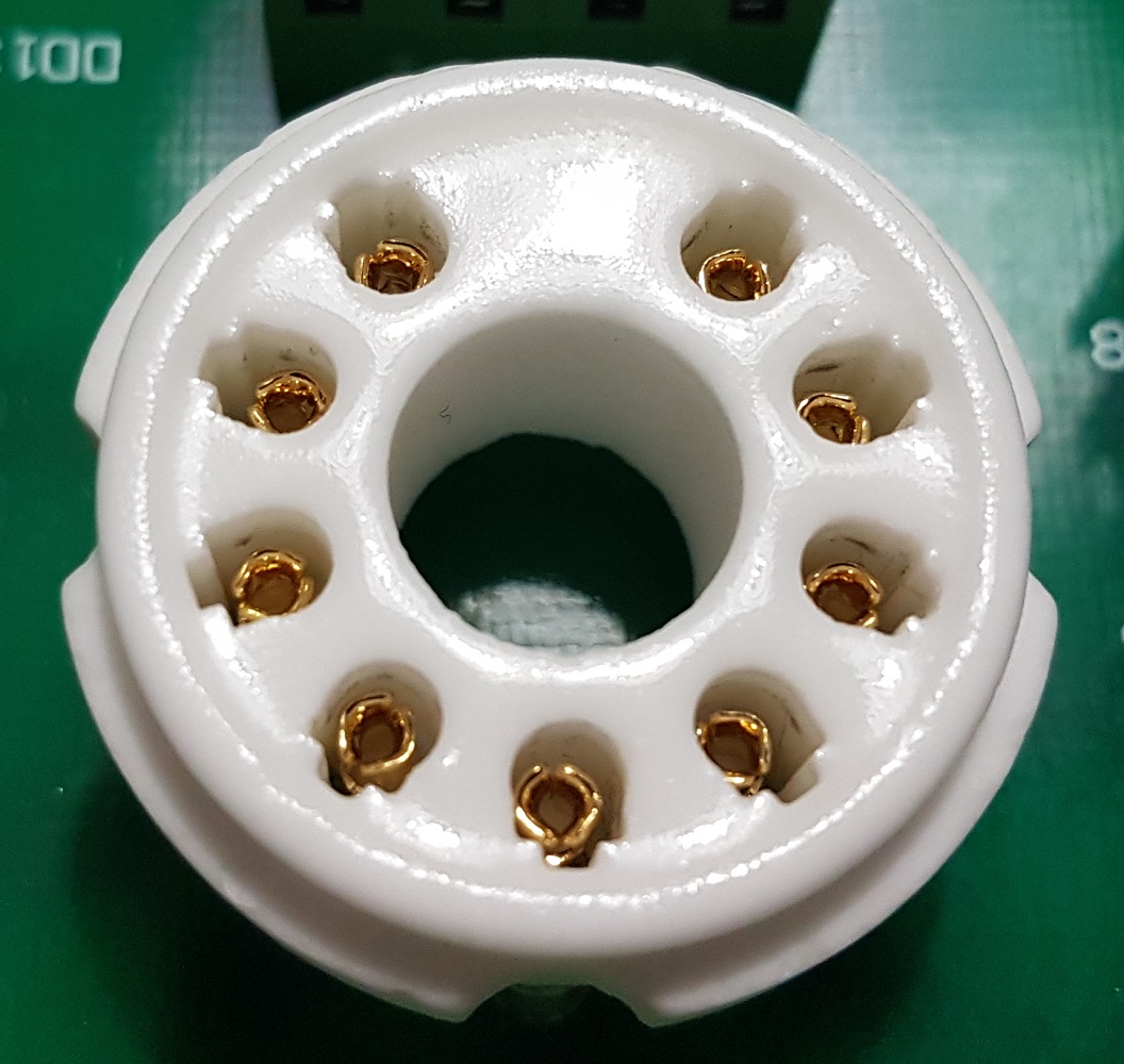

Here is some summary on converting Magnoval into Novar sockets, as I proposed in #136.

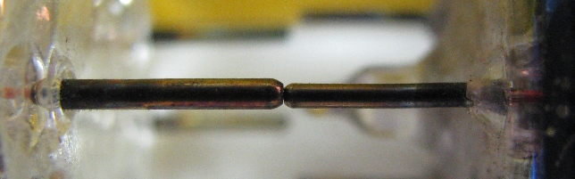

First the photo of pins’ thicknesses, indeed the Magnoval tube would ruin the Novar socket to the unusable degree.

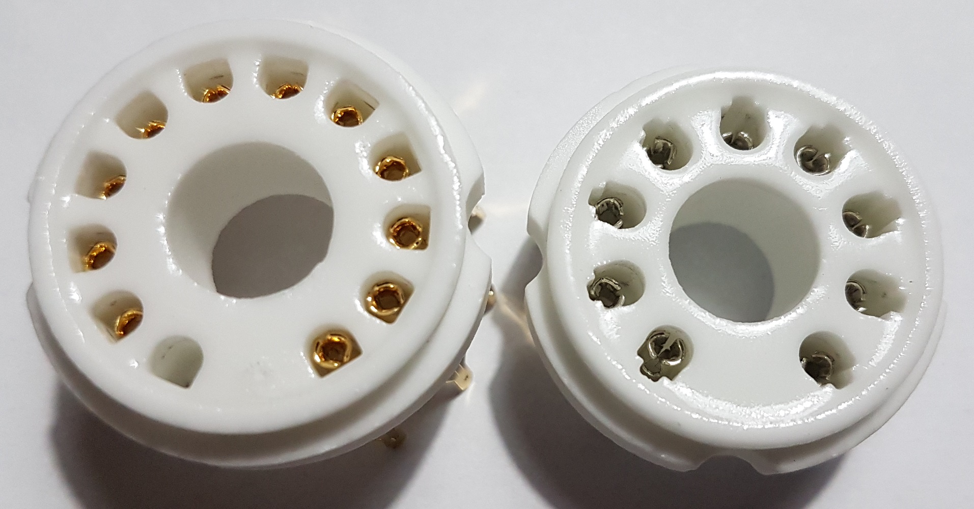

Next, the Compactron vs Magnoval sockets purchased from same GD-parts seller on evil-Bay.

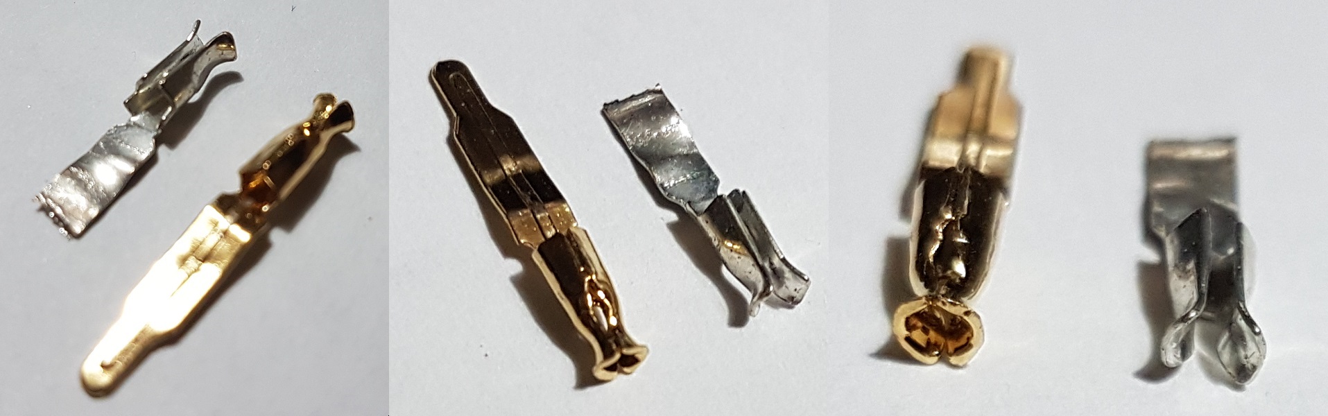

Here are the close-ups of terminals from both, at first I thought the difference should be substantial, but It is.
So I swapped the Magnoval’s terminals with Compactron’s, and the result came out very satisfying. The Novar tube inserts into and sits in it quite tightly, much better than in aka “universal” Novar/Magnoval sockets commonly sold on eBay (tried those too). The only drawback is that the new terminal sits loose in the opening enough to miss it when inserting the tube, so proceed with care. The hint: solder the socket having with a tube inserted – that will make it the better-aligned outcome. Enjoy.

Very nice results, thanks for checking that out.
Now if the socket vendors would just sell the Compactron pins separately, or already inserted into the sockets, peace would break out all over the world.....
