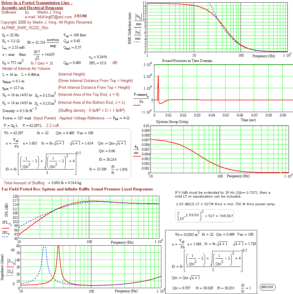

I've got some 2.2 cubic foot sealed boxes that need new woofers.
The Alpine SWR-1522D or SWR-1542D would fit exactly in the old cutouts and recesses and the TS parameters look very good. I want to run them in the 110Hz to 35Hz band. The question is are these any good for serious music? No THD specs are given and I can find no serious reviews. Other drivers would be OK but these are already pushing my budget at $200 street price 'cause I need 4 of them.

… I want to run them in the 110Hz to 35Hz band …
A closed box of 50.3 L (Qtc = 0.707) yields a flat FR down to 38 Hz. Here is a simulation with the SWR-1522D that with a mild LT can reach 35 Hz or lower.
b
1(2)

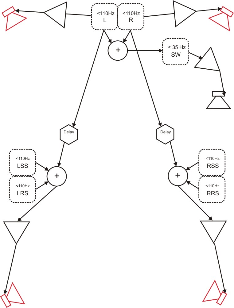

Edit:
I've attached an image of how these woofers are used.
