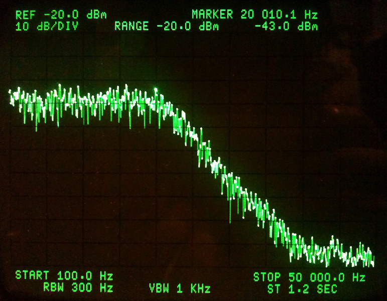

For the non believers: White noise from my NOS DAC:
0 dB @ 20 kHz
-60dB @ 40 kHz
This is no filter with constant stopband attenuation, it continues to fall with 60dB/oct, unfortunately my analyzer doesn't do any better...
