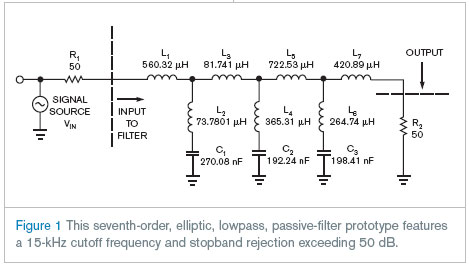

4 inductors will make a 24dB per octave, unless the laws of physics are suppressed. That is far from a "brickwall" filter... Actually that is closer of what a OS DAC requires.
I think your knowledge of physics might benefit from updating. Try reading up on elliptic filters - they achieve cut off slopes better than 6dB per order. Not saying that this filter is for certain an elliptic variant, just there's no law of physics that says filters must obey the rule of 6dB/8ve for each order. Stop band zeros are the key.
Great! Wonderfull elliptic filters... I didn't see one done with passive components only.
And sure, if you can live with ripple in the whole band, that is great!

How to get 24dB from 4 inductors ?
The values will add up and give 6dB
Here's a higher-order example from EDN magazine.
Stopband ripple as well as passband ripple, and a truly horrendous group delay towards the corner frequency to boot.
Beautiful 5 digit part values 😀
Must see a simulation of that one.

You might take a look at that filter schematic I just posted up. The values for inductors go up into the hundreds of uH. Air-cored, they'd be serious beasts (physically large) and badly prone to noise pickup.
Unusable, -3dB point @ 15 kHz
Yes, its a design for an FM multiplex filter, not a CD output filter. I just used it as an example for Sonic to see a passive elliptic filter. If you want to move the corner frequency to 20kHz, that's not hard to do. It hasn't got the stop band rejection that an audiophile reconstruction filter would want though. Suggest if you're serious about wanting to get into designing elliptic filters (or any filters really) you get a copy of Arthur Williams:
Electronic Filter Design Handbook, Fourth Edition McGraw-Hill Handbooks: Amazon.co.uk: Arthur Williams, Fred J. Taylor: Books
