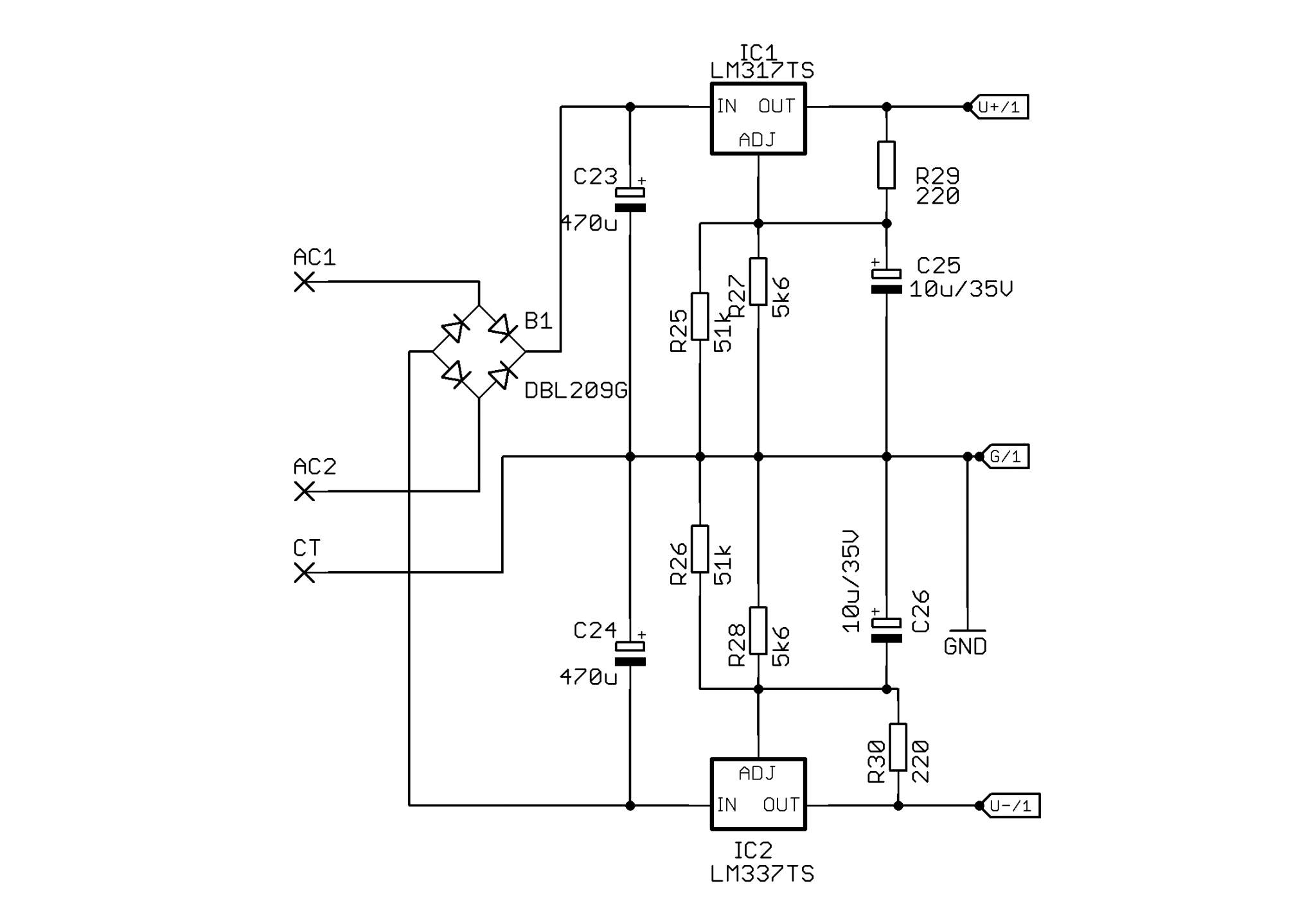

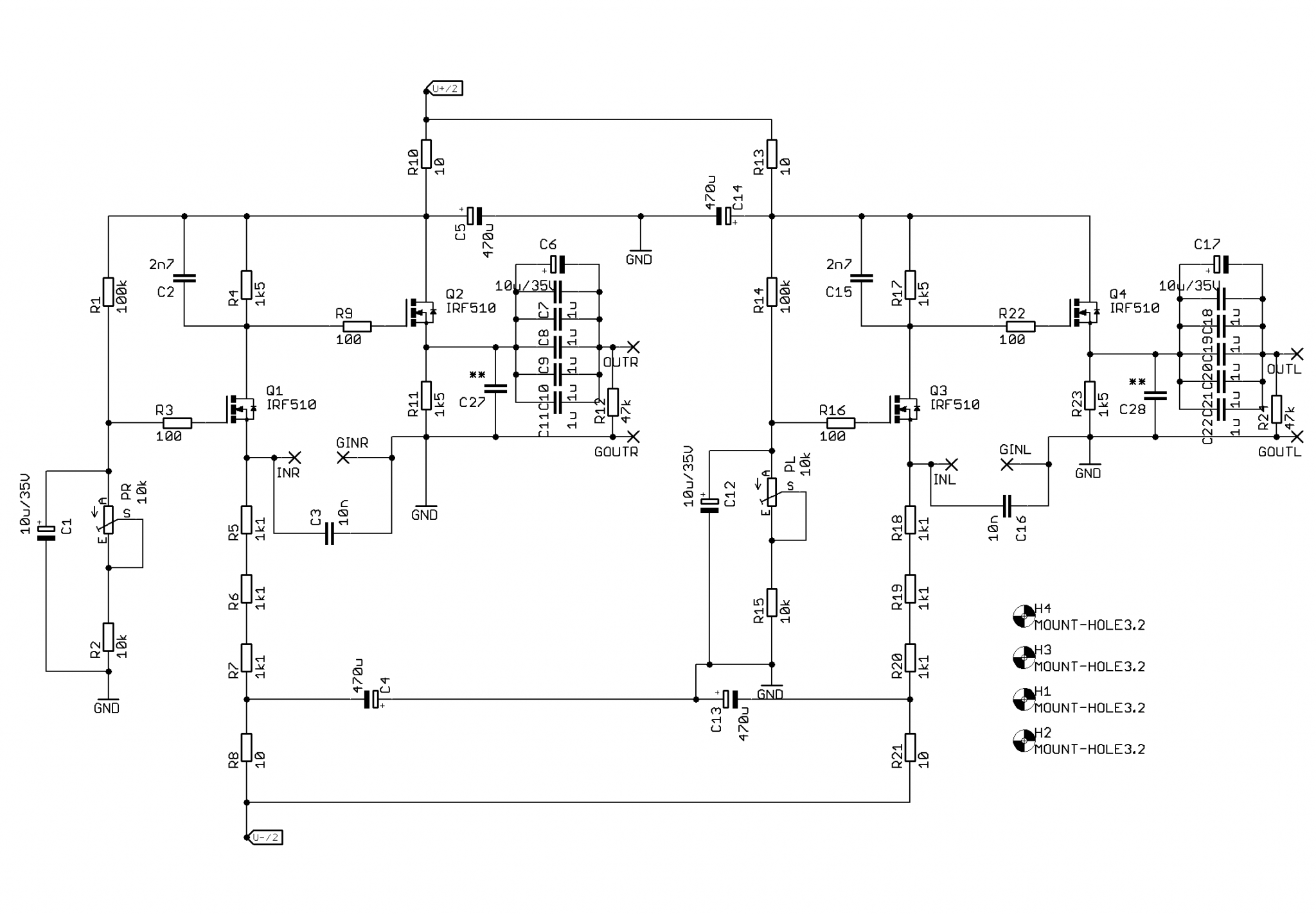

Et voilà, first questions for BOM:
Thanks in advance
- Are C27 and C28 necessary?
- All resistors 1/4W?
- Mosfet matched?
- Voltage (25-0-25 VAC?) and VA for donut?
- Heatsinks on 317s?
Thanks in advance
- start without them; if your dog or parrot leave a room, put something
-yup
-nope
-recalculate Vout of LM chips, then tell me, so I can tell you; have no notes and why should I for trivia
-nope
-yup
-nope
-nope
consider this as a starting point:What do you think of that board as starting point?

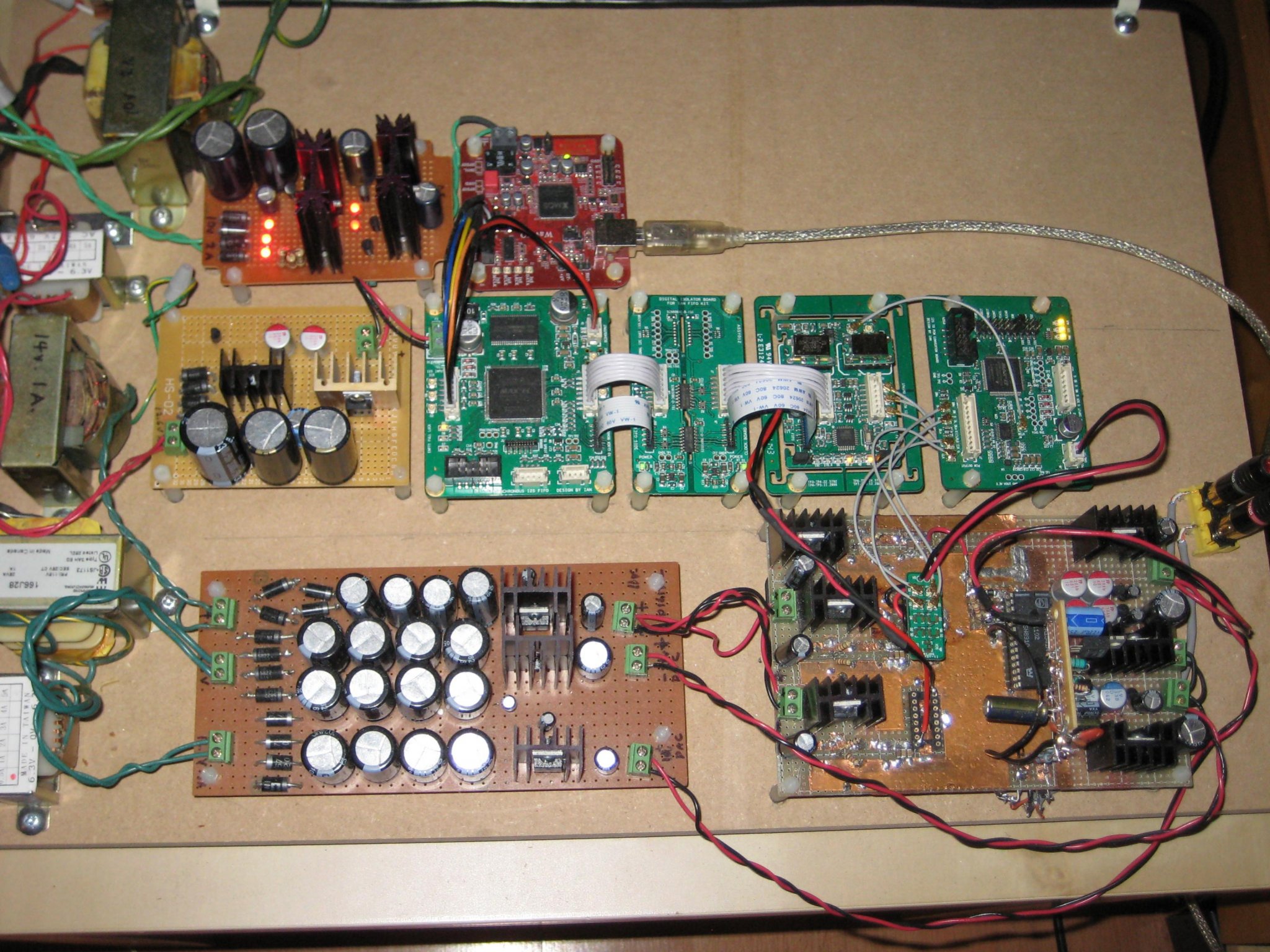

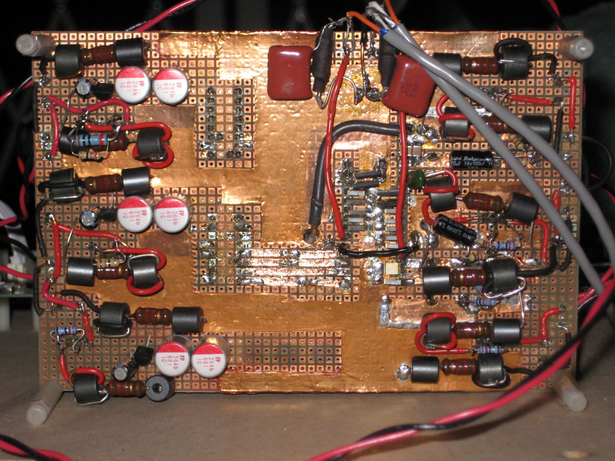

My first TDA1541A dac that I built many years ago was based on Thorsten's first published TDA1541A dac, the Adagio, with SPDIF input and CS8412. I think I used an I/V resistor of about 20 or 25 Ohm and fed the output to a single ended 5842 output stage.
Years later I built another dac based on Thorsten's recommendations on this diyAudio thread: TDA1541A Veroboard dac
Later I deleted the on-board reclocker and divider and added IanCanada's isolator, FIFO, and clock. The first picture shows this setup with the Veroboard dac at the lower right of the picture.

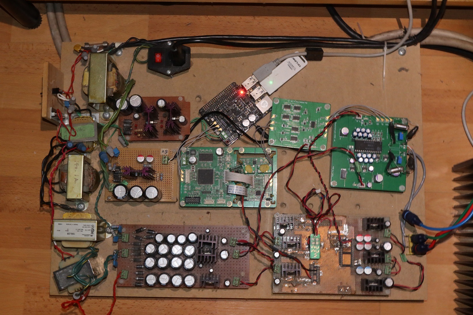

RyanJ's D3 board is now used in place of the Veroboard dac, and I take I2S directly out from a single board computer to the FIFO and clock. I still use the power supplies on the Veroboard to power the I2S to simultaneous converter and to power some of the IanCanada boards. I/V is my own hand wound 70 Ohm resistors with my preamp providing voltage gain.
I think it sounds really good.🙂

Circa 30V-recalculate Vout of LM chips, then tell me, so I can tell you; have no notes and why should I for trivia
nice me too long time on tda nos ,1543 on 2007 and AYAII from 2013Yes, I am aware of Thorsten Loesch's recommendations. Note that I currently use an I/V resistor of 70 Ohm.
Circa 30V
so current in each first section is neg 30V/string of source resistors
that would be 30V/3K3=9.1mA
buffer Iq is - voltage at gate (30V-(9.1mA*R4 deduct 4V)), divide with 1K5 = 8.2mA
gives sum of, say, 18mA per side
36mA entire shebang
xformer at least 56V center-tapped - try to find adequate close standard one
56Vac * 36mA gives 2VA
so 10VA Donut logical choice ........ of course you can use more
- NOS TDA1541 + D1 I/V & output stage
