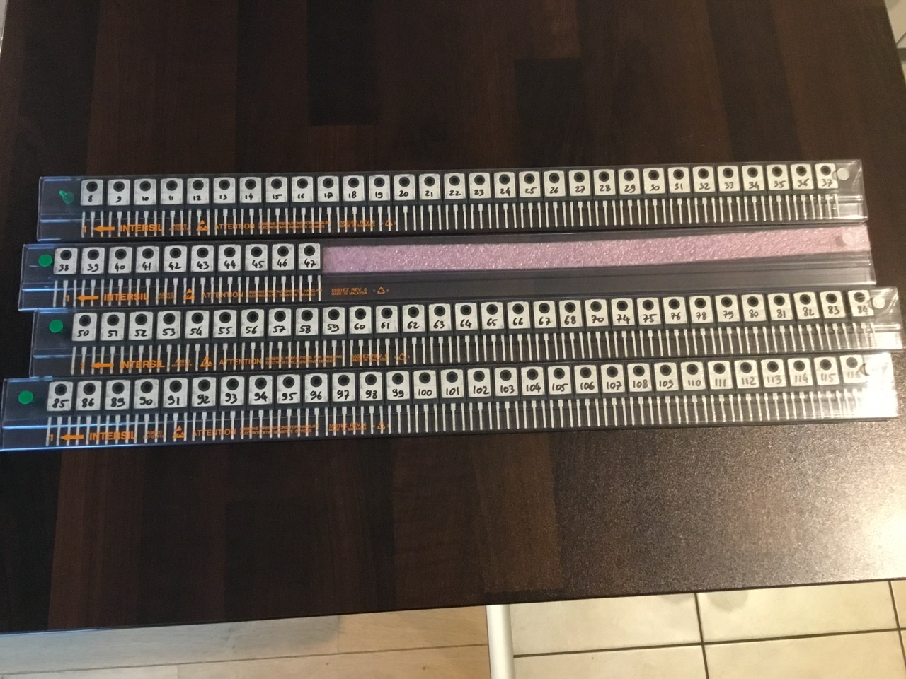

Good news! I finally received the parts 🙂
Made a first batch measurement and labeled the parts.

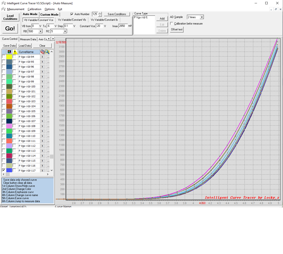

By first measurement batch, I mean I measured all 100 parts at room Temperature to make groups.
The result looks pretty nice to me. Some may stop here and sort the parts on Vgs.
I intend to go a bit further and check how curves move with a bit of temperature.

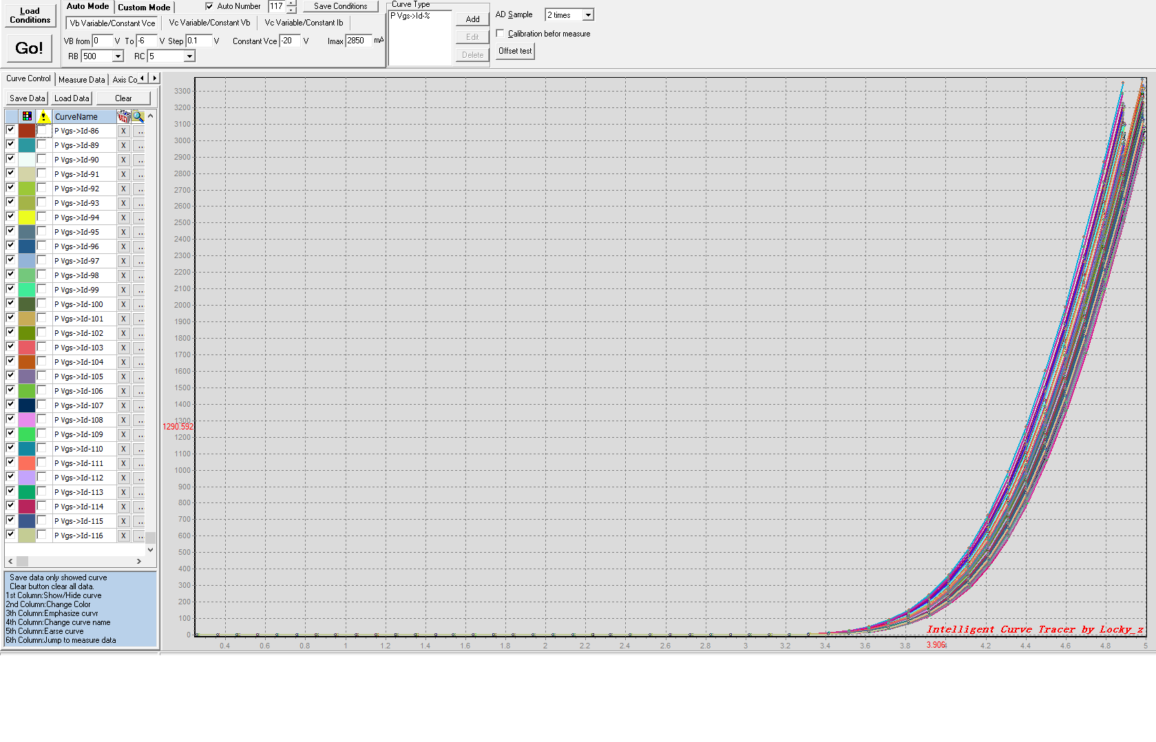

For your reference, here is what temperature does to curves.
All curves measured on the same part at different time intervals while cooling
Upper curve (pink) is measured at ~60 deg C, while bottom curve is at room Temperature (22 deg C)

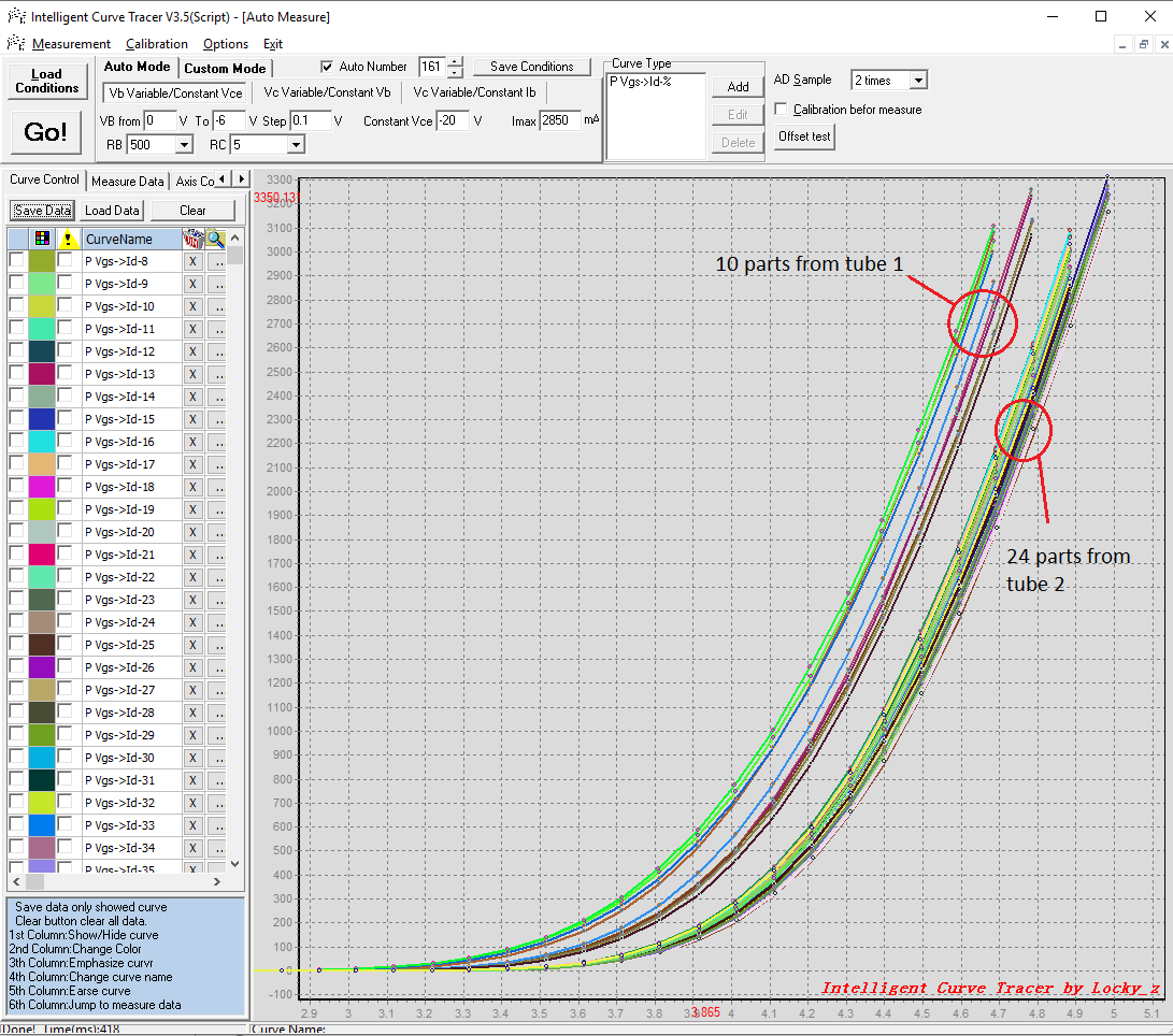

A little bit off topic observation:
Below is an illustration of what some have said (among which Nelson Pass I think) that parts from a given tube measure relatively close to each other
These are the very last 34 remaining stock of Harris IRFP9241 from Rochester, delivered in 2 tubes.
It is very clear that the first tube contains leftovers from different batches (matching reject ?) while the 2nd tube is from the same manufacturing batch, very close measurements.
