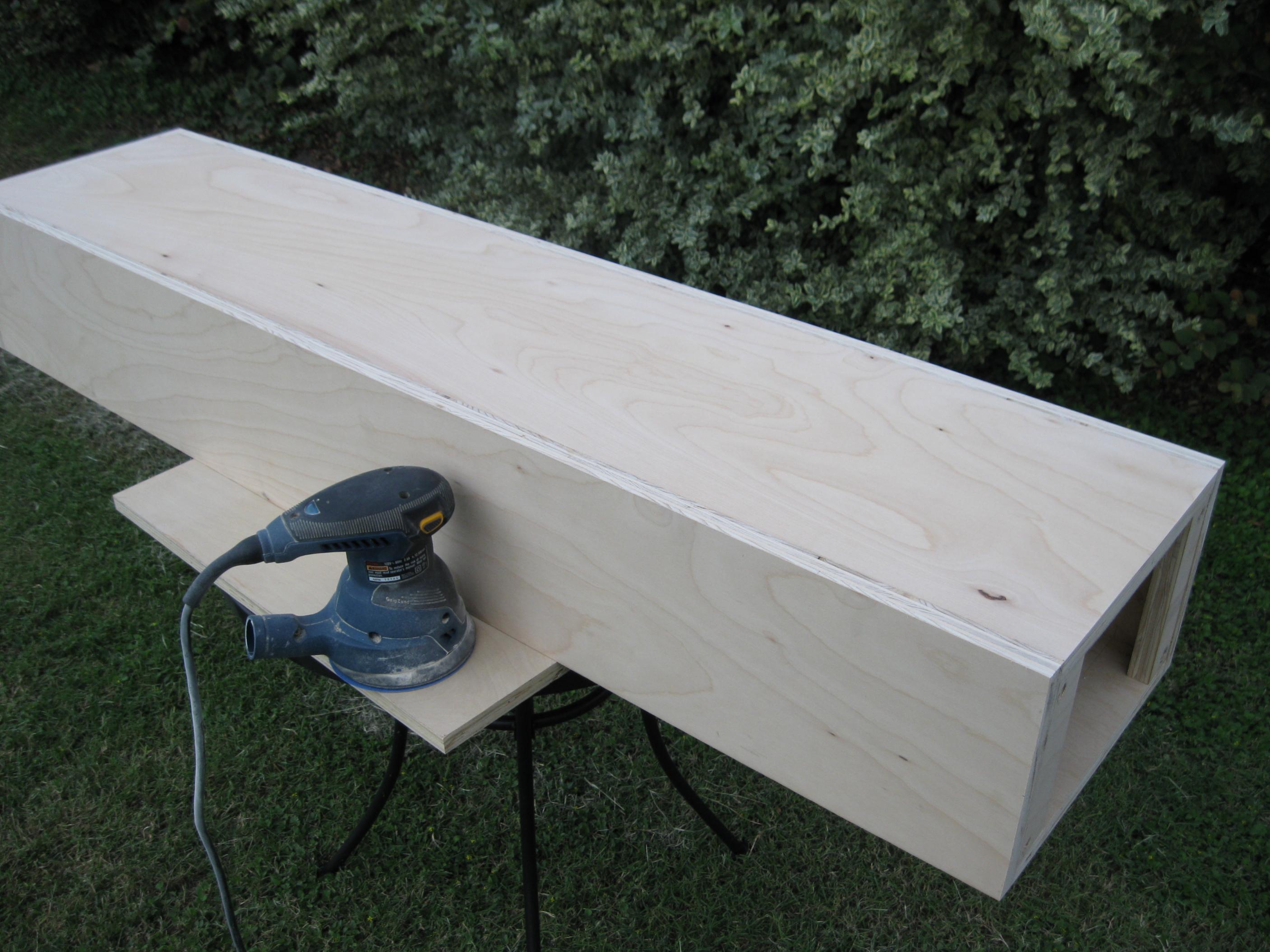

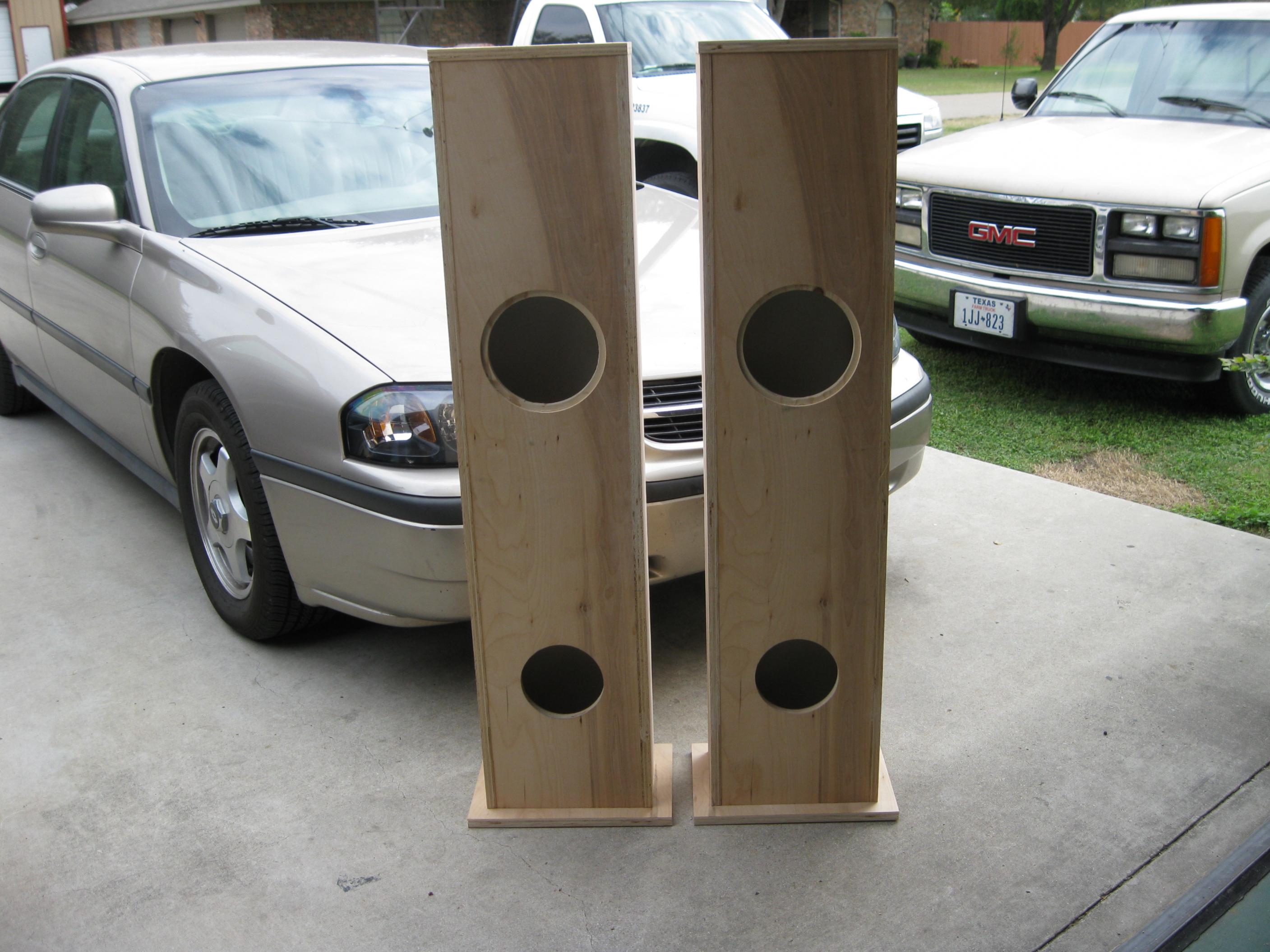

Cabs are sanded and ready for finish. I like the bare wood pattern. I'd like to clear them like they are. WAF says black to match the rest of furniture. So black it is.
I'm really tempted to put the drivers in and give them a spin. I have to wait for the Duratex to get here. They need break-in anyway. 😀
Heres the pics.

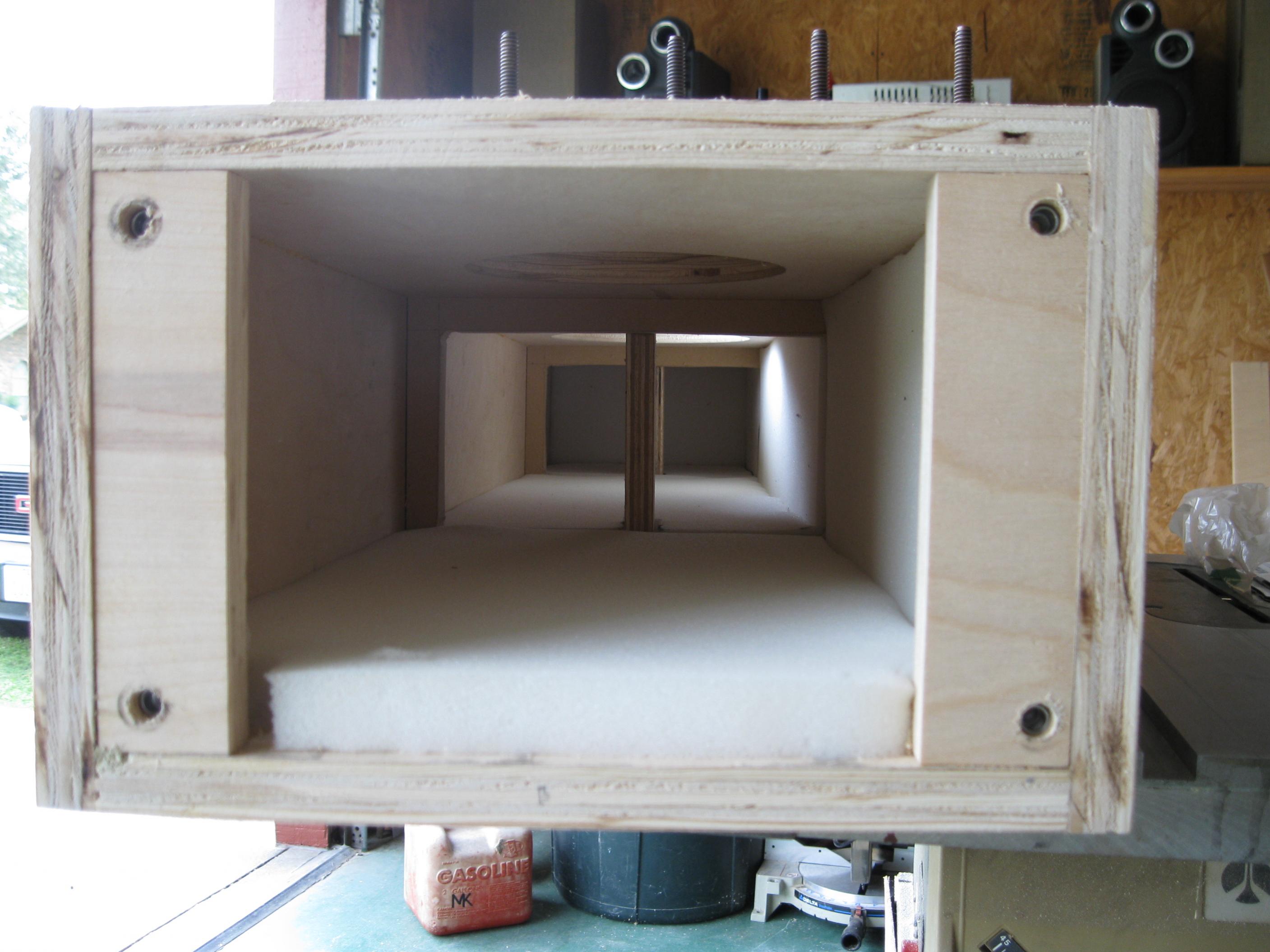

Kool! If all goes well, they should sound like a big, well damped sealed alignment except with some mid-bass gain.

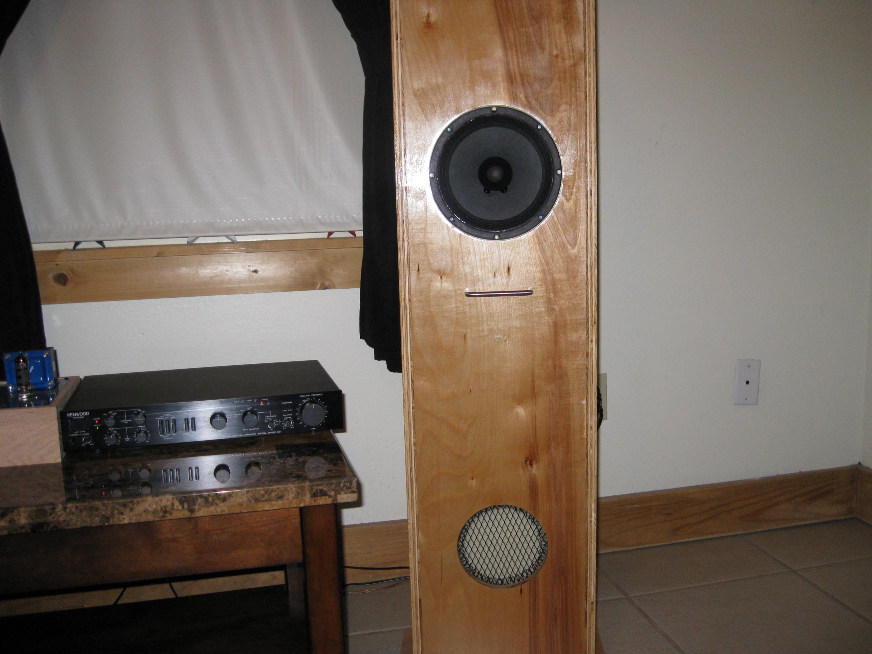

They are finished!😀 I set them up in my living room just to see how they work in a large space. The mids and highs are excellent. Bass is tight but not as low as my 6.226^3 cabs. Still no need for subs. Tonight I'll put them in the smaller listening room. Loading will make a difference.
The flash in the pics dont do the finish justice. Look much better in person.
I added a handle on the front. Also the mesh screens in the port come from dollar general mesh trash cans.😱
Update tomorrow on the listening room tests. There keepers!!

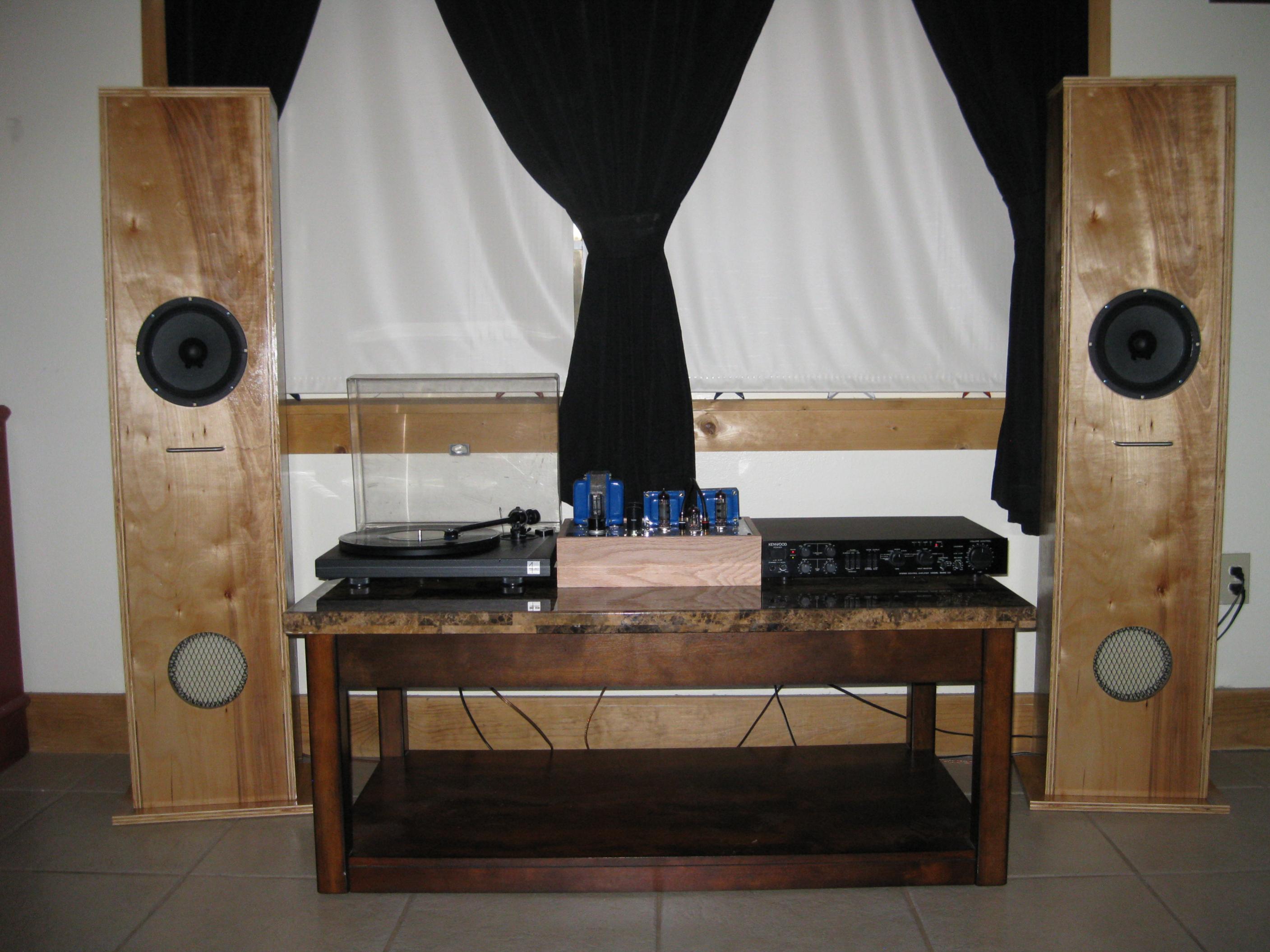

I have them setup in the sweet spot. Since they were a little smaller I was able to get them just right.
Equipment used: se el-84 tube amp, Kenwood c-2 ss preamp sl-d3 technics TT.
First lp I put on was Pinkfloyd Animals. Imaging was almost haunting. Very 3d sound stage. Sound was so precise you felt like you were in the picture.
The dogs in the distance, the whistling, the pigs. Excellent.
Next up I tried Cat Stevens. Voicing very clean. What got me the most was the piano. It sounded like it was in the room.
Dire Straits, eye opener for sure. This was like a live performance. Sound stage is very accurate. Airness around the instruments, clean drum beats. You could feel the sliding on the strings.
Summing up. I'd have to say the Towers made a synergy in the system. The in room response was very good. The bass is clean and low enough so no sub needed or wanted. Voice in the mids and highs, just right. Instruments really show up. You can hear the slightest tip of the drum edge with the sticks to the fingers working the strings.
For the amount of cash invested in the Towers. I'd have to say they are very good. To better them will cost alot more.
Total cost of the build was around 328.00 pair. That includes drivers, wood, jacks & wire, bottom bolts, foam and finish.

Did some more listening today. I wanted to make sure I didnt over project.
Tried Alan Parsons and Yes Fragile. Again they sound great. These speakers just match up to my system/room. I guess sometimes you just get lucky.🙂
