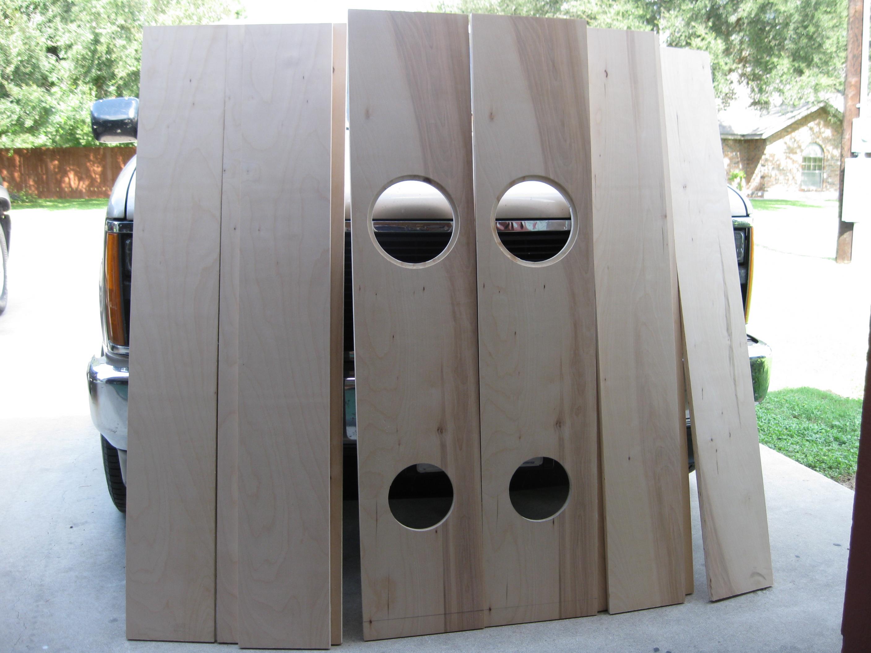

Looking good! 🙂 The base seems awfully skimpy for the super high aspect ratio though. Hope there's no kids/pets to tip them.

I might add bigger footing and putt some ballast in it. Drawing is to get a idea of the design. All comments welcome.

I was looking at the dims for the port. 3"radius x .075. 6" port looks large cut out.

Yeah, I 'run the numbers' for an alignment and it is what it is, but when I saw the cut wood, had to go back and check to make sure I hadn't screwed up.
