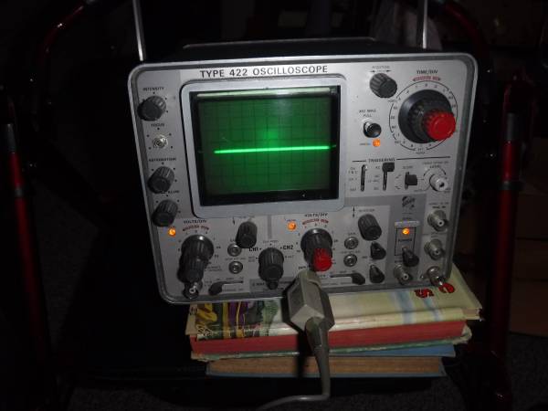

Unless it's a lot less than this one, new is better.
http://www.saelig.com/ds1000e-series/ds1052e.htm
Well, if it works and also has the x10 or x100 probe, seems ok.Yea. This and an inoperable tube tester for $40
It does only have one channel, remember. But that's not a deal breaker.
Maybe you can fix the tube tester, or sell it for parts so the scope is free.

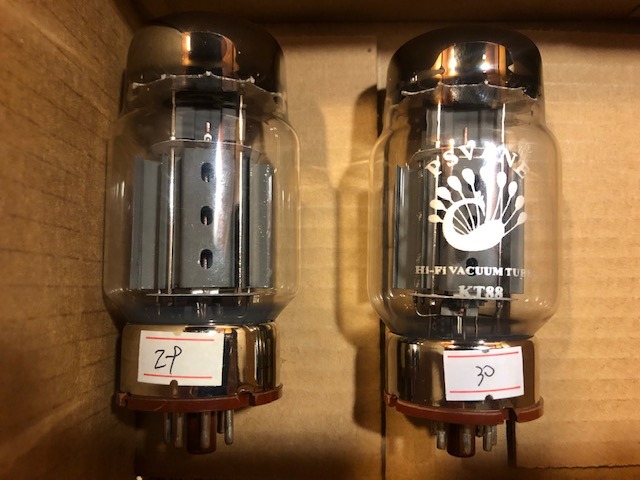

Received my tubes! Is it normal for new tubes to pop and crackle before they are broke in? I've had to adjust the bias twice and the screw is over to the 4th quadrant. I've been running 2 different sets of EL84 yellow jackets previously for a week or 2 without a hitch. I put them back in and there is no popping. It would have been confidence inspiring if the numbers on the tubes matched. The numbers written on the box are close, though. My U-Test-M shows them @ 72 and 76. Sencore shows them @105. TIA
