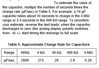

When measuring capacitance with my Fluke 87 III, it takes the 50uF capacitors 22-26 seconds to charge up before they start slowing down and creeping along.
Whenever I just put it on "capacitance" and measure, it reads O.L. no matter where the range is at.
My pea brain doesn't comprehend the instructions I have attached.

If you look at the table in my previous post, there are special instructions for the larger capacitors.

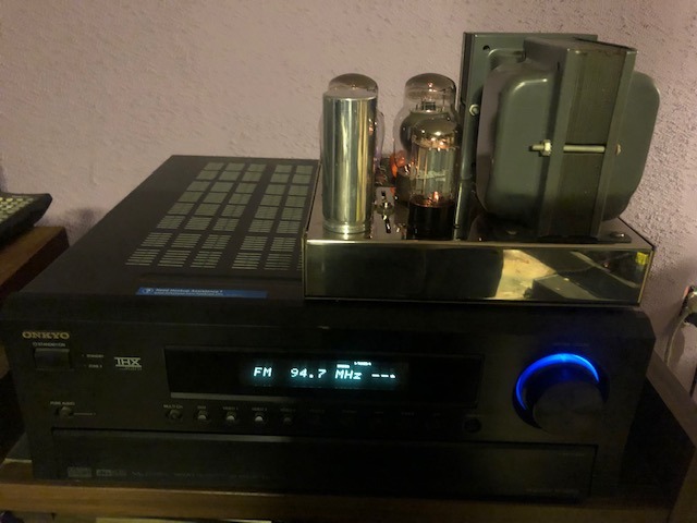

Okay. I replaced the components except for the rectifier because I wanted to see if it functioned and I am unclear on what to do. I powered it up with a variac, but I get no bias voltage. It plays music, so I'm sure I am doing something wrong. I have the positive lead on my meter connected to the terminal that says 1.56 Bias and the negative lead to chassis ground. I tried switching the ranges, to no avail. Any thoughts on this? I have some EL34's I could put in there as a test. TIA
I got it all set!
I couldn't understand why I wasn't getting any voltage on pin 6 of the output tubes when the amp was working. I kept checking my meter(Fluke 87), by switching it to ohms and touching the leads. I figured out how to put the diode in, still nothing. Come to find out after hours of checking and rechecking, my Fluke 87 meter is on the fritz. I have to squeeze where the dial is for it to register when it's on DC volts. I ended up leaving the 3K resistor in there, since it was in there when the meter started working. The bias screw is about in the middle with it adjusted.
It's working good. I am using my AVR as a preamp.
While I'm waiting to find a match for it, I bought an ST-70 that's supposed to be a one owner. So I'll probably have more questions.🙂
You guys have been a great help! I couldn't have done it without this forum and @rayma. Is there somewhere to donate?
Once again, thank you so much for bearing with me! I attached a picture of it sitting on top of my receiver for now.
