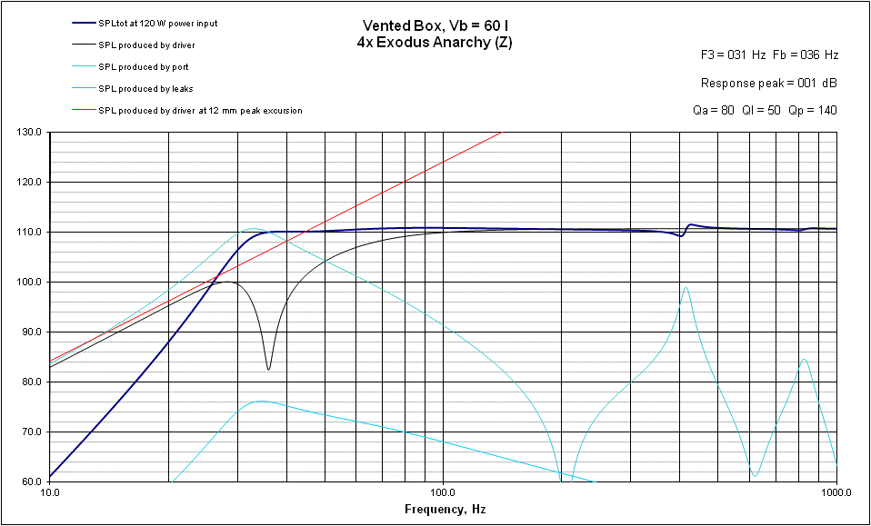

I like the 6.1 combination as I want to stay away from Ribon's/planars for now and those Anarchy drivers look awesome! I like the thought of 4 woofers as I have a huge area. A few questions though, the range is shown as a 30hz bottom end. I assume it plays lower but falls off quickly. The sensitivity is also quite different between the drivers but I understand SPL also increases by 3db per driver so 85->88->91->93, does that sound correct? Any reason I should consider a transmission line design for the enclosure? I like the look of a curved box but I foresee challenges in building this. A possible option would be for me to get access to a 2D CNC machine for wood. i assume I could create a structure out of MDF and laminate the layers together. The same concept as this but with MDF. This would also allow me to integrate the front baffle and build a curved baffle if needed for baffle defraction. It would add $175 to the project but may be worth it. http://www.soundbysinger.com/UserFiles/image/Magico M5 Full.jpg

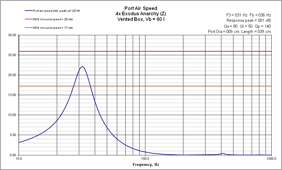

If you're filling a large area, then you can't go wrong with 4 of the Anarchies. The first graph below shows the low frequency (blue line) of 4 of them wired with 2 pairs in parallel and then those wired in series. The place the line drops 3dB below the rest (the F3) is 31Hz. Input power is 30W per driver which results in 110dB output which is about the max this combo is capable of before exceeding its suggested linear travel limits when playing content below 30Hz (graph 2). That's crazy loud. You might note that at 20Hz, output is down 22dB, to about 88dB, which should be fine for music content but you'd still want a sub for movies. Third graph shows port air speed at this output level. It's greatest right about at 31Hz but stays nicely below the red line which is what you want.
