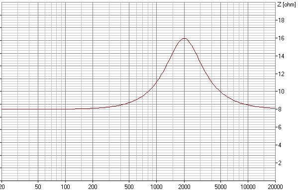

Lets just look at the impedances without DCR of the series inductor in a simple
12dB L-R passive crossover crossing at 2000Hz using 8Ohm drivers:
The textbook series inductor value for the low pass is 1.27mH
Impedance at 1500Hz is 11.96 Ohm, at 1000Hz it is 7.98 Ohm, at 500Hz it is 3.98 Ohm, at 250Hz it is 2 Ohm and at 125Hz it is 1 Ohm.
DC resistance has got to be added to these values.
The impedance of the textbook 4.98microF series capacitor for the high pass is 12.78 Ohm at 2500Hz, 7.98 Ohm at 4000Hz, 3.99 Ohm at 8000Hz and 2 Ohm at 16000Hz.

But you just listed a bunch of impedance numbers that indicate a filter being a filter. That's not insertion loss, it's filtering. Insertion loss is negligible except in speakers with a TON of additive DCR in the crossover. What requires bigger/better amps is high electrical phase angle, which depends on the crossover design.
3 octaves below and above crossover point?
Yes, three octaves but the numbers you listed only happen when you put the inductor in a circuit by itself. When you add the 8Ω load that you described, it's a different story. The impedance of the idealized 1.27mH / 4.98uF / 8Ω resistive 2nd order system you suggested is attached, and it corresponds to the filter exactly. No insertion loss until you start adding DCR / ESR.

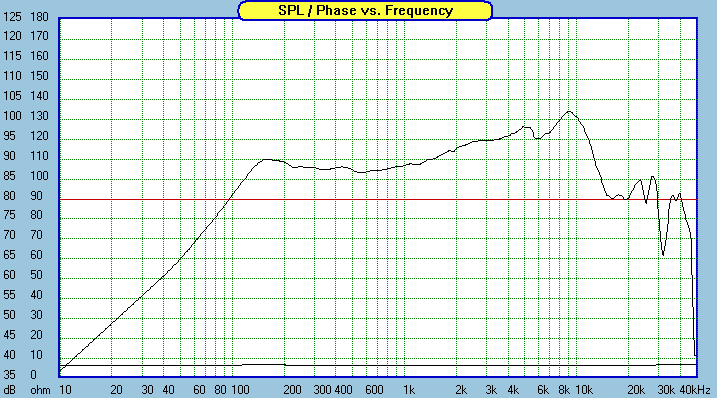

Tweeters:
1 Raal 70-10D - $390 ea.
The Madisound Speaker Store
SPL = 92dB
xo LR4 > 2800Hz
Can’t say I like the foam, but Raal’s tweeters are considered by many to be among the best out there.
2 ScanSpeak Illuminator 6600 AirCirc - $213 ea. The Madisound Speaker Store
SPL = 92.5dB
Fs = 520Hz
xo LR2 > 2000Hz
3rd, 4th and 5th HD stay pretty much 70dB below the fundamental between 1000 – 10,000Hz – fantastic.
A very quiet CSD shows best usage is above 2000Hz.

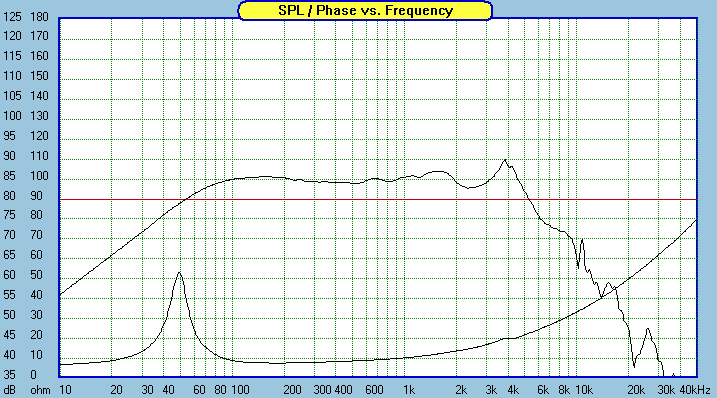

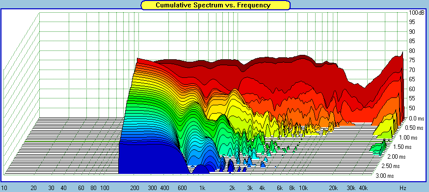

Mids:
1. SB Satori MW16P - $287 ea.
SPL = 87.5dB
Usable Passband = 300 – 2000Hz
Volume for Qtc of .703 = 10L

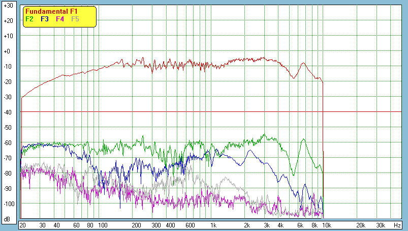

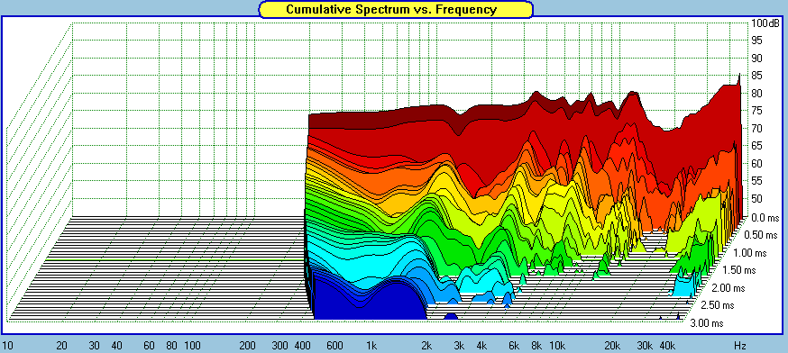

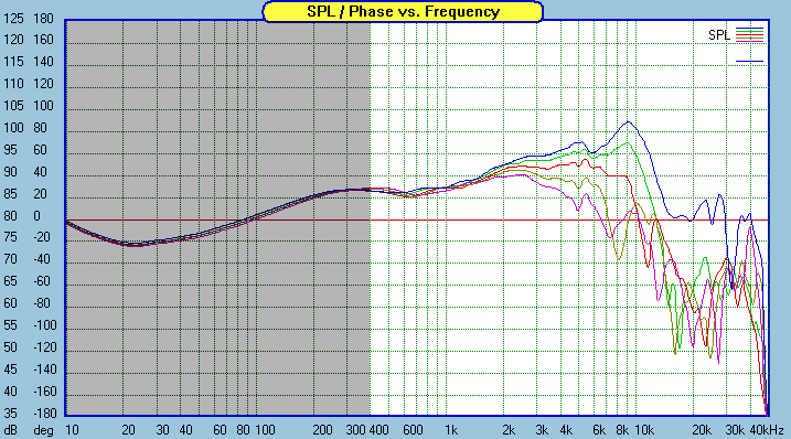

This may have one of the lowest HD profiles of any coned driver out there. 3rd, 4th and 5th HD are again pretty much 70dB down between 300 – 10,000Hz. Very, very clean.
A small hiccup in the FR at about 1200Hz but that’s probably easily forgiven.
Off-axis response starts to deviate at about 1500Hz and energy storage starts to increase above 3000Hz so don’t cross above 2000Hz.

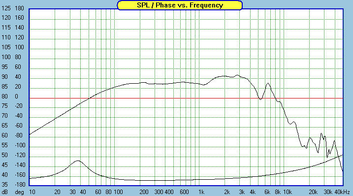

2. ScanSpeak Revelator 15W4531K00-4 – $220 ea.
SPL = 90dB
Usable Passband = 300 – 2800’ish Hz
Volume for Qtc of .560 = 3L
Graphs are for this driver’s 8ohm brother but should be fairly close. Not quite as clean as the Satori but lots of magic here nevertheless.
Just a little contouring work required above 1000Hz.
First 3 graphs are the Satori. The next 2 are the SanSpeak.

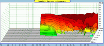

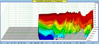

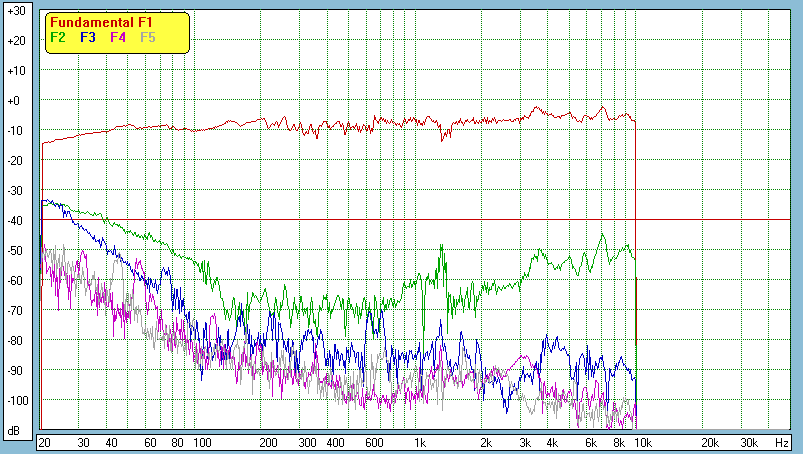

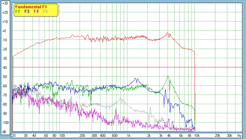

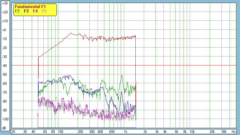

1. 7” Usher 8945A - $130 ea.
Usher 8945A 7" Carbon Fiber/Paper Woofer 296-600
F3 = 39Hz in 18L
SPL = 87dB
HD profile is virtually identical to the well known and more expensive Seas W18EX001 magnesium driver. In the LF’s, it’s better than the venerable SanSpeak Revelator 18W8531G: 3rd order stays 60dB down 80 -800Hz and 50dB down below 80Hz. Very nice.

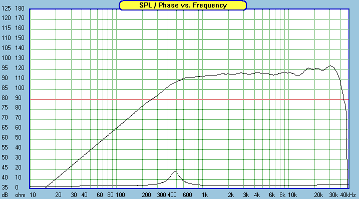

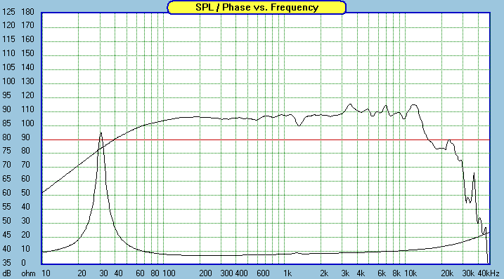

Asking how planar mids respond off-axis is the wrong question. Asking how *these* planar mids respond off-axis is a much better one, especially since I forgot to post that graph (see below). Red is 30 degrees off-axis and you can see that it hardly starts dropping from the blue one until 6000Hz. That's better than some tweeters.
