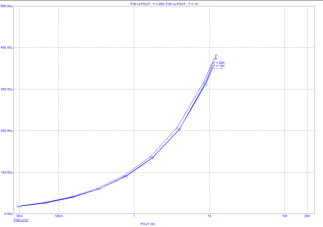

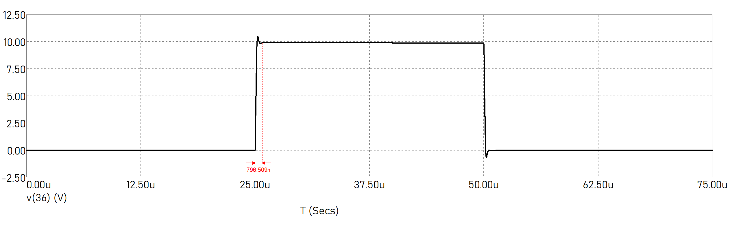

Hello kind people, I'm just looking for a bit of a sanity check on this design. I was shooting for 10W output in class AB, using ECC84/6N14P tubes as a front end since I have a few hanging around. It seems to simulate well, but I'm a complete novice so please let me know if you spot any mistakes, or just throw an opinion in. The main thing I'm looking for is squishing the overshoot on the falling edge of the square wave, throwing capacitance at it doesn't work.
One other thing, are there any specific simulations I should be running? I've run a few and attached them, but are there anything I should be doing specifically? e.g. THD at Y frequency and Z amplitude etc.
Many thanks!

Thanks very much Thorsten, I've made the changes you've suggested and it's working well , that was a great help.
In the meantime, I've been trying to make a few small improvements, namely to the load of the shunt cascode and the feedback compensation. I believe R8 could be replaced by a CCS, and Q1 might work better as a darlington pair. This should increase open-loop gain and therefore reduce distortion.
Currently, the only compensation in place is C3, but making the above changes results in instability, and simply increasing the capacitance of C3 results in an even slower falling edge. Perhaps there is a more elegant way? This will keep me busy for the next few days at least.

Plot thd residual with res() function and test at 10 kHz with enough current to turn off one output transistor.Plot thd residual with res() function and test at 10 kHz with enough current to turn off one output transistor.
Wow, that's a really useful function, thank you for bringing it to my attention. Is there anything I should specifically looking for, or is it just an easy measure of the amount of crossover distortion?

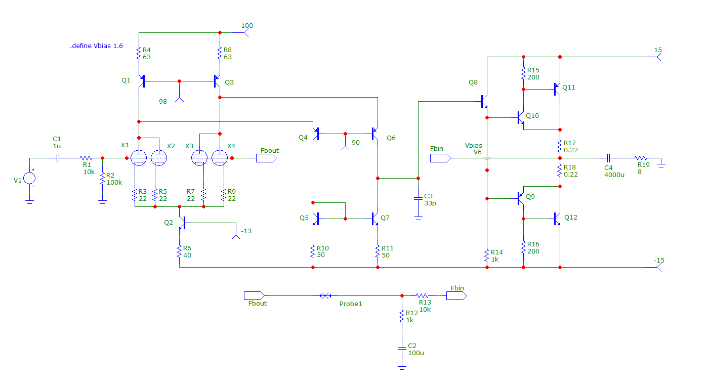

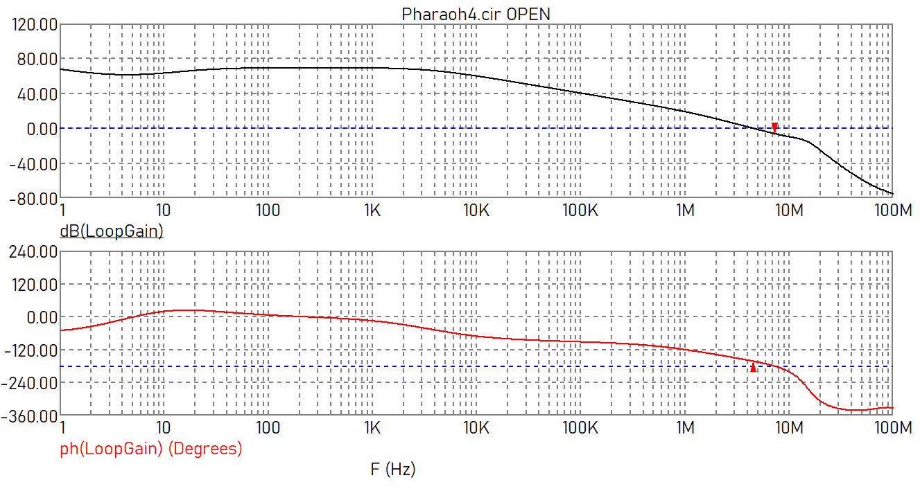

Here's the above mentioned modified schematic, without any compensation thus far, and it's associated stability plot. I've been a little busy but I'll finish the compensation and upload some more simulations when I can.

Suggestions
1. You don't need Q1 and Q2. Just use a pair of resistors to connect from the emitters of Q4 and Q5 to 100v, to get the current value you want.
2. R10 and R14 are too big. They may "eat" too much voltage. 100 Ohm is a better value.
3. Don't rely on stray capacitance to compensate the amp. Add actual cap instead. You need compensation. Check the tube's datasheet, find the transconductance of the tube, put a shunt cap on VAS output. You need to learn how to calculate the loop gain and unit gain bandwidth, and calculate the value of the cap to compensate, instead of looking at the simulation graphic.
And more:
4. You don't need Q6 and Q7. Put them there won't make anything better.
5. Feedback resistor can be even smaller. R13 contributes to noise floor (white noise). Suggest 1K or below.
I tried this, but ended up with a big current mismatch between the halves of the LTP and it caused a DC offset of about 2 volts through the output stage
My fault, I intended to compensate it and just didn't have the time, I've now rectified this.
All implemented, many thanks for the pointers. Point 5 means the feedback capacitor will have to be an electrolytic, I don't think this will cause any problems.
You have output capacitor C4. You probably don't care the DC offset at output. Thus, you can omit the feedback capacitor C2.
Also don't forget to bootstrap R14 or use current source.
And also parallel a reversed diode to the base-emitter of Q4 and Q6 for each, to protect them the potential reversed Vbe.
I'm not worried about DC offset for the output, but 2v is enough for increased distortion at full power due to hitting one of the rails. Also one transistor is shut off at idle, though I'm not sure how much of an issue that is. Missing bootstrapping is a silly mistake, you can see it's there in previous schematics and I just missed it out accidentally in this one
