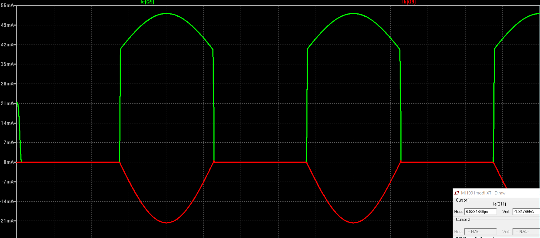

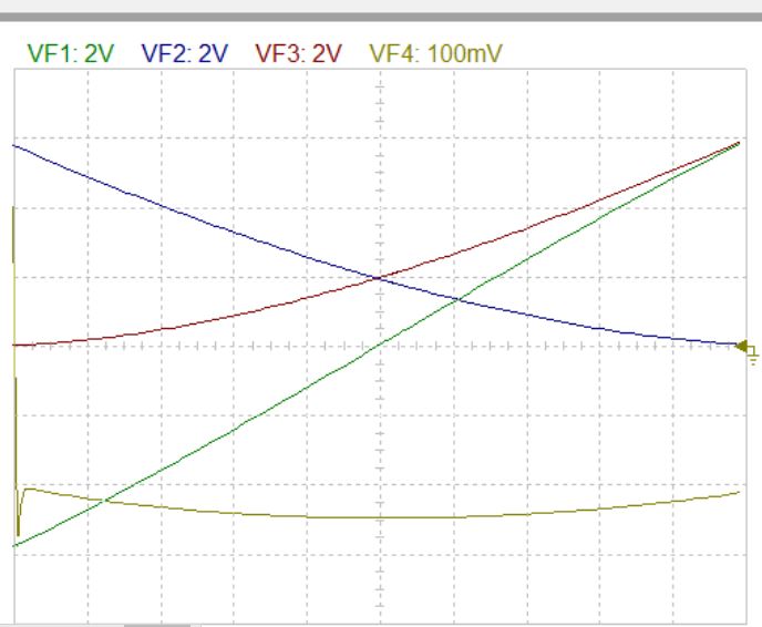

Hello Ian. The real explanition of the circuit is far less romantic than the one you are giving. The starting circuit is the 100w square law
In this circuit there is 2A bias current flowing in the common bases needs to be eliminated. The first approach is to subtract a constant 2A current , and it yields a nonlinear output
The second approach is to subtract a modulated 2A current and it yields the same as the original character.
The crossover region in the last case showed accidentally that it doesn't fall to zero or gets doubled but falls to half, which means it can be adjusted to be unity. Whereas of the nonlinear case of my interest , the crossover cannot be a straight line but must be a singular point. I will add an external independent circuit that will subtract or add the at this region about +/- 20ma, to perfect the transition point.

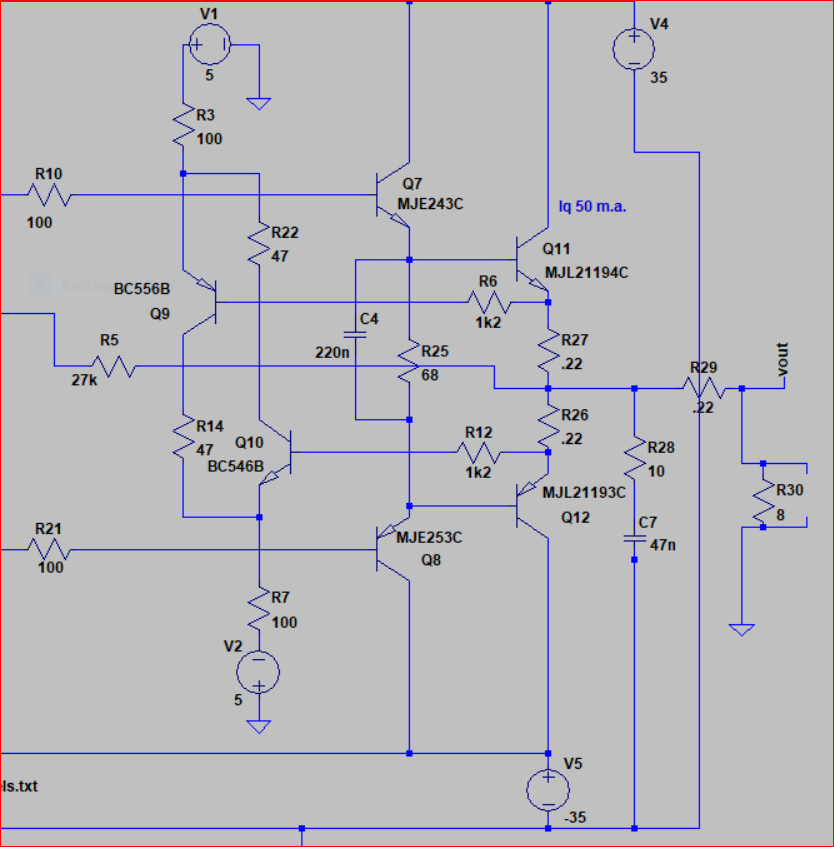

Why external? you might be able to use this push-pull modification. Check the currents through R6 and R12 against the output transistor emitter currents. The voltage drops across R6 and R12 are a form of negative feedback signal.
It is a modification of an old Class AB circuit - I used this purely for to illustrate the modification.

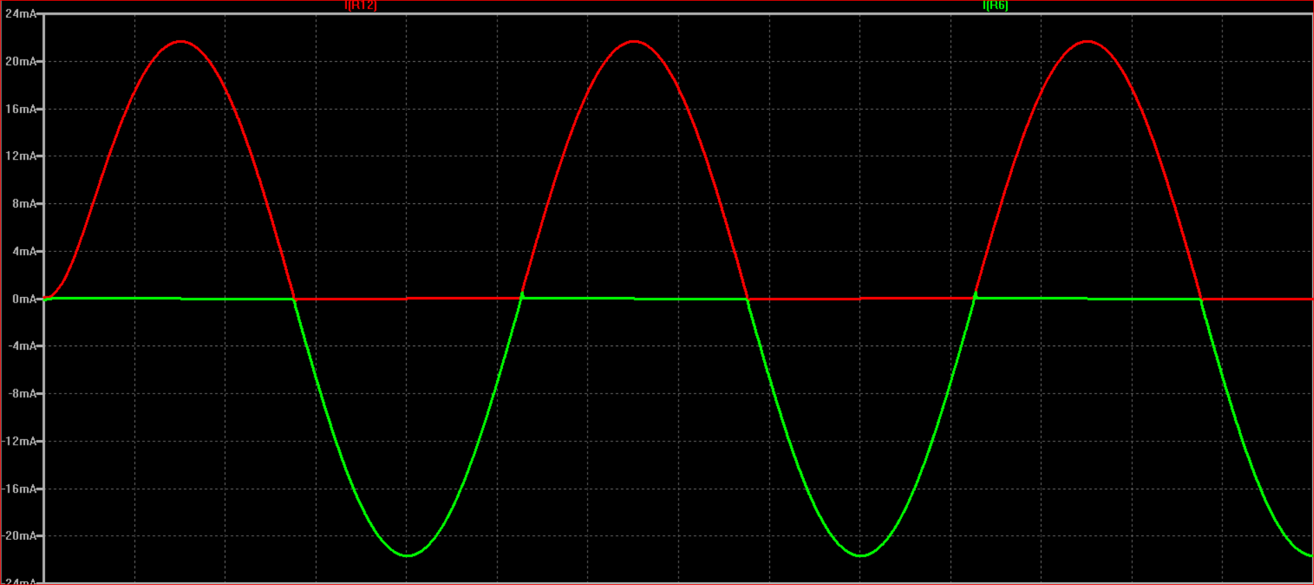

Attachment shows the processing cell for example. The cell resembles a pair interconnected common base amplifiers in one sense of +/-dc low input impedance source inputs. An interesting thought might be to include some high speed op.amps.
The output is 25V into 8R at 20kHz. The THD is modest however the circuit can re tune the FFT structure to a more monotonic form at that expense.

The changes I made to my 1991 circuit for non-switching deliver a little less good THD results than the unmodified version. The values I selected for the cell components could be changed - I have changed R12 to 1k36 improve the symmetry, but that made no difference to THD.

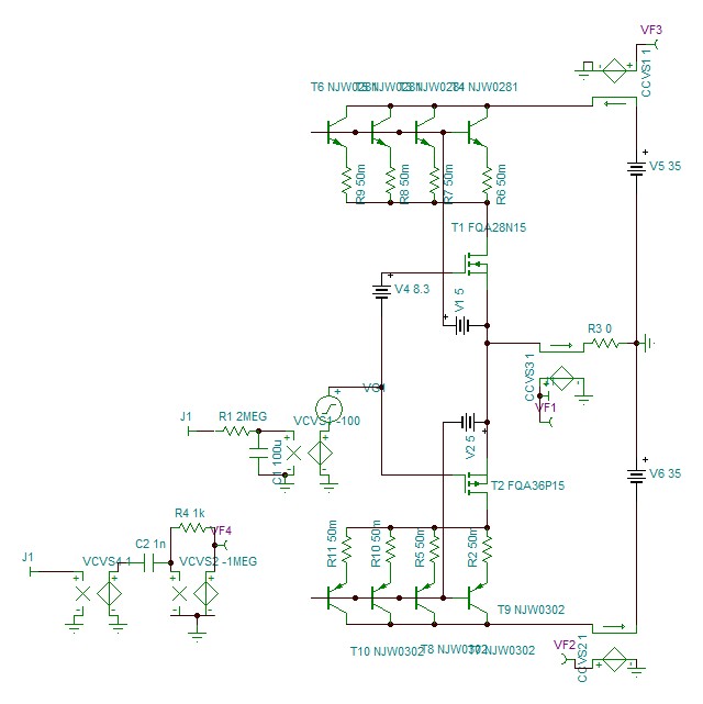

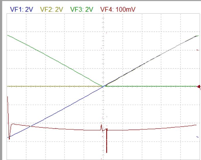

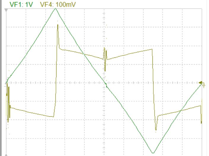

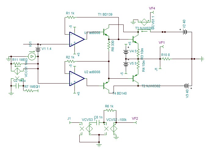

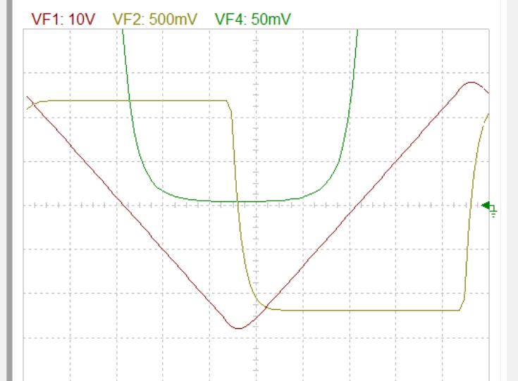

This version gives a non-switching with very low distortion 0.016% @65w 10khz. The foating supply is less than 10ma. If it gives perfect crossover with 350ma bias, but loaded due to Early character of the outputs it is 150ma that gives the lowest distortion. The 10m ohm resistors symbolizes the unevitable wiring resistances.
I applied this output stage in an extraordinary amplifier, that I'll post it in few , it delivers 0.0003% @60w 10khz.
