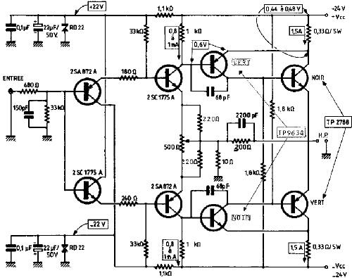

the best SS amp i heard so far are the 15 year old 30W Hiraga from L'Audiophile, Paris and the 8 watt "Le Monstre". Unless the Monstre is fed by batteries (170Ah) i could not decide which to prefer (probably the Hiraga) but a battery monster is really something,
Apart from that i heard solme very nice DC-coupled amps, but none was as vivid and juicy as the Hiraga 30W. Hadn't i needed more power, i would have built a Hiraga.
At first view I thought of changing the input transistors to Jfets.
Then I went to the monster link.
I like the design. Simple and straight forward. I sure Mr. Pass would have ideas about this design but he likes opamps.

Yeah Harry,
These pictures are all well but when are you going to post something that is actually relevant to this thread and DIY in general?
I thought the pictures were relevent in terms of layout and parts choice. It is one of the best non Pass amps that I have heard which I though was the theme of the thread. If I had drawn a schematic would it have been relevent? If anybody else feels this way let me know so I can stop posting and everyone can go back to talking about heatsinks and device matching.
Thanks,
H.H.

Harry,
I actually liked the pictures.
I built the Hiraga I liked it so much that I am building 4 more for the mid-bass in my bi-amp system.

I built the 30w version for which yo showed the schematic but then I reverted back to the original 20w version that is on Geoff site. In my opinion the 20w is a little more manageable in terms of dissipated power.

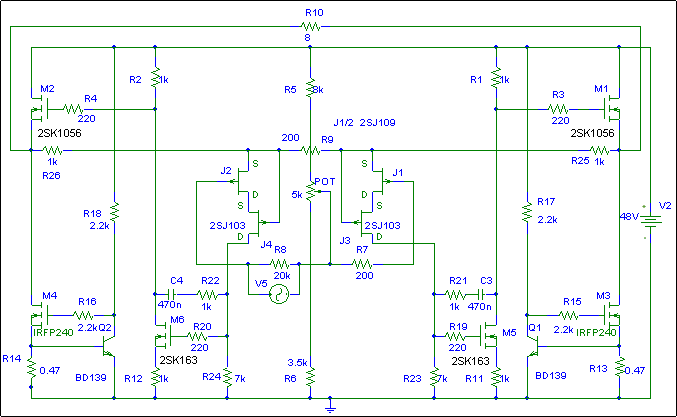

Hello!
I would like to request your opinions about this amplifiers. I designed & I'm not sure that will makes good...🙂 These MOSFET's Css capacitys is lower than serious of IRFs. I don't like capacitors in the in the way of sound.
Sorry my english is poor.
Thank you the answers.
