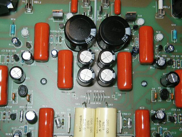

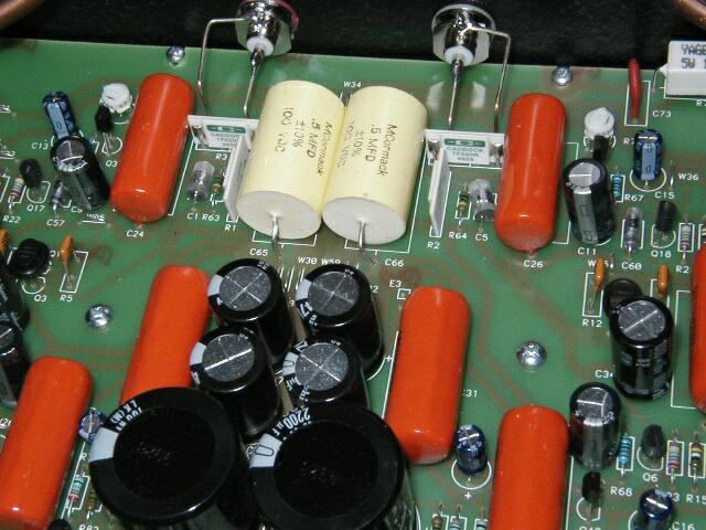

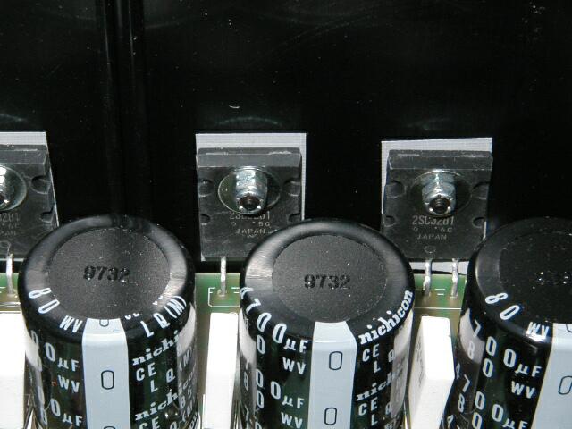

Easily one of the best I have heard is the McCormack DNA-225.
Steve McCormack has been designing forever and is one of the most under rated designers out there. Toshiba C3281/A1302 outputs, Toshiba jfets, Hitachi mosfets, Caddock resistors, and excellent layout and power supply decoupling. Amazing without insane pricing of some of the competition. I could live with it and couldn't think of too much to hotrod in it.

I wish! My local dealer wasn't happy about me photographing the amp while he was on vacation and I was helping to mind the store! I believe it is a Toshiba Jfet diffamp front end with cascode and a Hitachi Mosfet gain stage. Maybe the mysterious Mr. S. N. in North Corolina would know. When it comes to amp design, he knows everything and I know the rest. Mr. S.N. are you reading this. I actually don't like to rip off commercial designs since it is the result of insane amounts of labor on the designers part to design it in the first place. I do pay close attention to part selection though! There are plenty of excellent DIY, amatuer, Pass, and Borbely designs to base a "guilt free" design on. An amazing amount of commercial designs are based on the work of Mr. P and Mr. B. The hard work and generousity of these two is unmatched in the audio world.

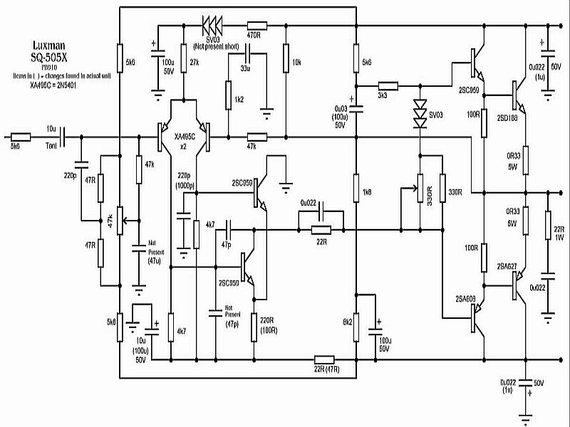

I found the luxman SQ-505X very nice, a little soft like most Luxman stuff I've heard, changed all the metal can TO5 transistors way before it became <font size="+3" color="#ff0000" face="ariel">THE LAW</font> 🙂 Nice modular layout made moding easy too.
