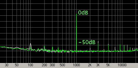

Bernhard said:...the dynamics picture, does it show a low level (-67dB) 1 kHz sine ?
Yep, I used lower value gain resistors in the I/V stage than specified by the designer - what I had around - so the voltage out is a tad bit low (7dB lower than the sound card input level - I guess around 1V) but I won't change them now as both measurements and sound (on either CDP transport or soundcard) are spectacular.
I wouldn't pay that much attention to the freq graph, those values do not correlate with the sound quality;
I also guess that the soundcard also uses 24 bit internal for recording no matter what the output bitrate in order to improve the accuracy.
Regarding the DAC itself, I have to close the box, put a lock on it and throw away the key in case I get the tinkering itch - it's a finished item from this POV 😀

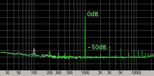

The thd graph shows -10 dB input level and the dynamics graph -67 dB input level,
so is it a low level DIGITAL signal in the dynamics graph ?
Or what does the dynamics graph show ?
Yep, in the dynamics graph there's a low level digital signal.
THD: 1kHz -3dB 'digital'
dynamics: 1kHz -60dB digital
IMD: -4dB 60Hz and -17dB 7000hz
The DAC's analog out at 0dB digital in is 7dB lower than the 0dB volume of the soundcard's line in, and all the graphs show the soundcard SPDIF->DAC->DAC's (analog) out->soundcard line in chain.

Ok, because Harmonics then start at -50dB which is not so very good.

I really don't think that for a -60dB signal a -110dB harmonic is that bad. We're getting into thermal or resistor noise issues in this range, not to mention that I used a $100 soundcard to test with its inherent deficiencies 🙂

lucpes said:I really don't think that for a -60dB signal a -110dB harmonic is that bad.
Don't know about what you want to say by 'good dithered' signal... I'm not that technical, and I'm not the one who designed the DAC, just a happy customer...
The -110dB is absolute scale, the signal is -60dB also absolte scale, so harmonics are -50dB.
Just shift the signal to 0 d<B and the harmonics by the same. They will be at -50 dB absolute scale.
That's really not true, as you can see in the THD graph (-3dB FS digital sine and resulting noise/harmonics);

Bernhard said:DAC distortion gets worse with smaller signals.
Exactly my point 🙂 , and ~-110dB for most proeminent harmonic is very good (>90dB dynamic range) for a -60dB 1k sine.
For your -60dB signal dynamics are 60dB, harmonics start at -50dB.

Ok, I give up, you're right, in the pic the harmonics are <50dB lower than the signal.
1) the theoretical max dynamic range of a 0dB FS digital (16-bit signal) is ~96dB. 108 dB can be achieved when properly dithering the signal.
2) The digital signal in question was -60dB FS in reference to 0dB FS; by DIGITALLY ATTENUATING the volume to -60dB FS about 10bits (of information) are lost;
3) it's obvious that a much lower dynamic range/noise/harmonics (theoretically in the ~40dB range) for this particular digital signal that uses only 6 bits (and you may call it 0dB if you wish) should show up in both theory and practice on the test in question.
4) Keep the REFERENCE to 0dB FS digital and don't shift the graphs up&down unless you're really looking for a 6 bit DAC instead of a 16 bit one.
5) Point taken if you look for a 6 bit DAC... 😀
Now, can you tell me which one of my points is flawed besides 5?
