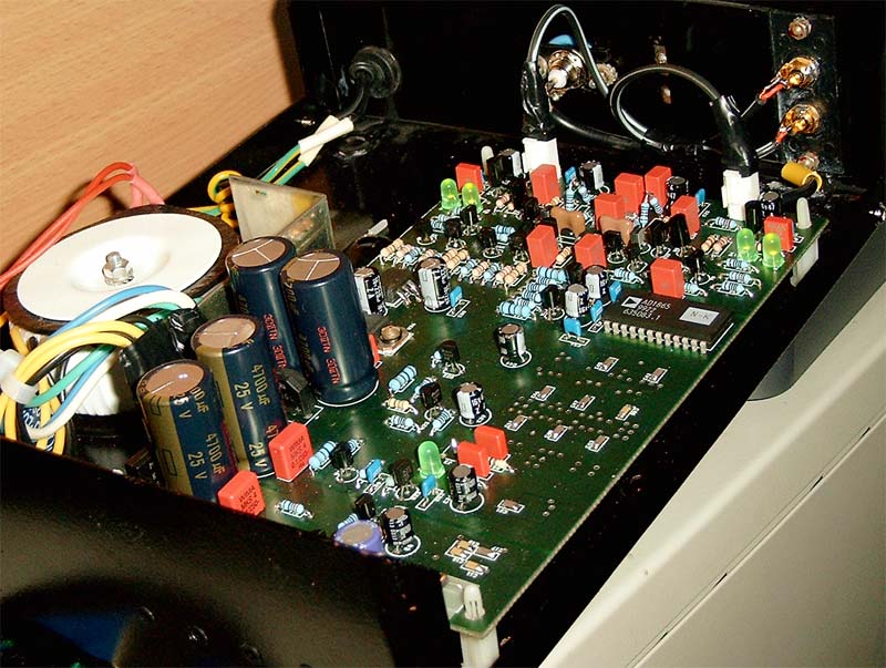

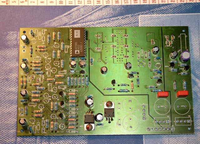

Having run out of capacitors and since the ones from Farnell come in about an week I thought of taking some pics;
The PCB and the receiver/DAC is bought from here: http://www.rockna-line.com/diy/dac/dac.htm , and if anyone could answer this thread I would be eternally grateful!
And yes, dog hair and other dirt may get onto your PCB and mix with flux residue to form a nice combo if you're not careful :D

I think the separate I/V stage is for existing CDPs/DACs (owner told me it's supposed to sound better than an opamp based one but I cannot comment on that as I did not want to rip apart my Marantz CD-94 to try that :smash: )... the DAC PCB I have includes the I/V stage.

Well, it's alive and kickin! Was in a hurry so for now some resistors are made up by two other values in series...
Using a Marantz CD94 as a transport the sound is great! I really think it outperforms the Marantz' analog out and that's not in a subtle manner. I won't comment with traditional "fuzzylicious bass, buttery mids or sweet and tender highs" terms :D

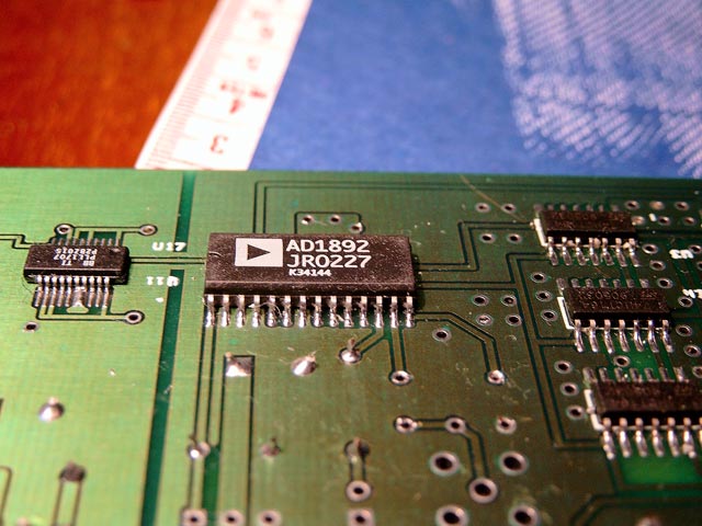

lucpes said:
Took some measurements for fun using a M-Audio Revolution PC soundcard, these seem almost too good to be true, except for the frequency response - non-OS DAC though; also, the freq test is limited to 44.1/2kHz so I couldn't catch any digital images due to non-os...
Of course, this particular soundcard's line in is not the best in the league so the DAC's standalone performance should be better (if that's possible)...
The AD1892 will impose a digital brickwall filter even when
resampling at 1:1, such is the nature of how ASRC's work.
The idea of 0 x OS is to get rid of brickwall filter.
Terry
