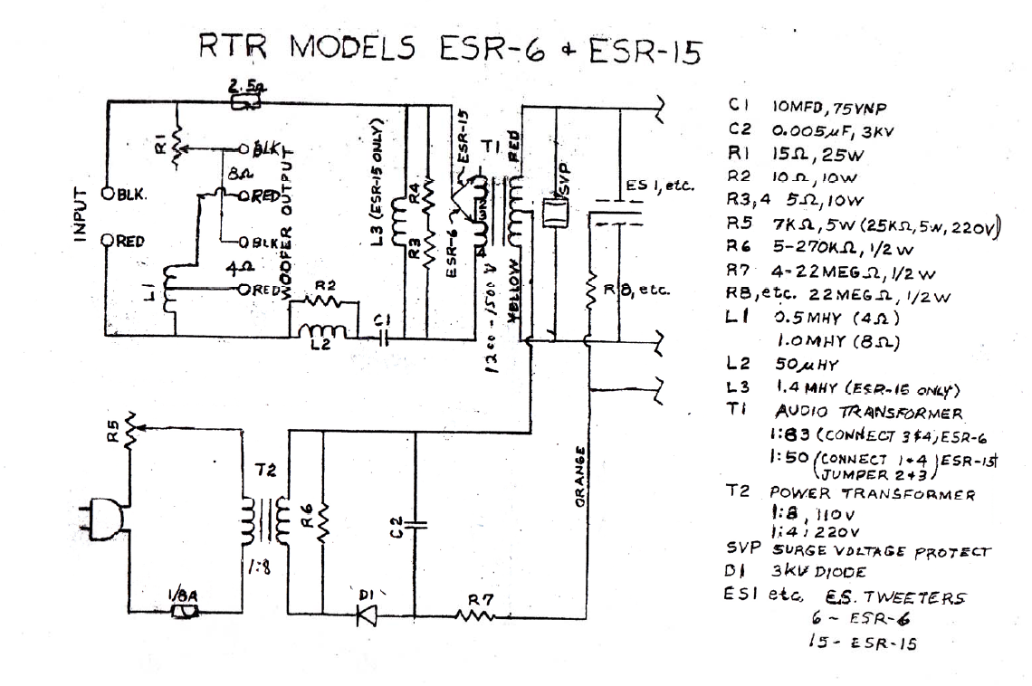

For whatever reason the potentiometer doesn't seem to do much at all -- though I'm not using the built in crossover. It changes the levels but to a very minor degree.

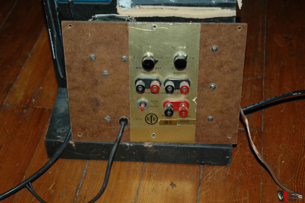

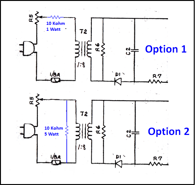

As several people already mentioned, adding a resistor in series with the audio signal to the ESL is not recommended because it will roll off top end response. The best way to adjust the SPL is to vary the HV bias. Looking at the attached schematic, the potentiometer would probably only change the SPL level about +/- 1dB. This is a very minor amount, but seems to agree with the markings on the back panel.
I’m not sure how much you are needing to drop the level…you mentioned 1/3dB and 1/2dB in the original post which would barely be noticeable, and the potentiometer changes the level more than that.
The last attachment shows two options for adding some additional adjustment range.
Option 1 would drop the level about -3dB, and retain the +/- 1 dB adjustment range.
Option 2 would also drop the level about -3dB, but the adjustment range would be increased to +/- 3dB.
Note that level adjustment will not be instantaneous…it may take 30 seconds to a minute to take full effect.

Thank you for the math - which I'll have to spend a bit of time looking at in order to understand - as well as the schematics. I've used a Behringer Ultracurve and found that dropping the HF around 6-8db is a solution though I would prefer to not have to use this additional unit. Perhaps the second modification would get me pretty close and I could achieve any additional reduction needed with some open cell foam -- which would also help with beaming in theory I guess (an issue with these tweeters).
I agree, Option 2 would be a good starting point. If you need a bit more reduction, you can always add the series resistance from Option 1 as well. Once you know what you need, values for the resistors can be calculated to provide that center level, with some adjustment available either side of center.

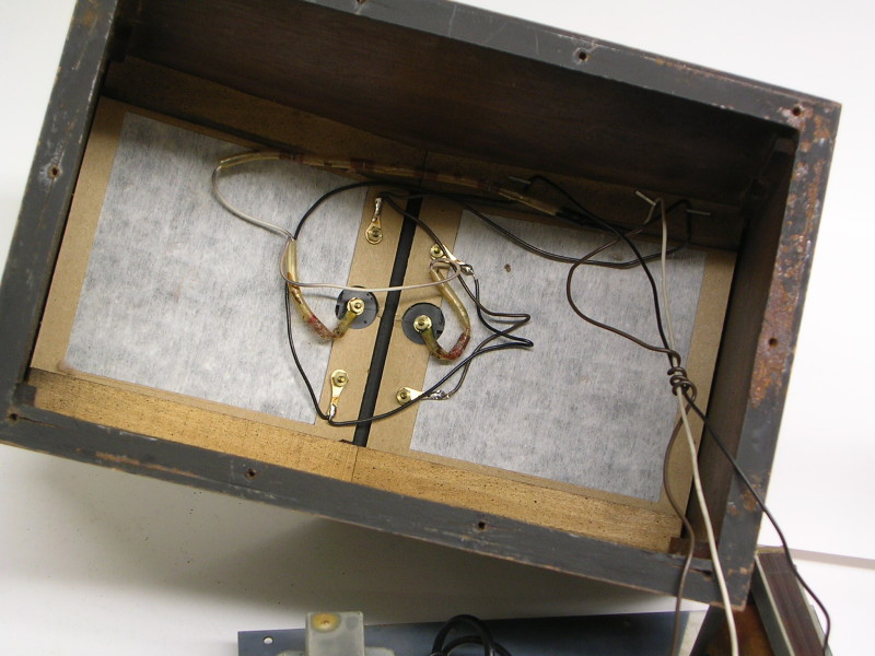

As rayma mentioned, the RTR tweeter panels can sound a bit strained in their bottom octave when listening at higher levels. Adding some thin acoustic damping material to the back of each panel like Janszen did solves this problem. Some thin crafting felt works well, to damp the diaphragm resonance modes causing the problem.
