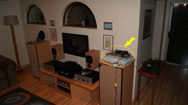

Dear Harrison,
Fortunately I never needed PCBs because my company makes me boards in a few hours when asked.
I did build one channel only almost two years ago but unfortunately it did not make the grade and ended in the junk pile.:RIP:
Last year what remained of the assembly, spare PCBs and bag of components were given to a friend's son to be used in a school project.
I was later told by his father that he got good marks for his project while his buddies thought it was very cool and they used it at a class party. :Pirate:.
Those who wrote reviews regarding SYMEF may be honest compared to what they previously owned or read about.:scratch2:
Maybe it was purely pleasing you for giving them a free PCB.:ashamed:
