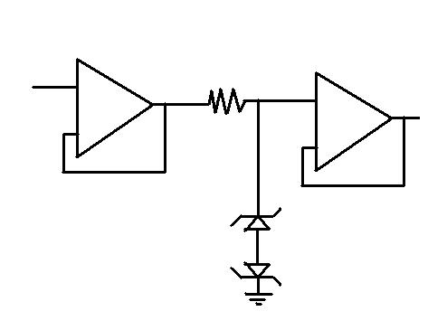

When used in PA, the clipping may go unnoticed, or the guy at the console may not even care and keeps the volume up, regardless of distortion and other things that may happen.
What I'm trying to do is have that volume turned down a bit, automatically, and keep it below the actual amp's clipping level. The distortion induced by a volume lowering must be less damaging and perhaps much less audible than the amp's clipping induced one.
I'm thinking something along the line of an opamp, as a VCA, which just stays at unity gain most of the time, but then beyond a set threshold it lowers gain. There would be some lag in response, so perhaps there is a way to help that.

I've found a schematic from a carver amp pm1400, and I've been examining how it's made and how they handle the clip elimination.
It might turn out fairly simple if it's not done completely as they do it. They include more than one factor in the clipping control circuitry, such as output current sensing, drive level from the amp's input opamp, and there is even a heat sensing influence in it.
The thing is, sensing the output current is making use of the action taken by the vi limiters, so that obviates using them.
An other thing that I think could be avoided, is using the actual drive level from the amp as a feedback info to decide when to act against clipping. There can only be a lag and without some serious averaging, it can induce that pumping effect in the clipping prevention.
I'm thinking that the limiting could be simply preset to the known level right before the amp clips.
They use a diode bridge in which they feed the drive level from the amp's input opamp, then what comes out from that bridge is used in an opto-coupler that has a photo-resistor in it, and that resistor comes in parallel to a resistor at the input of a buffering opamp.
Fairly simple and the key would be to be able to set the proper threshold for action and use the input drive level, but not from the downstream amp, to avoid any pumping action.
Some clipping would be permitted, but short lived and mild, which the amp could handle and that would not be significant enough to cause any damage to speakers.
If the threshold is set close to the amp's clipping level and no action is taken below that, then this should be fairly transparent.
A switch can be there to turn off the anti-clipping circuit.
