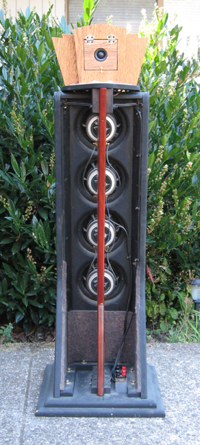

This thread was active long time ago, I just want to update, what happened in the mean time...I finished Nola like speakers, with four mids on open baffle with 4th order LR passive low pass at 3kHz, 2nd order high pass LR for planar tweeter.
Both tweeter and midrange drivers are top notch quality. Sound is amazing.
I use dsp to split the signal at 150 Hz and biamp the Nola like with chip amp, and 2x15" woofers with 100watts ss amp.
Its been in my main system for a while, and perhaps sound even more coherent then my 4-way dipole speakers.

VERY cool build... thanks for posting.

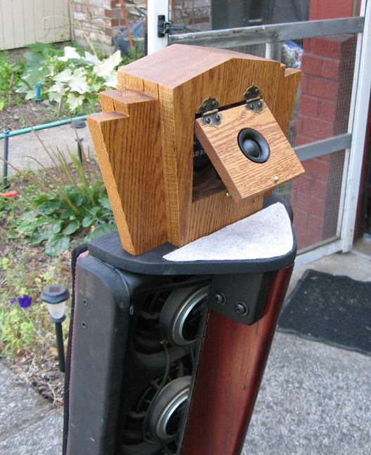

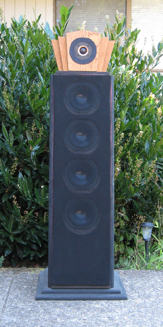

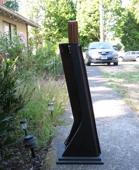

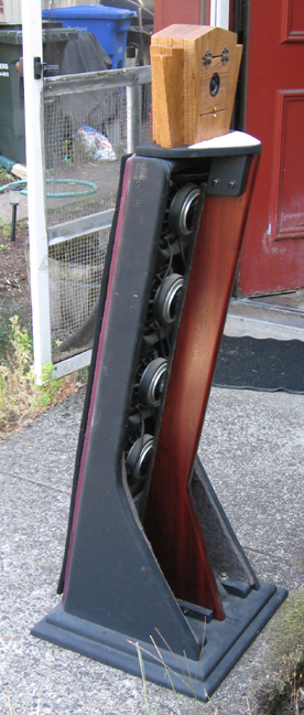

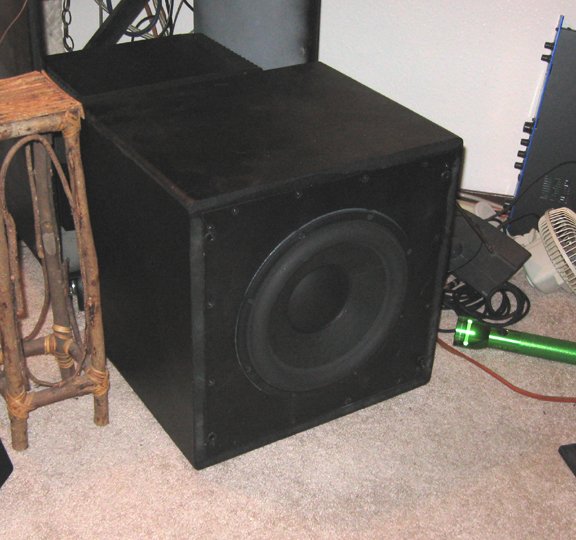

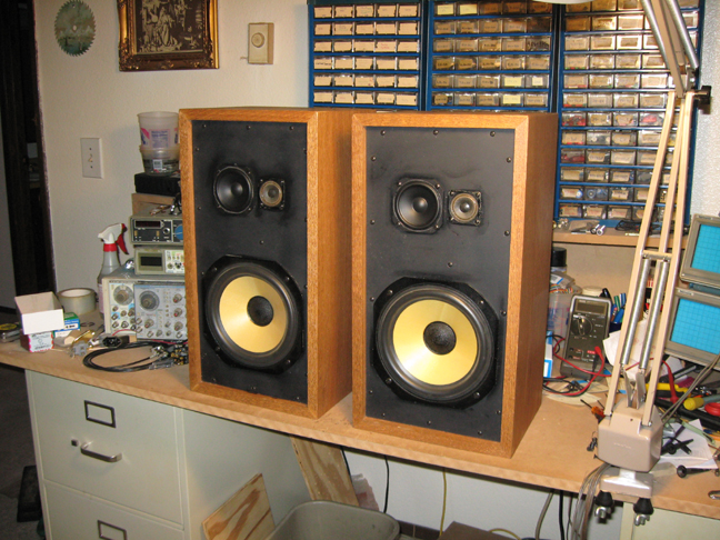

I'm generally a big fan of open baffle speakers, and I built a pair (see photos), but, and I'm not sure I fully understand this, but they really need to be positioned at least 3 feet from any walls to show their true potential. Less than 3 feet creates some kind of psycho-acoustic effect that doesn't really work. I built mine when I had a house with a bigger living room. Now I'm in an apartment that is only barely big enough, so I'll be selling my OB's and going with some small tri-amp'd bookshelves I made. The OB's do from 100HZ on up. Bass is handled by two 12 inch Peerless XXLS woofs in sealed actively EQ'd cubes. I may have reached that age (61) where simple is better. Less stuff...

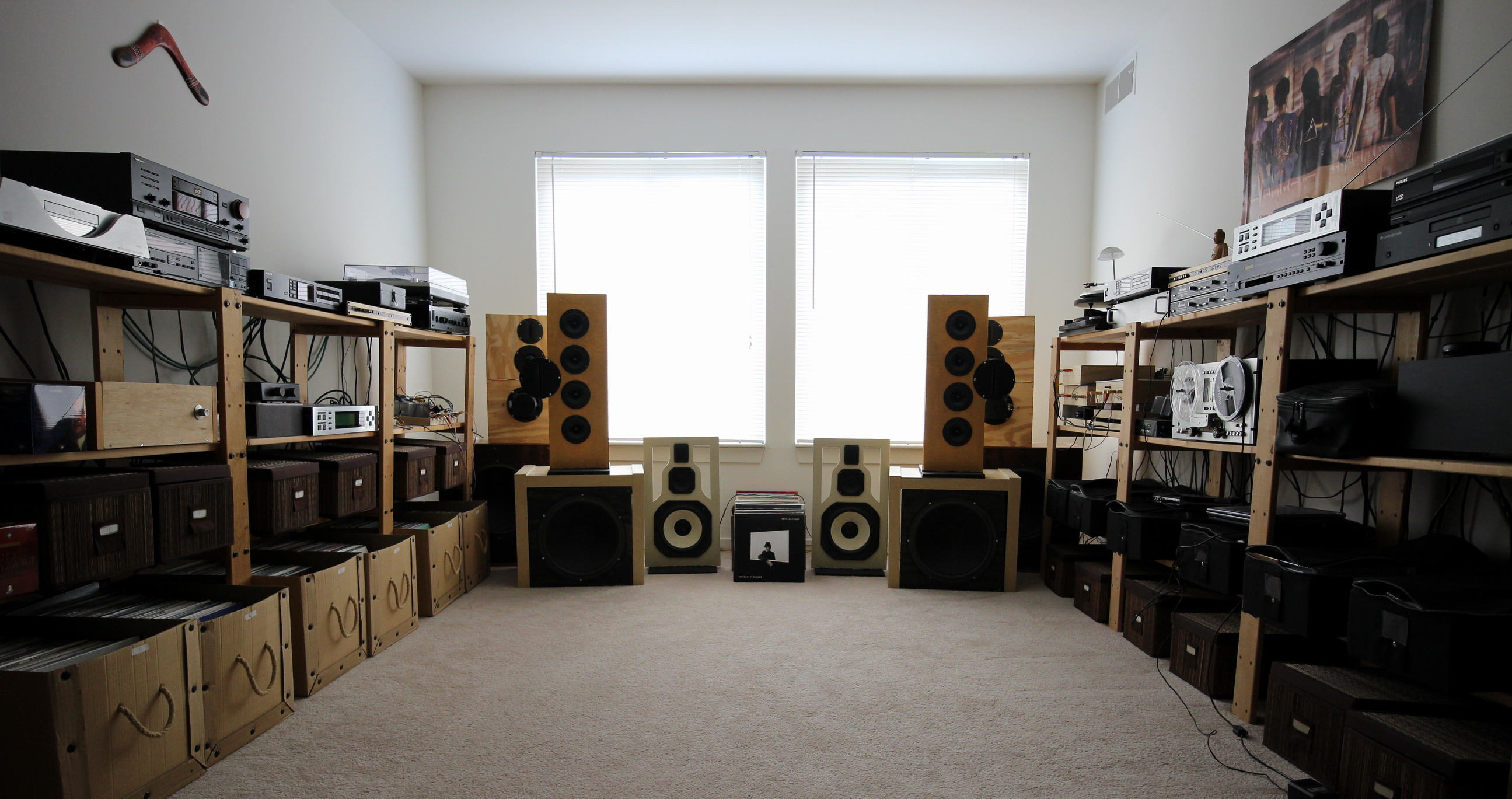

ewollowe, that is main room, and probably best for now
There are three more rooms with hifi i have, constantly ewollwing (haha pun intended) and even my bedroom has three systems in it...
My speaker lab has most evolving stuff for now, and some times just fun, sometimes seriously good sounding stuff.
Right now my speaker lab is testing Dartzeel amplifiers with AC130F1/Fountech ribbon series bookshelf and 2x15" sub, which already sounds way too good to be in small room. I bet Dartzeel will make it up the ladder.
Lab room has kt88 se amps powering open baffle coaxials with 98dB sensitivity and that special se class A high efficiency combo magic...lots of options
I guess my next step will be 4way digital crossover, so i can infinitely play with crossover frequencies, slopes, levels, delays and so on...

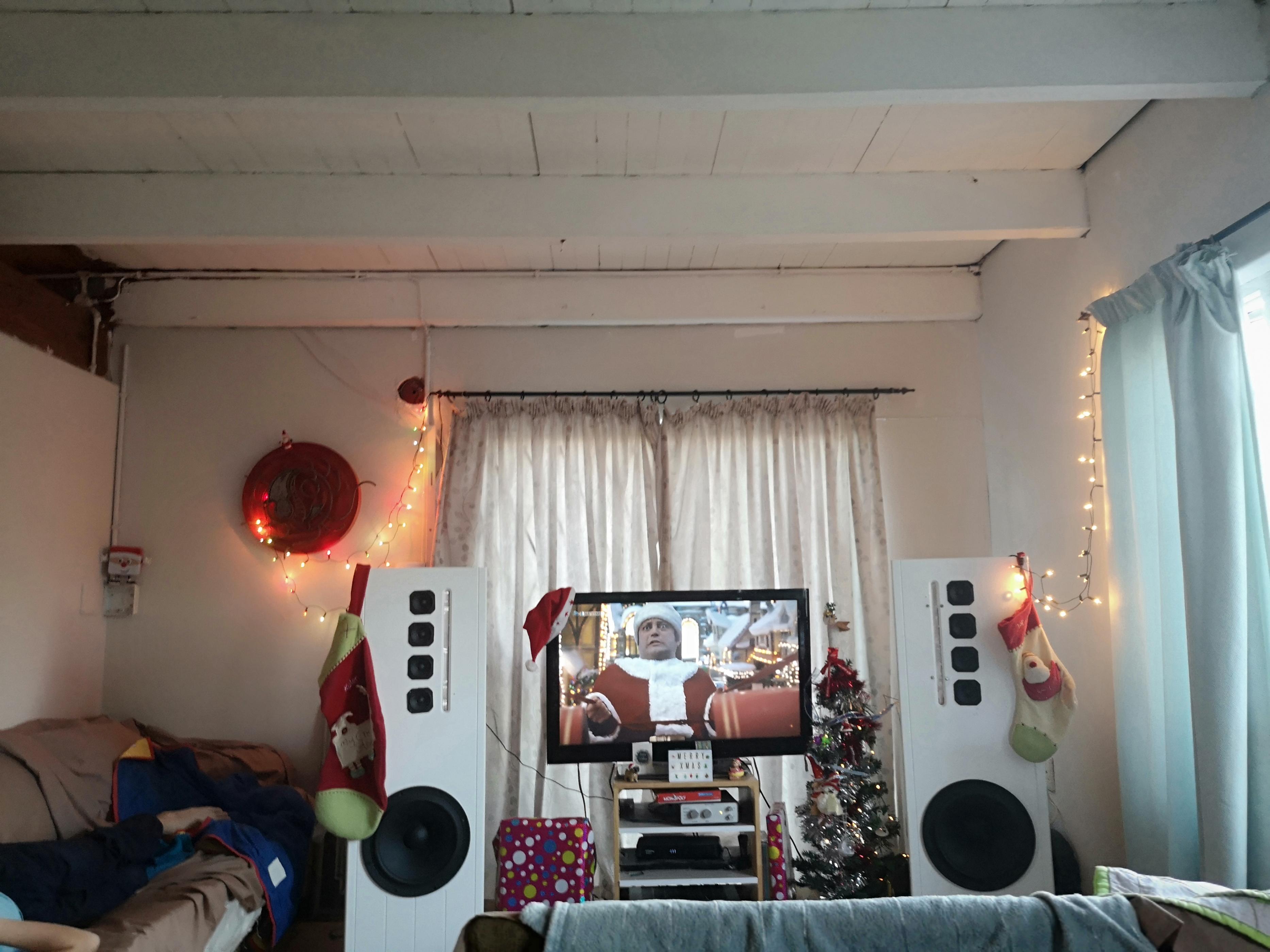

I am using those same drivers he is using in the Trio those peerless drivers are mind blowing for usd12 is an absolute joke. Iv heard drivers costing 20 times the price and they still not as natural and flat. All I have in the xo is a baffle step which consists of a 1mh coil and 22ohm resistor across, a 100uf cap, a 0.2mh coil to roll off at 6khz where I xo to my ribbon. Iv owned a number planar speakers namely, Maggie's, apogee, s and eminent technology and these boys can certainly give you that beautiful natural open live sound.

I haven't really noticed but I must admit I am not really sliding horizontally when I'm. Listening lol. Look there ar e many compromises but what I can tell you is the peerless is a superb driver that can basically run full range as at times I disconnected the ribbon. The Beyma is a well respected ribbon that's for sure but don't underestimate the peerless it can run very high. I am. Using a simple first order xo on all drivers my only challenge was trying to find the best place to xo the ribbon. I think active would be first prize as it wont take long to dial them in. I would like to build on this design and do at least 12 of the peerless per side. There is a company that apply a similar science but monopole namely scaena they use a similar peerless driver and
Run it from 110hz to 5khz and then to a ribbon.
