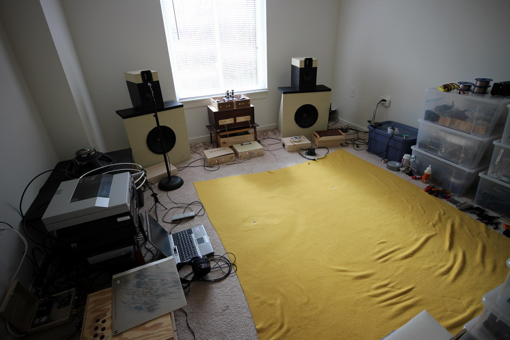

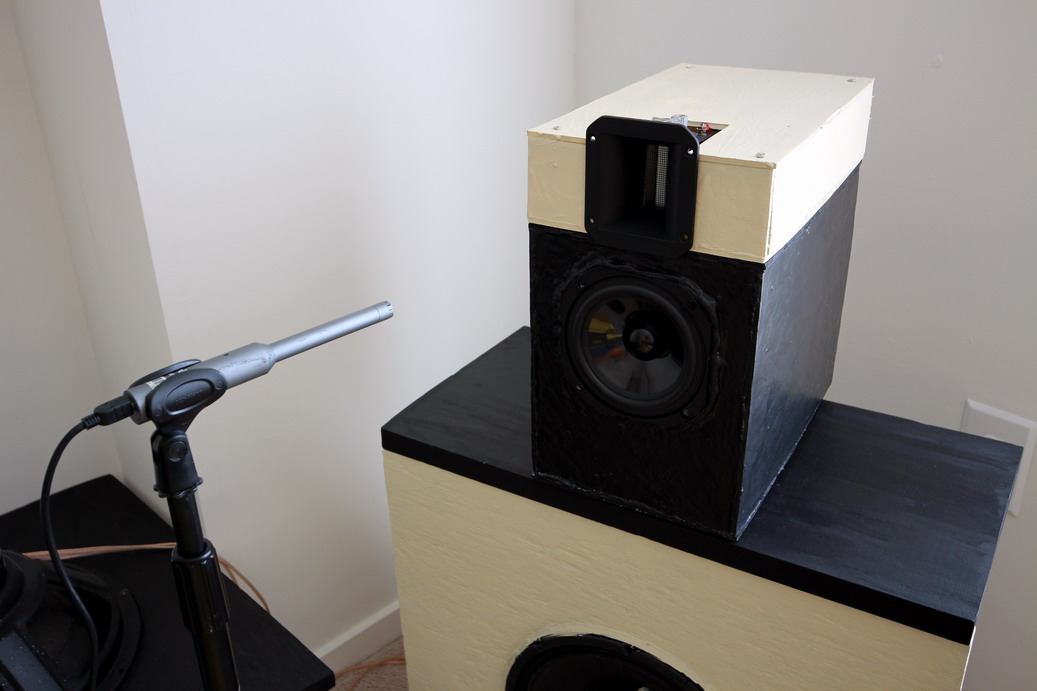

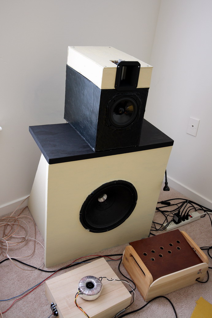

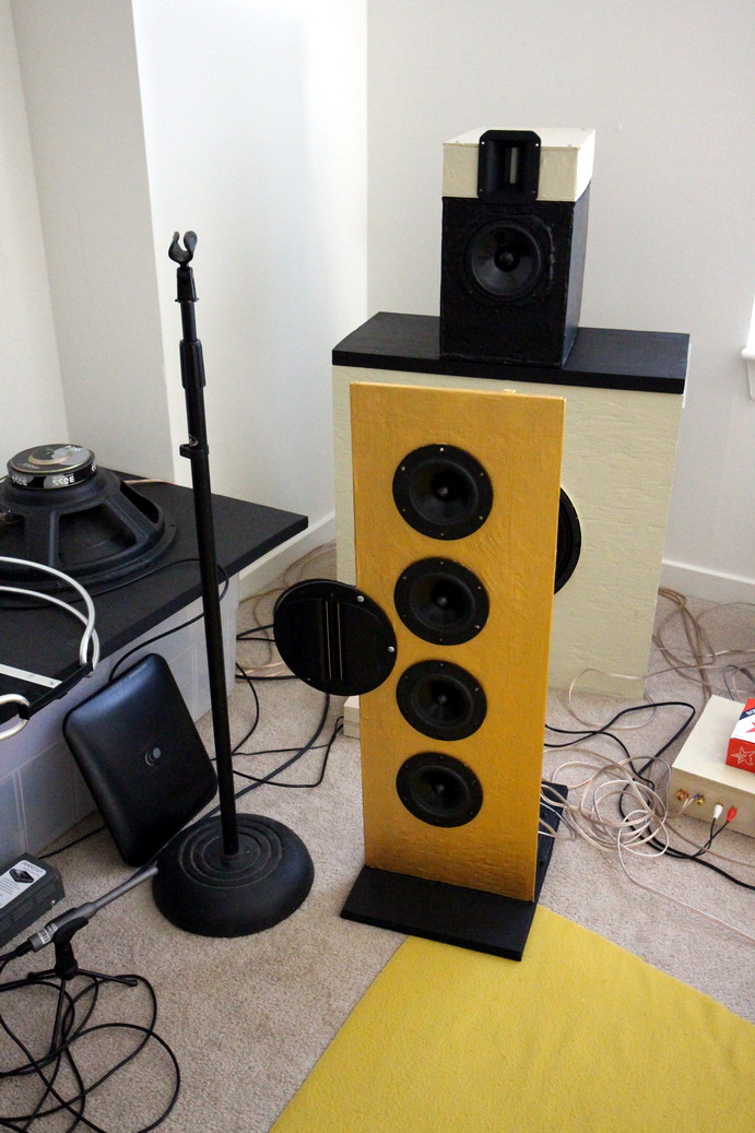

I have recently finished this little bookshelf (no need for separate thread, there is plenty like it). AC130F1 in closed box with Fountech horn loaded ribbon tweeter. Great sound. I use it with subwoofer, with high pass ~150Hz.
Nice work Adason. That AC130F1 is very smooth - I have same driver and it sounds very nice. That XO looks fantastic - what are the values? Maybe a tad more reduction of HF's to flatten it out vs the 5dB gradual rise you have.
Good thing you are XO at 150hz as the AC130F1 has rising distortion below this when used in a sealed box. If open baffle, or vented then much cleaner. It doesn't like compressed air behind its cone.

Thanks X, for values I need to be home and open the box with crossover. I have variable resistor for bsc, so I can adjust. The slight rising response up close is quite flat in listening position.

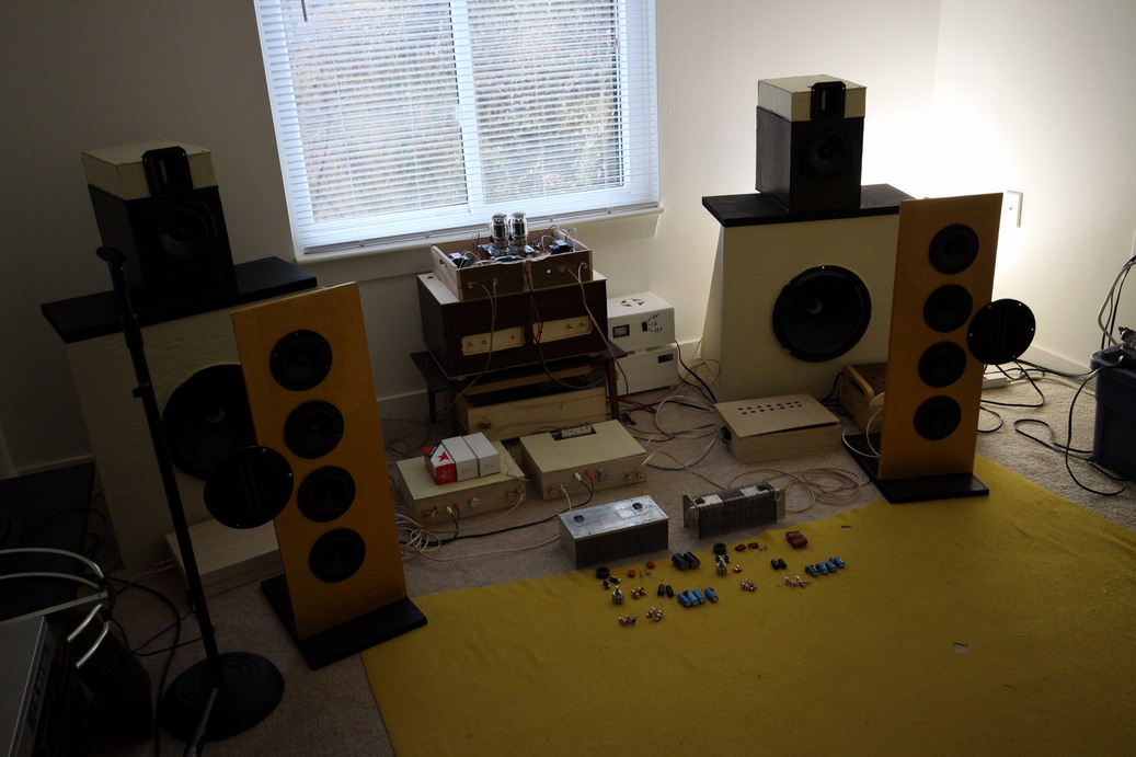

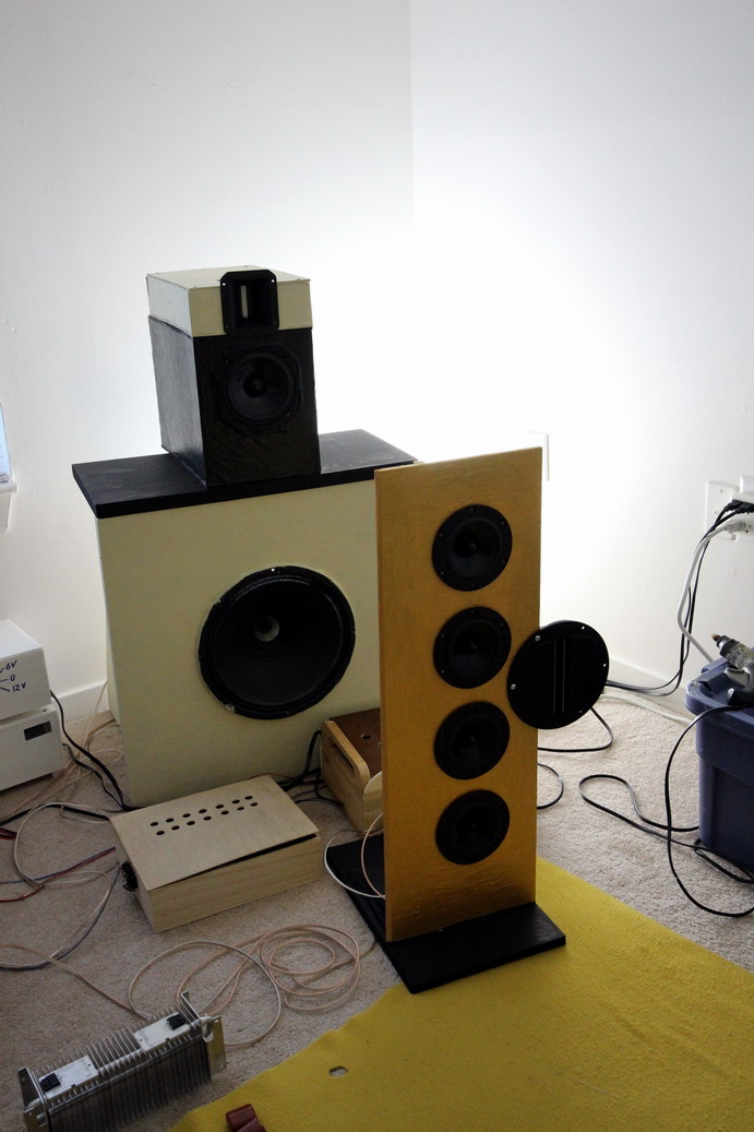

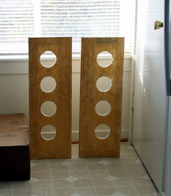

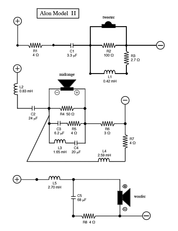

I never tried AC130F1 on open baffle. Have you? The cone is quite soft, so using as midrange is preferable. Perhaps Alon Model II clone?

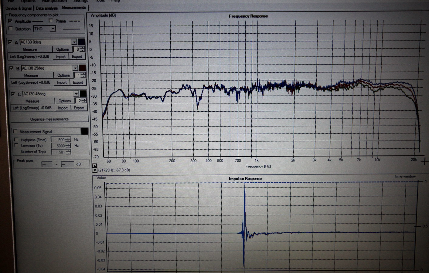

330Hz corresponds to 40in distance from the cone to some surface that is causing a reflection. Either the floor or the back wall. The AC130F1 doesn't have a native dip there though. I have tested it in open baffle but not used as a speaker in OB. It measures very well and should sound nice as an OB mid range.

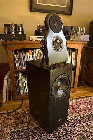

Alons are very nice speakers. I have a friend who uses them as studio reference monitors. These are the ones with a 5in OB midrange, a sealed dual 8in woofer, and a softdome tweeter. So they are same designer as NOLA's?
Carl Marchisotto. He started with Dahlquist back in the 70s, stayed there until the late 80s when Jon Dahlquist was badly injured in a car accident and was forced to sell the company. Started Acarian Systems (Alon) shortly after, then left to start Nola in 2004.
series crossover with just a 2.2uF cap and 0.22mH coil
