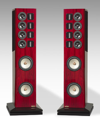

Every time I visit audio show, like Rocky Mountain...or Capital audio fest, I always like the sound of NOLA speakers. Formerly ALON.
Mr. Marchisotto, from Dahlquist fame, is a veteran when it comes to the speaker design. He has been using open baffle midranges for decades now. I do, and many other here, sure like open baffle midrange speakers.
Question: does any of you have any specific knowledge about any of these speakers? Crossovers?

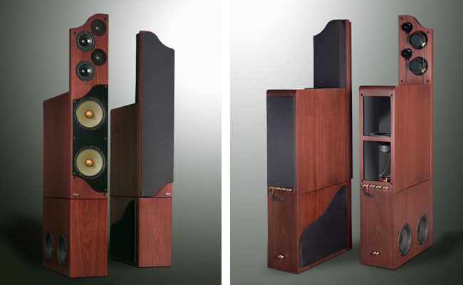

But there is another interesting speaker set, much more highend, which you guys may enjoy to disect!
I'm glad that they sound good! Obviously sales numbers are limited and rare exports.
Some serious problems or at least challeges can be seen from the layout and mix of drivers - radiation patterns. Certainly not targeted for mass markets.

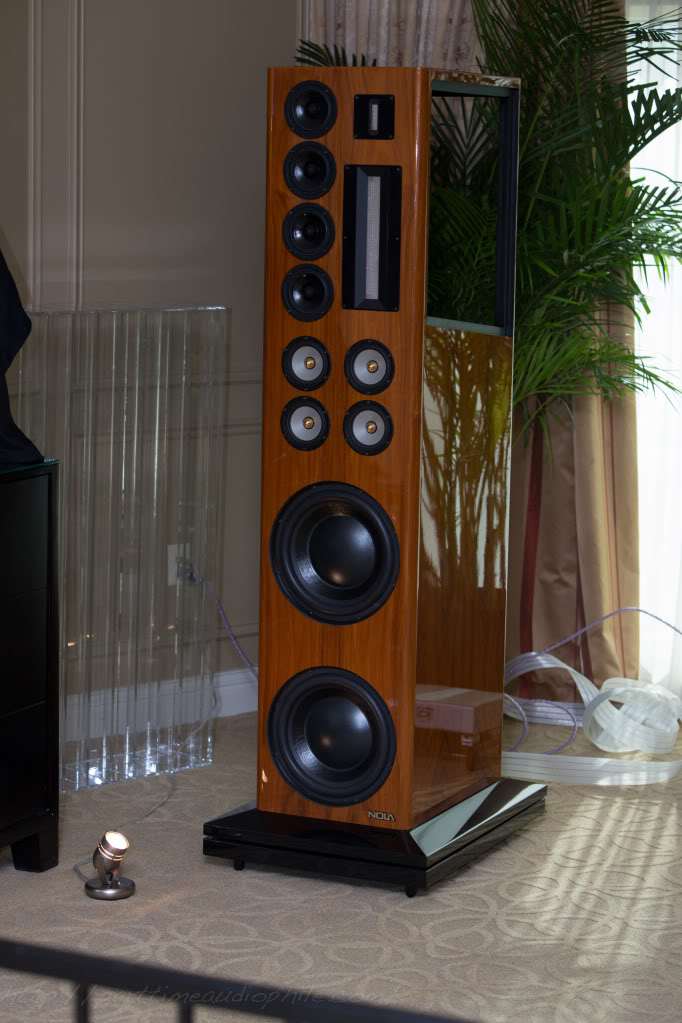

Juhazi, they always sound "musical". That is the way to describe the sound of NOLA. I found this true for all their models. Obviously, designed by one person, but still, there is something to make sound coherent. When I listen to other brands, I often hear high end speaker, but I am aware I am listening to the recording. It may be precise, but still recording. Nola speakers always sounded like real instruments. That's why I would like to learn more.
I've heard the NOLA speakers once or twice at shows. Crazy looking things. I don't actually remember how they sound, but must have liked them because I do remember chatting with the lady in the room and complimenting her on the sound. 🙂

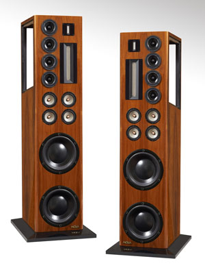

3) Speakers (that I am interested in) sport short vertical line array for midrange/tweeter to minimize reflections from the floor and ceiling.
4) Only midrange section is dipole, as I have not seen any tweeters pointing back.
Others, feel free to chime in. I do not mind talking to myself, but I would love to see the crossovers, as I am interested to see the slopes and other stuff...

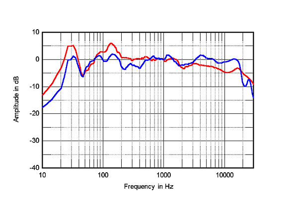

I don't know if NOLA speakers carry same desing principles, but this report might give some idea. Nearfield measurement of dipole(-ish?) bass is tricky. Mid-tweeter xo is obviously very steep. Atkinson was perplexed. Room response looks very nice anyway (red line).

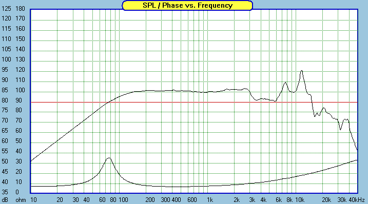

Just a brief update, mostly for myself. I created small narrow baffle, not much bigger than drivers itself, from two foam core boards, laminated together, and some braces in the back. Light and quite stiff.
I connected 4 midwoofers series parallel, to get ~4ohms. I measured fr response, was very close to posted by John K. Not as pretty, but similar. I high passed the midwoofers with minidsp at ~160 Hz and listened for a while. Sounded boring.
I constructed 4th order LR filter, even I did not have precise values of caps and inductors, just temporarily. I re-measured the response and got what I needed, pretty steep rollof after ~3kHz, even the parts were not very precise. I listened a little more, and it sounded even more boring.

It would sound very full and powerful. With dipole midbass and what looks like side firing bipole sub woofers, open baffle mids and tweeters. My concern is the possible comb interference with two widely spaced tweeters and mids on the top. I assume this is all active as a passive XO for this would be kind of epic.
Have you heard this system in person?
