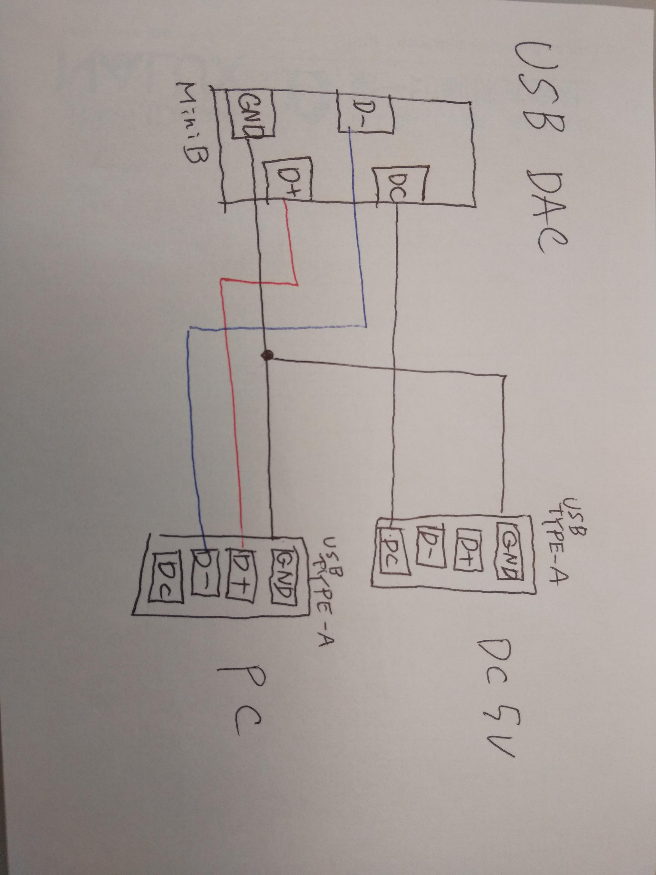

USB has GND,+,-,Power supply.
For PC power supply noise,
I have made cable to split signal and power supply.
Because my DAC(D70) dose not notice without power supply(Some does).
DC5V connected with battery.
It improved sound a lot.

video1: my 2 cents the noise is gone because you are using proper XLR - XLR connection, without the ground currents getting mixed with the signal currents.
I wonder if you tried your previous cable + 6.3->3.5 adapter into the 6.3 headphone output, if the noise remained. Please can you check it as it could help others. Thanks.
