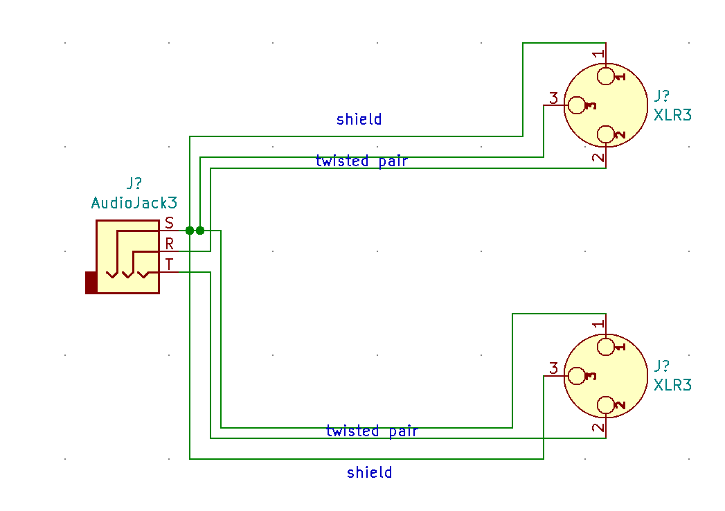

It's a 3.5MM plug exiting the Dragonfly into the L & R inputs of the subwoofer. The Sub has L & R XLR out into the L & R XLR in of the desktop monitors.

I'm confused. So you're saying I need one 3.5mm to XLR cable for each channel? My problem is the Dragonfly USB output is a single 3.5mm female plug. Do I need some sort of Y connector and if so, wouldn't that cause the same issue?
My fault, that drawing is for balanced - balanced connection. I made an ugly drawing in kicad - you need two shielded balanced cables (microphone cables, a shielded CAT5 cable would do too). If both of your sides are grounded, the shield may not be connected on one side, but I would start with connected to be sure your device ground potentials are aligned well.
OK I think now it's starting to make sense. I have very limited electrical knowledge. It looks like you've got two (one for each left and right) XLR cables terminated to a TRS 3.5mm plug. The grounds and negative of both cables are joined together at the TRS plug onto the sleeve connector, while each L & R positive goes to the Tip and Ring of the 3.5mm TRS.
Have I got that right? This way there is only one common ground.
The problem with nonbalanced connection is the ground line which carries both the return current of the signal (every transmission must have two wires) and the ground-loop current - the current aligning different voltage potentials on each side of the transmission line. The ground-loop current sums with the return current of the signal, thus becoming part of the signal itself.
Proper unabalanced-balanced connection carries signal return currents via an individual line - the cold line of the balanced input, and aligns the different potentials via a thick separate cable - the shield of the symmetrical cable. If the two devices have their ground potentials aligned via a different path (e.g. both use the protection-earth wire connected to 0V of the signal - as they do here otherwise no ground loop would exist in the first place), the shield can be connected only on one side.

That's kind of what I figured. My conclusion is that I have a ground loop. So I have two ways to eliminate that:
1) build a new 3.5mm to XLR cable that has only one common ground
2) buy a new DAC that receives the USB output, and from there it can ouput to XLR.
I intend to try both solutions. I also have various USB filters that I've ordered.
video1: Why don't you try the correct unbalanced-balanced wiring, e.g. to minimize costs by using cut-open connectors from your existing jack-XLR cable? If it does not help (which I believe it will, as it did to me and a few other people here), you can start spending on a different gear.
Even though I ordered the SMSL SU-8, I intend to try your solution using single common ground. I do believe you are 100% correct about having a ground loop in my current setup. Thank you for the advice. I really appreciate it! In fact all the folks who replied have offered excellent advice. Great forum!
