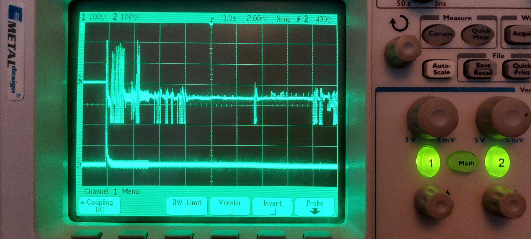

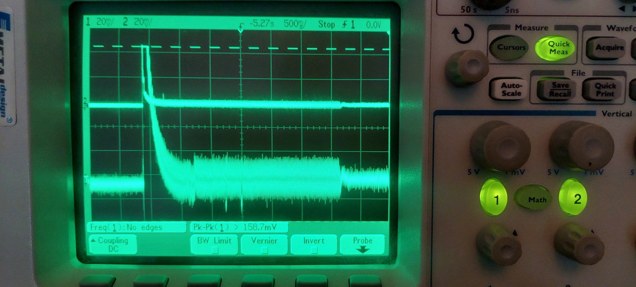

Illustrating that conclusion, let's start with the right speaker output at startup when the bridge between the preamp and the power amp has been removed:
The startup noise seems to be absent. (although that right spike looks like the intermittent noise I'm also experiencing but I'm hoping that fixing the startup/shutoff noise will fix that as well or perhaps adjusting the DC offset. In any case, one issue at a time)

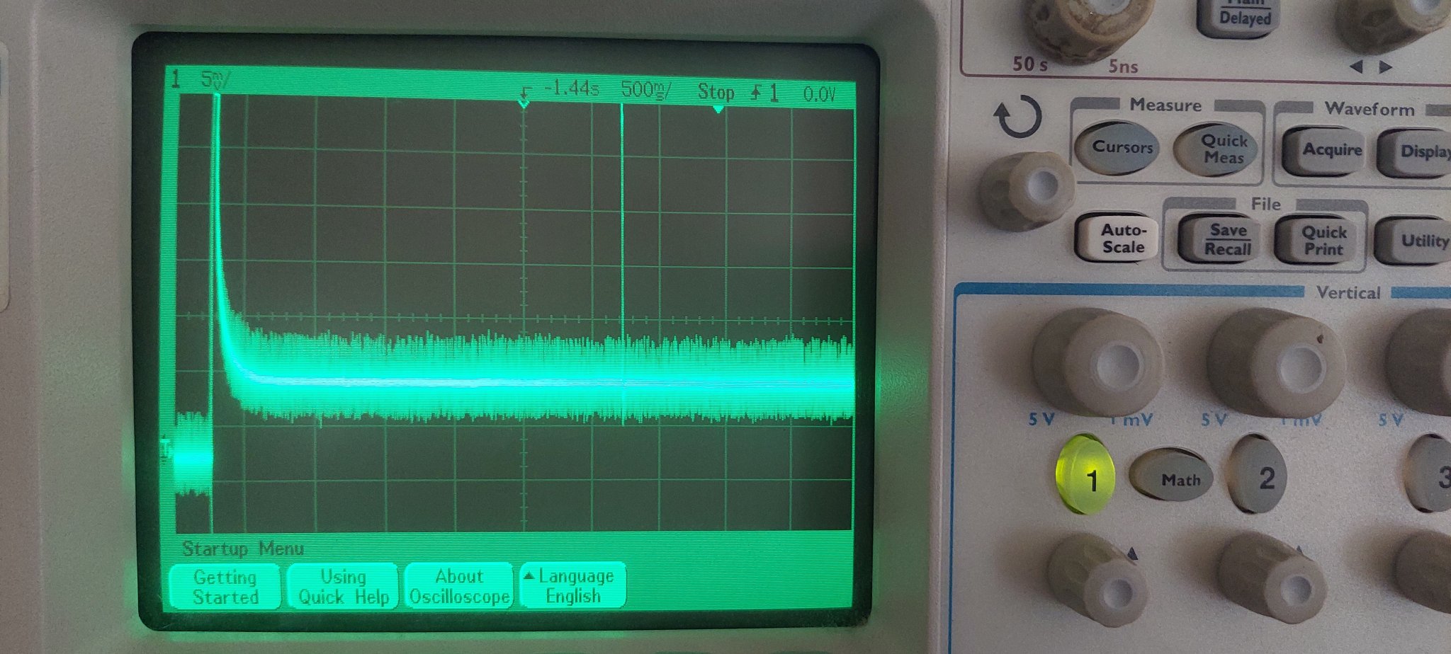

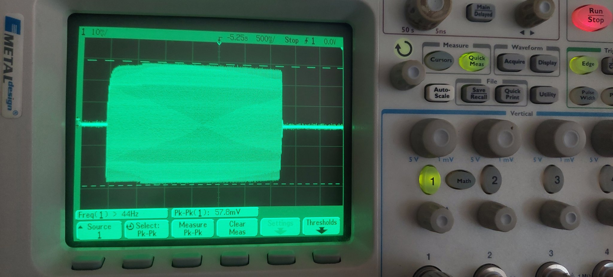

Conversely, here's the right preamp channel at startup:

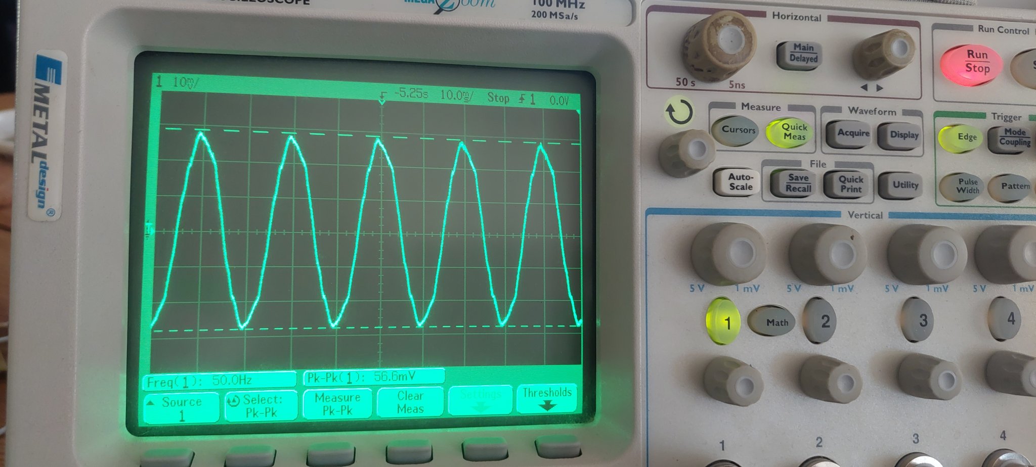

We can see by zooming in that it's a 50 Hz sine:

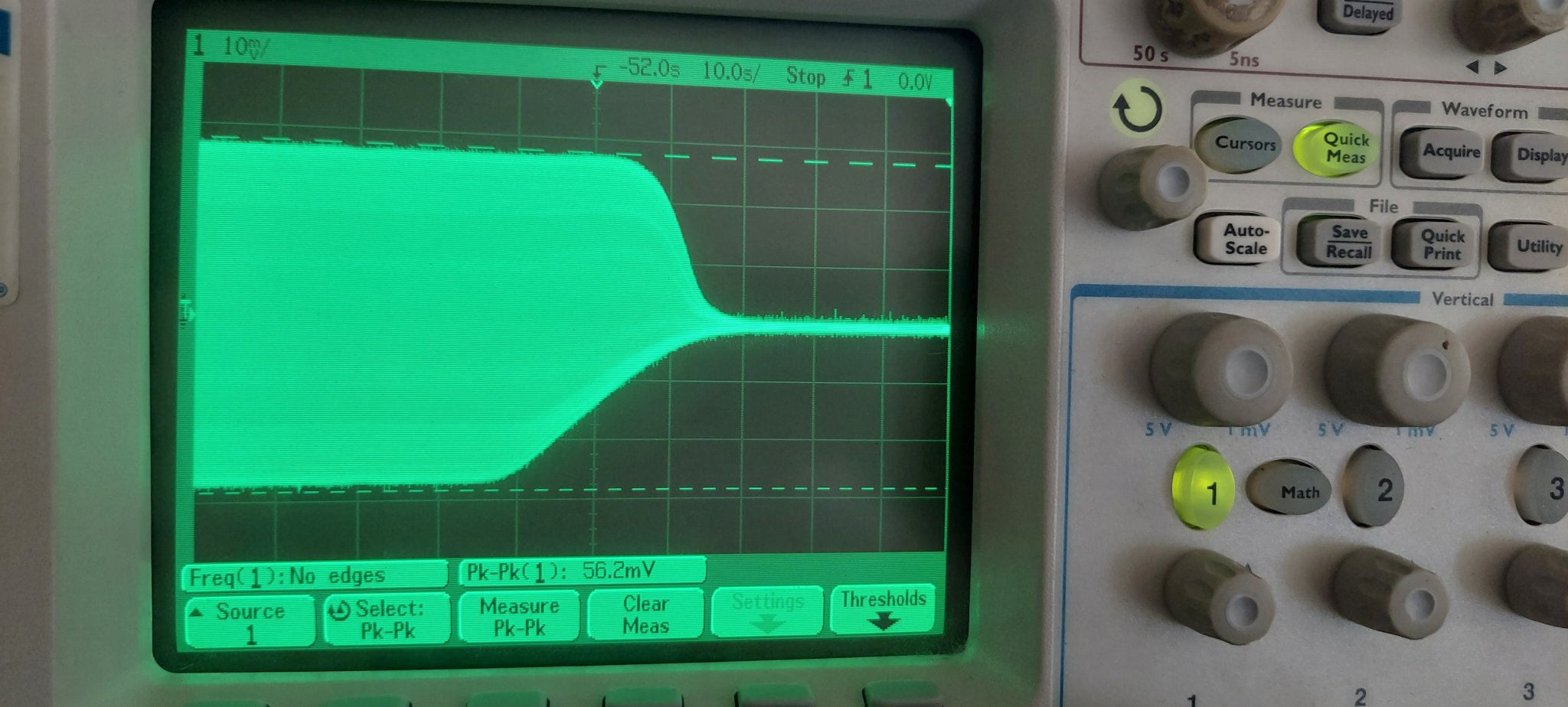

Interestingly, measuring the same right preamp channel at shutoff shows the same sine but it lasts about 2 minutes before tapering off like this:
which feels a bit like a capacitor discharging.
Here's the waveform zoomed in in the middle of the taper:
Not sure what more to make of this but I'm looking forward to hearing your thoughts on this @Jakobsson @kapitiaudio
