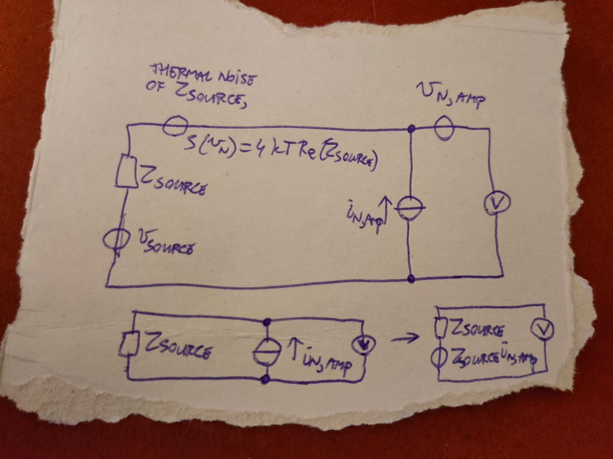

Sorry, I cannot understand your idea.Even with a 0-ohm source resistance, the device has it’s inherent self noise which is all voltage noise.
Between 0 Ohm source resistance and 0 Ohm ground we can only speak of current in form of a loop. I guess it is very hard to define voltage precisely and correctly for this case. Hence, for myself, I would better think of current noise. If I am wrong, please correct me. A bit of fundamental equations are always welcome.
Think of the voltage noise of a device as being in series with its input, internal to the device.

If I understood correctly, this is the standard description of the problem for Rsource. With this translation the source becomes ideal.
Can you try to explain to me the use of |Zsource| in current noise? I am stuck in this point.

The voltage induced in the input caused by the device current noise is Zsource * Inoise, but we don't care about phase since the noise is uncorrelated with anything else, so only the magnitude of the source impedance matters. Hence |Zsource| * Inoise.
For source Johnson noise only the resistance of the source contributes though, so you do have to know the source complex impedance to know both Rsource and |Zsource|

You are confusing the noise of the source impedance with the effect of the source impedance on the transfer of the noise current of the amplifier.
Upper schematic: signal source, three noise sources, two of which are the equivalent input noise sources of the amplifier, and a voltmeter that represents the amplifier input.
Using superposition, you can look at the effect of the equivalent input noise current of the amplifier separately, leading to the bottom left schematic. (It's actually slightly more rigorous to use Blakesley shifts, but they don't fit on the piece of paper. The result is the same.) A plain old Norton-Thevenin transformation leads to the bottom right circuit. Over a bandwidth narrow enough to assume the source impedance constant, the RMS value of Zsource in,amp is simply |Zsource| times the RMS value of in,amp.

Open point (for me to understand) remains the use of Zsource.

Extreme example:
Suppose you had an amplifier with only equivalent input noise current, so no equivalent input noise voltage, and an infinite input impedance.
Now connect it to a purely capacitive source. The source then generates no thermal noise at all, the real part of its impedance is 0, the magnitude is not.
The equivalent input noise current, source impedance and amplifier input can be represented with the parallel connection of a capacitor, a current source and a voltage meter. Will the AC voltage across the voltage meter be zero or nonzero?
The noise current wll flow through your input impedance and create an according noise voltage drop that will be amplified.

The voltmeter will read (|Zsource|//Zin)*Inoise (f).The equivalent input noise current, source impedance and amplifier input can be represented with the parallel connection of a capacitor, a current source and a voltage meter. Will the AC voltage across the voltage meter be zero or nonzero?
Why should I care about this voltage? In this case (infinite Zin) is it not important the current noise only? If one end shows infinite Z, then there is no current either.
Ok, I think I got it. This is a way to translate the input current noise in a voltage form expression. This voltage is pure statistics fluctuations (noise). I must assume zero correlation time and zero time of propagation (essential for insuring stationary adiabatic//Markov process). Then this current/voltage can be expressed as a diffusion equation 'per instant' (when Zsource and Zin are not equal) or as quantum fluctuations. (Note: I think that in reality the c-limit and non-zero correlation times will transform it into a non-stationary hence non-adiabatic process, which do not have the same expressions.)
