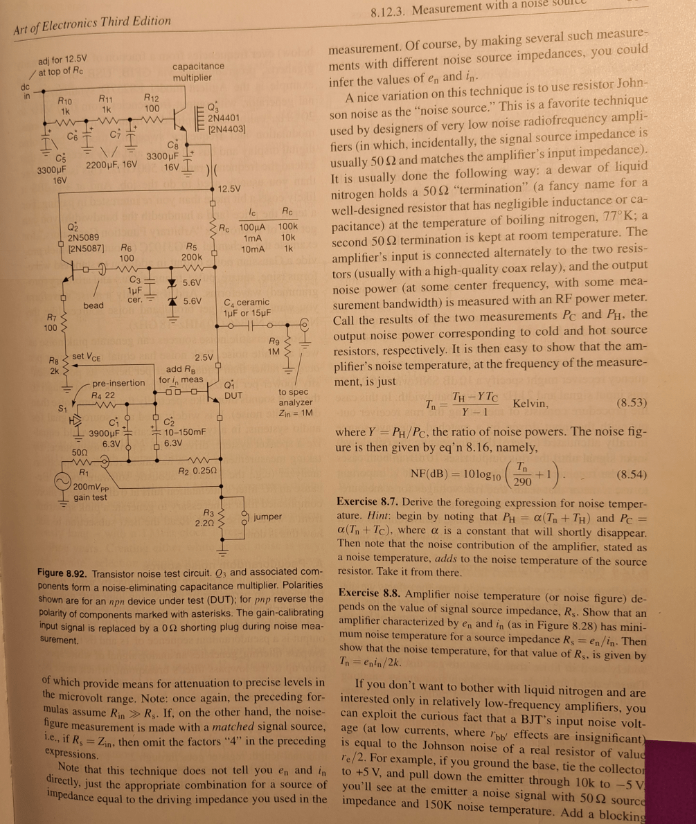

Upper schematic: signal source, three noise sources, two of which are the equivalent input noise sources of the amplifier, and a voltmeter that represents the amplifier input.
Using superposition, you can look at the effect of the equivalent input noise current of the amplifier separately, leading to the bottom left schematic. (It's actually slightly more rigorous to use Blakesley shifts, but they don't fit on the piece of paper. The result is the same.) A plain old Norton-Thevenin transformation leads to the bottom right circuit. Over a bandwidth narrow enough to assume the source impedance constant, the RMS value of Zsource in,amp is simply |Zsource| times the RMS value of in,amp.

I normally calculate with power spectral densities that may or may not be frequency depent. To get an RMS value, you then have to integrate over the frequency range of interest and take the square root.
If you really want to know the physics behind it all, you should read Aldert van der Ziel's famous book Noise. Most of it is well above my head, but it's probably what you are looking for.
For a mere electronics engineer such as myself, it suffices to know that thermal noise is not really white (it would have infinite power otherwise), but white to a good approximation as long as you are not making microwave circuitry working at cryogenic temperatures. Something similar appiies to shot noise: it is approximately white as long as you are not combining very high frequencies with very low currents.
