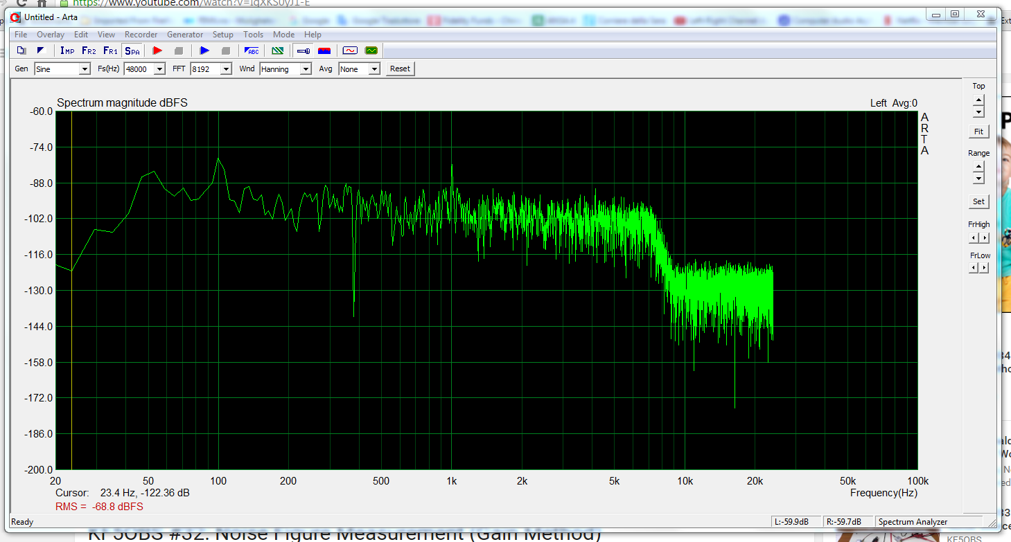

i am attaching a noise spectrum of my usb headset ... am i on the right way ? 🙄
As i said above my main goal is to measure noise in usb audio interface.
I guess this is the 1st step.
Second one will be to try some distortion measurements.
Next year ... 😱
Thanks a lot indeed.
Regards, gino

Hi ! i want you to get graph of noise from usb audio interfaces.
Later i will try some distortion measurement.
This SW looks quite ok. But i have to learn the basic.
The graph above is taken from my usb headset/mic.
But i have already tested also a Roland Quad-Capture usb interface ... it is quite silent if i have done the test correctly.
I will post the graph soon.
The idea is to use this SW to see if i can erase those famous bumps in the noise floor of my other and better Tascam interface.
Thanks a lot again, gino

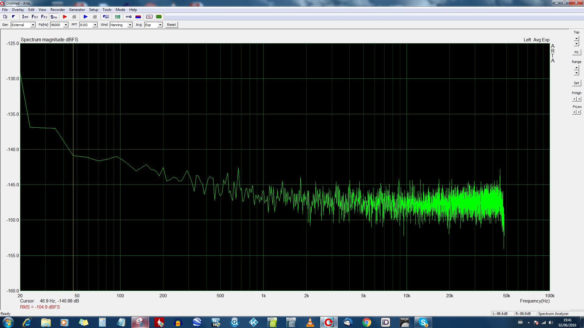

In an indirect way I can also test power supplies looking at the overall noise floor of the soundcard.
I am attaching an example of the noise floor of the soundcard obtained with Arta (inputs and outputs open; gain at zero).
