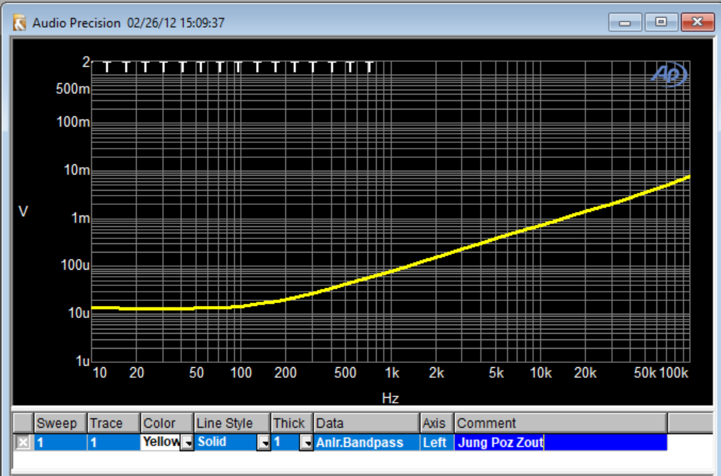

With the modified design, the impedance goes even lower😉.Here's the Jung SR Positive reg, y-axis is "Ohms"

ok low impedance is good, but what does it mean to the output noise? it does not fix the noise of the internal reference right?With the modified design, the impedance goes even lower😉.
noise relates to the Vref noise, the error amplifier's implicit noise and amplification factor.

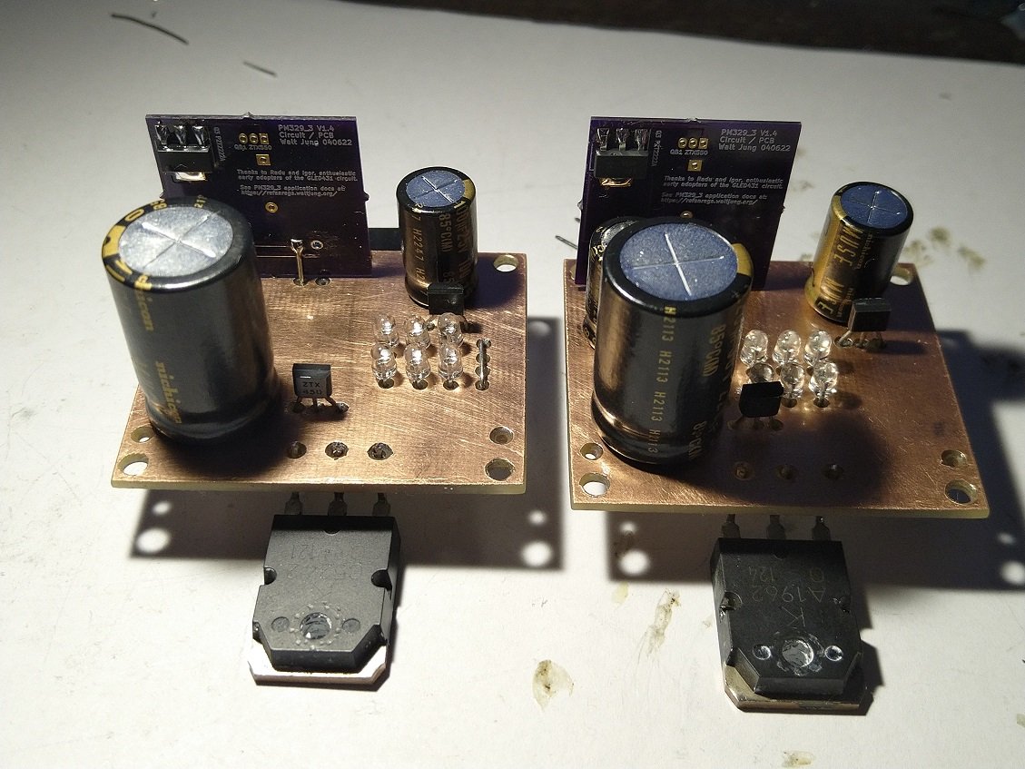

With shunt regulators like Salas' UBiB, we have only 420 nV total noise in the 20Hz-20Khz bandwidth. Measured, no simulation phantasy involved.arent we talking about noise?
https://www.diyaudio.com/community/...-ultrabib-shunt-regulator.322411/post-7391190
With Jung-Didden super-regulator and adequate opamp choice, we have just a little more.
https://www.diyaudio.com/community/threads/super-regulator.247281/post-7263619
There aren’t many audio applications, voltage references excluded, where those noise level are not adequate.
