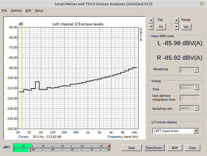

As I mentioned before I think you are barking the wrong tree by putting your efforts on extra low noise measurement.
With the EMU USB soundcard I measured the 7818 linear regulator (left input channel)
So I tweaked it with the help of this measurement setup.
As a result the switching regulator now outperforms by far the linear regulator in the most audible mid range
  • 104dbA_Noise_LM5019_220uH_Ron_470k_input_30V_load_200R_Cout_1000u_50V_loRippleComp_Rlo_100k_C1...png
