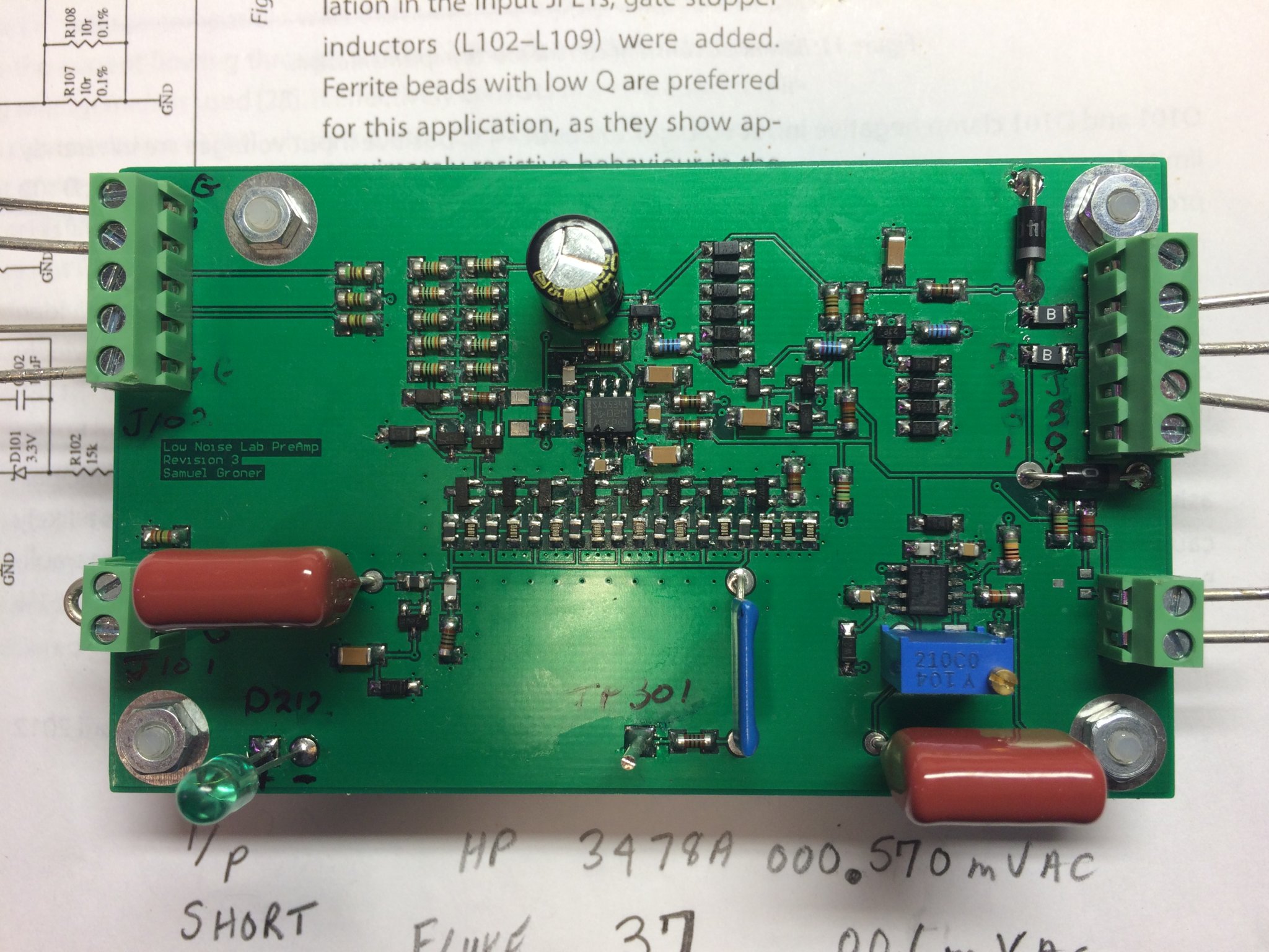

Noise Measurement Amplifier

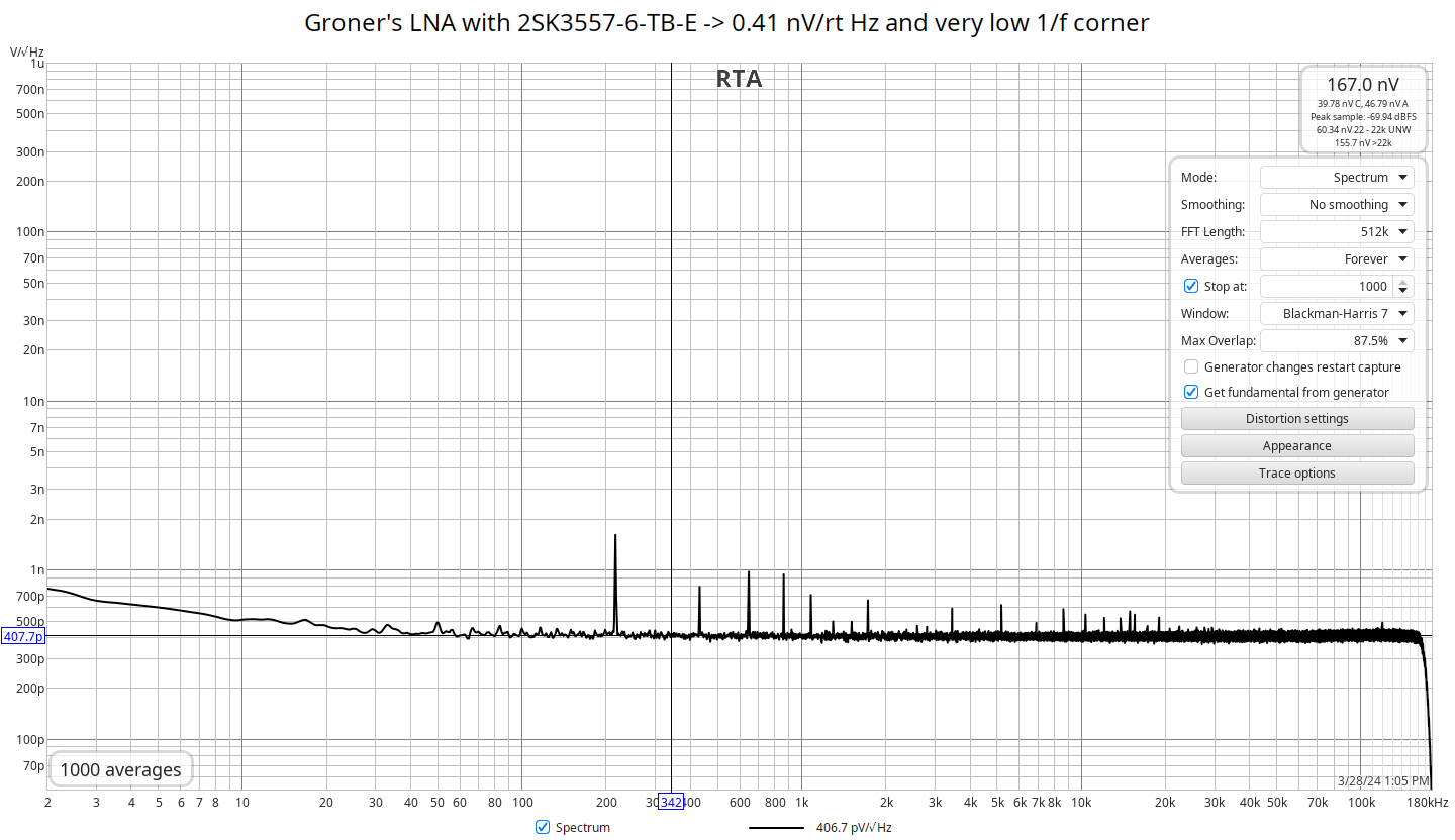

BF862 is a RF jfet as well but that’s what Sam chose to use so I followed along.
So is 2SK3557-6-TB-E, intended for RF, to bad no 1/f graphs in the specs.
Maybe 2SK209 is a better choice since it’s not an RF jfet.
