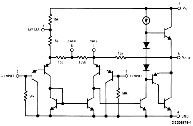

OK, now that the grounding is hopefully taken care of...
3- See number two that circuit didn't call for them. Is the bypass capacitor pin 7 for input noise? I can maybe ad hoc them on to the board.
I would recommend doing so.
This is one of those cases where it pays to look at the equivalent circuit in the datasheet.
attachment.php
The input stage looks like a Darlington LTP job, but actually the left-hand half of it is merely being used to set up output DC levels and as a level-shifted ground reference, with the other half forming a current feedback amplifier. The trick to setting up output DC is employing a current mirror. Therefore the voltage over the 15k resistor between Vout and GAIN I is always going to be half that over the two 15ks on the left that are split by the bypass pin connection, and with no signal input, Vout becomes
Vout = V(+in) + 1/2 (Vs - (2Vbe - V(-in)))
or with V(+in) = V(-in) = 0 V:
Vout = 1/2 Vs - Vbe ~= 1/2 Vs - 0.6 V
This relation holds at both DC and AC, so that half of any power supply hum and noise voltage will find itself on the output as well. Hence output PSRR is all but 6 dB, for an effective input PSRR of 27 dB or so.
The bypass pin capacitor filters out AC components on the supply, so PSRR is much improved.
You can actually coax the LM386 into working sort of like a conventional voltage feedback opamp (I've played with it in simulation for a bit), but you'll have to wrestle some stability issues in exchange for markedly improved distortion performance.
