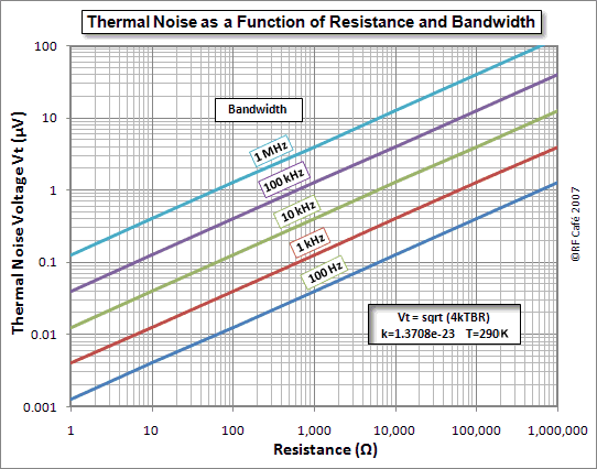

If you build with the wrong resistors, I can see Johnson noise, but we have resistors now less than 200 ppm so a lot of that theory doesn't apply anymore
See here. Notice that the formulas only have R (and nothing else) about the resistor.;
https://www.rfcafe.com/references/electrical/noise-power.htm

In order to know what's important, you first have to know the theoretical limits.
This graph is for theoretically ideal resistors.
From https://www.rfcafe.com/references/electrical/noise-power.htm :

Basic theory (like Johnson noise) always applies. But theoretical limits can far exceed some practical limits.
For example, we can hear down to around 0dB spl, but you'll have trouble finding anywhere nearly that quiet.

I think the point being missed is that "low self noise resistors" do not evade Johnson/Nyquist/thermal noise, which is fundamental. They can minimize excess noises, which are related to current passing through the resistor, but even a "perfect" resistor with no excess noise will still have RT noise.Who really cares about Johnson noise. Its not going to be a main part of the signal. If you are so worried about it get low self noise resistors.

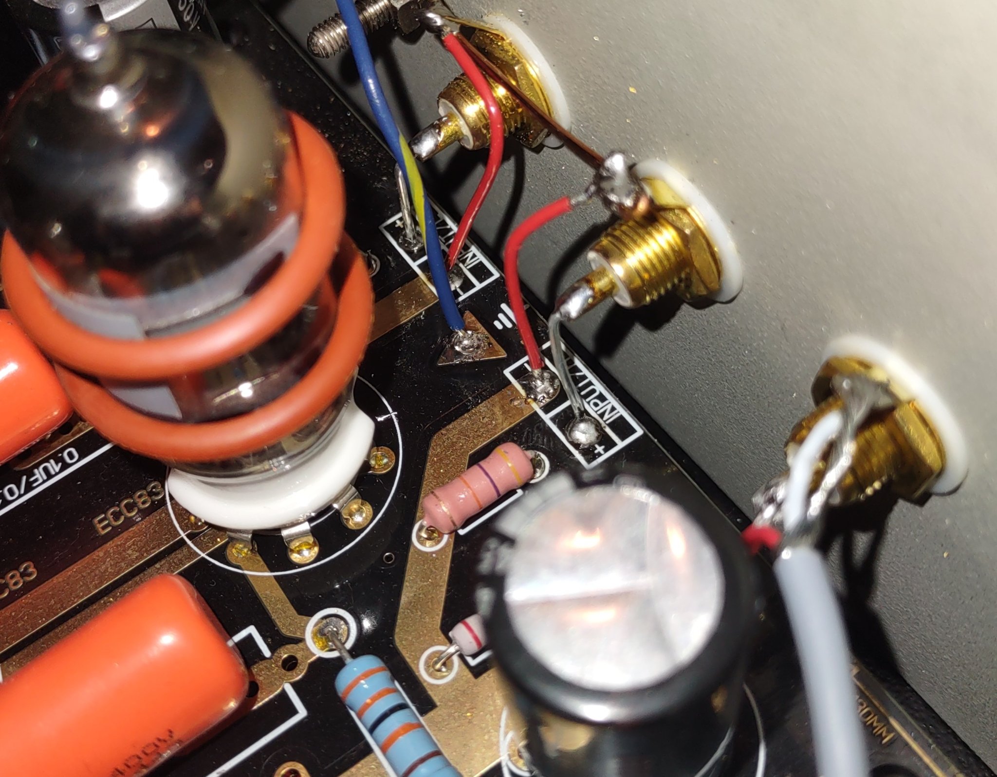

The device in question is a 834p clone built on the Douk board according to the LHTR specs. It's a tight fit in the enclosure and the input jacks are connected to the PCB with two pieces of .999 silver wire about 1" long.
I'd like a discussion of best practices regarding noise in the wiring of the inputs of a phono pre to fight noise. I live in an urban area with gobs of all types of RF, and I'd like to know the best ways to avoid, reject, cancel, etc that noise. Grid stoppers are a good way in guitar amps, but I don't want to lose any more signal than absolutely necessary in a hi-fi amp.
Ferrite beads, extra inter-electrode caps and other things that can be done to the input wiring/PCB seem most attractive. Cutting traces and modifying the PCB itself is less desirable, unless the outcome is superior. Same goes for altering the TT.

Nothing strikes me as terrible, the board may be working against you to some extent.
I would start by adding at least one 0.1uF cap from your GND buss bar to the chassis. Next I would consider removing the copper bus depending on how the GNDs are arranged on the board.
Finally I would add a ferrite on the signal lead between the jack and board.
Nothing looks terrible BTW or particularly unreasonable so I would also look at better interconnects to your TT.
You wouldn't happen to have a photograph or two of the pcb that shows how the traces are routed.
You can also add up to something like 220 ohm resistors right at the input grids - 1206 SMD resistors are ideal, just cut the trace very near the grid pin, scrape, tin and them solder the resistor in place. SMD resistors are ideal as they have low parasitics compared to leaded parts. (Panasonic, Beyschlag/Vishay, or Yageo thin films are what I would recommend.)
I would not connect the chassis directly to the PCB in most cases, but I don't know enough about your build to know what I would recommend. (PSU in the same box, safety earth?)
