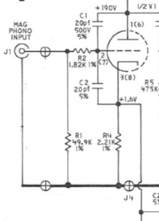

Its because of the hi gain design and lack of a real input circuit, causes the grid of the first tube is acting like an antenna.
Looking at the schematic, it should be changed to this standard input circuit:
Wow, thanks! Familiar with the grid leak resistor and the grid stopper, but never seen a pair of 20pF caps used like that.
Good thing I still haven't placed that order to Mouser, gonna throw some 20pF in there.
Actually it was very common for enhancing the RFI snubbing. that normally occurs when using a grid stop. It was common in a lot of circuits, including all tube television to prevent the horizontal high voltage section from becoming an RF amp from the RFI.Wow, thanks! Familiar with the grid leak resistor and the grid stopper, but never seen a pair of 20pF caps used like that.

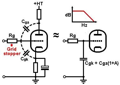

So the grid stopper is more important for blocking the noise. What's the function of those 20pF caps? It's hard to implement a grid stopper in a PCB-based design.
w
w
RF interference rejection.So the grid stopper is more important for blocking the noise. What's the function of those 20pF caps? It's hard to implement a grid stopper in a PCB-based design.
