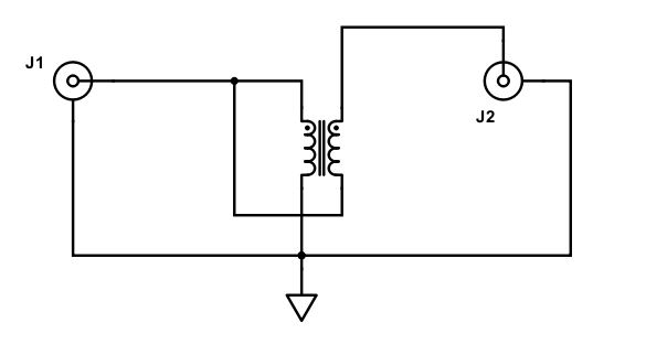

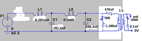

@ abraxalito
I want to use the 1:1 OPT for a gain of 6dB (attached pic), could still use your filter without modification?
  • 50 ohm characteristic impedance 4th order low pass filter con tx 1=1 600 ohms.png
