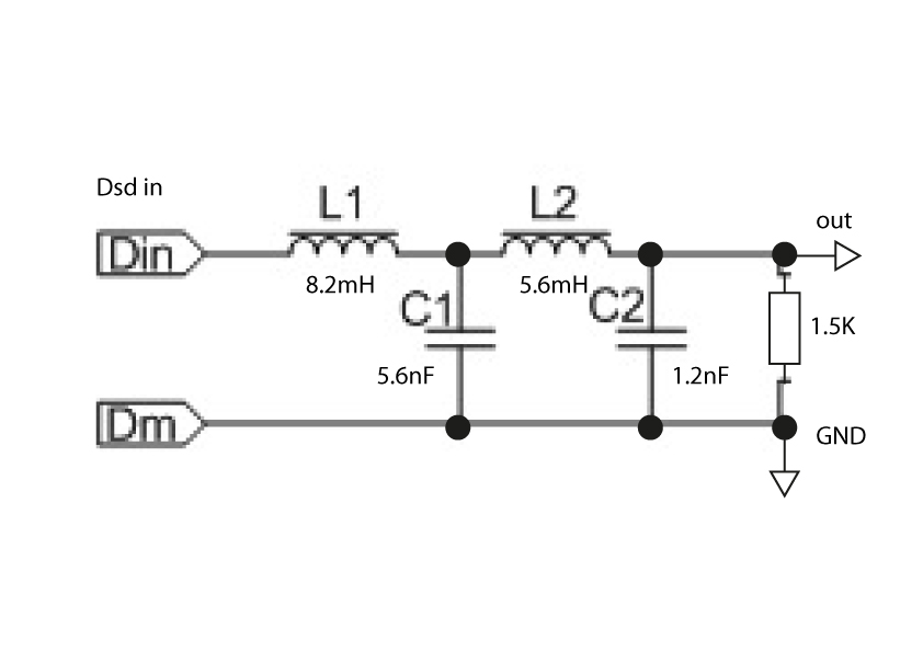

About step up transformers I guess I need 1:1.27 my calculations:
0.56Vrms = 1.58Vpp
0.71Vrms = 2Vpp
So I need to increase 0.15Vrms to reach the 2Vpp, it's OK.
Also I need an OPT with primary impedance of 50 Ohm & a secondary of 63.5 Ohm
Are my calculations OK?

Are you sure you want 2vpp? Most digital signal sources are 2v RMS.
I would just go with a plain old 1:2 step up transformer. That would give you 1v rms out.
The impedance ratio is the square of the transformer's winding ratio . Most ready made transformers for audio are 600 ohms . What you need is 600:10k . See on Aliexpress .
Yes I forgot thanks, I need a primary impedance of 50 ohms because is the output impedance of Amanero and the input/output impedance of the 4th order low pass filter so I need a custom made OPT 50:833 ohms 1:16 ratio?
What have I to look for: Line input transformer or Step-up MC transformer?

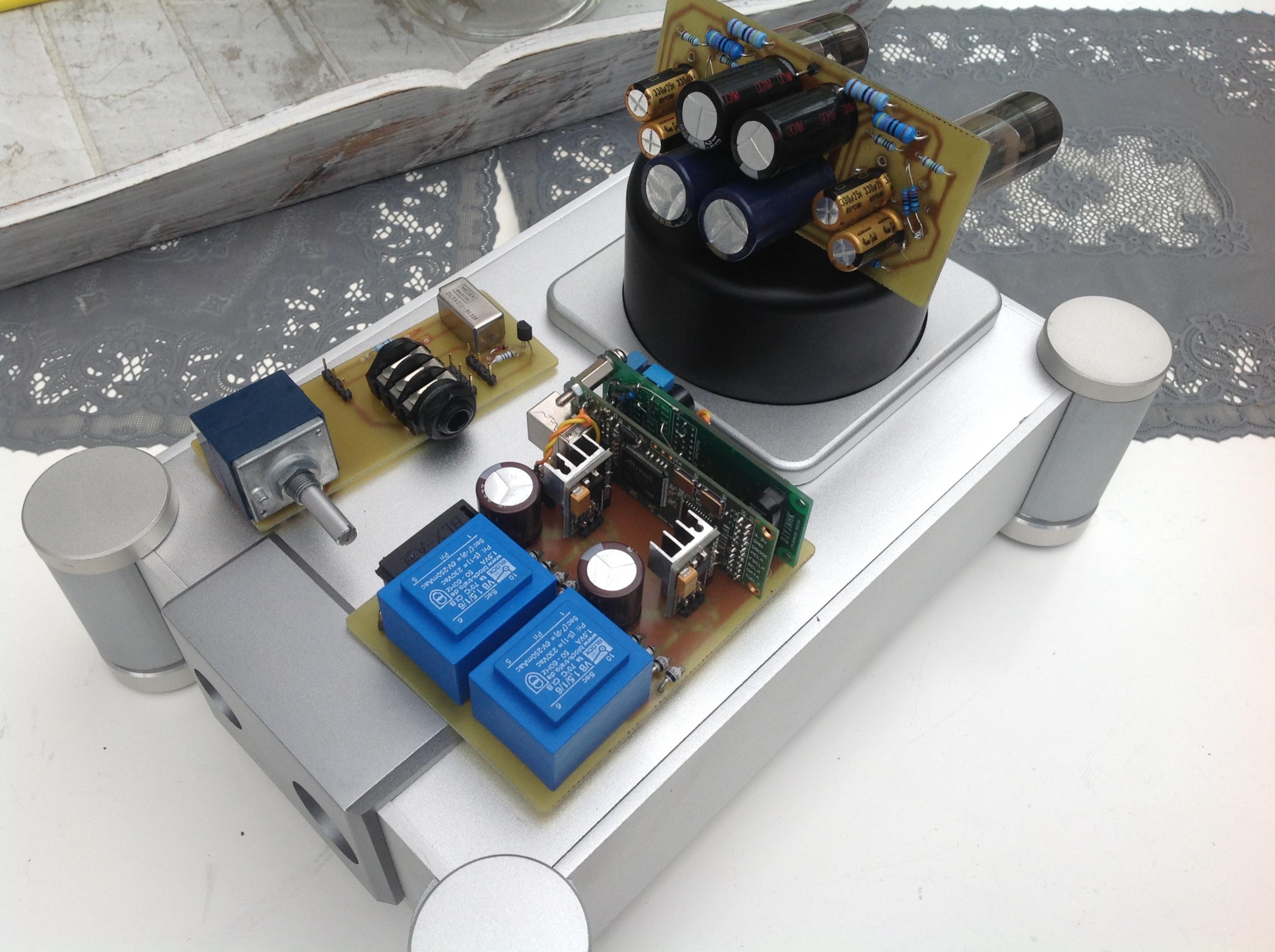

Now I'm using 5687 triode SE with hybrid mu-follower from Ale Moglia and it have more gain than the phono preamp MM Valve Itch, so a little less gain than 5687 fit perfect the gain.
Can you suggest other possibilities?

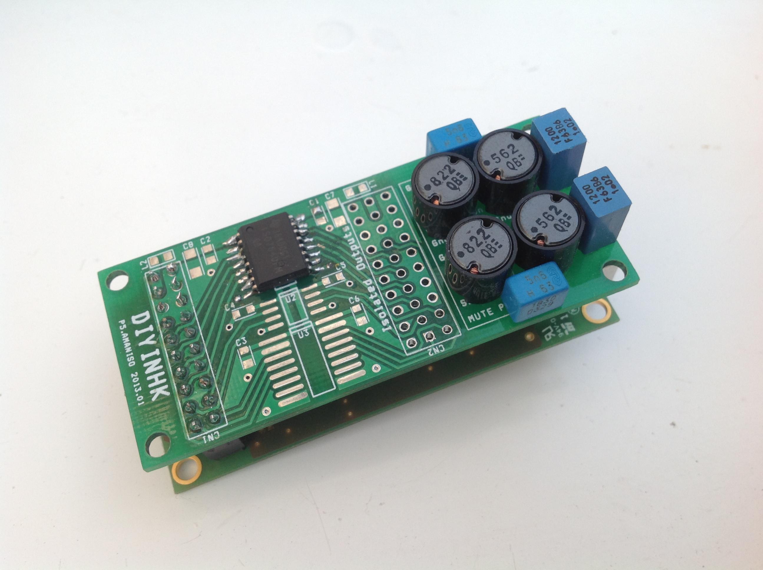

I'm trying to learn about the no DAC solution and have seen some threads here. My current DAC, ADI-2 Pro, also outputs a DSD direct stream that I believe bypasses the DAC. However, I want to explore other solutions. I am trying to understand how other solutions work. Looking at post 9, it seems an Amanero USB transport can be used with the filter shown to get the output. Am I understanding that correctly? Is anything else needed?
Thanks for the help!
