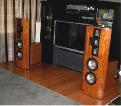

My Infinity RSIIbs do not need a sub.
nice speakers, I once listened to a pair of Infinity's that looked almost identical except that the midranges were cones not ribbons. nice relaxed sound, very musical.They're not all gone...
Those cone-mid speakers would be the RSII. The EMIM planar mids are extremely transparent now that I replaced the stock planar mylar diaphragms with true ribbon kaptan units made by Apogee Acoustics in Australia, and no more worries about blowing them out - in fact I removed all the fuses from the speakers.
You can see my homemade external passive crossovers behind the speakers, too.
those were real speakers, nowadays there's a tendency towards cute little boxes with high WAF factor.Those cone-mid speakers would be the RSII. The EMIM planar mids are extremely transparent now that I replaced the stock planar mylar diaphragms with true ribbon kaptan units made by Apogee Acoustics in Australia, and no more worries about blowing them out - in fact I removed all the fuses from the speakers.
My wife has learned to love them. When I talk about some day getting an Infinity IRS-V system (four cabinets, eight feet high each), though, the love ends...
