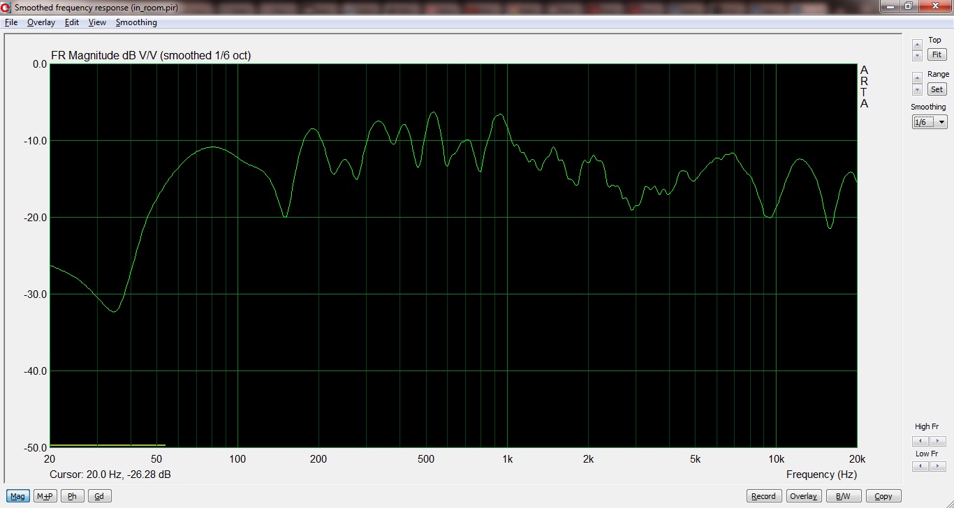

the room is small (3x4m / 10x13ft) and untreated. when I owned a measurement mic I measured the in-room response of my old speakers and the bass region showed a 10dB wide (~1 octave) null centered at ~150Hz.

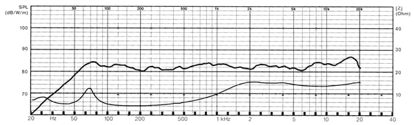

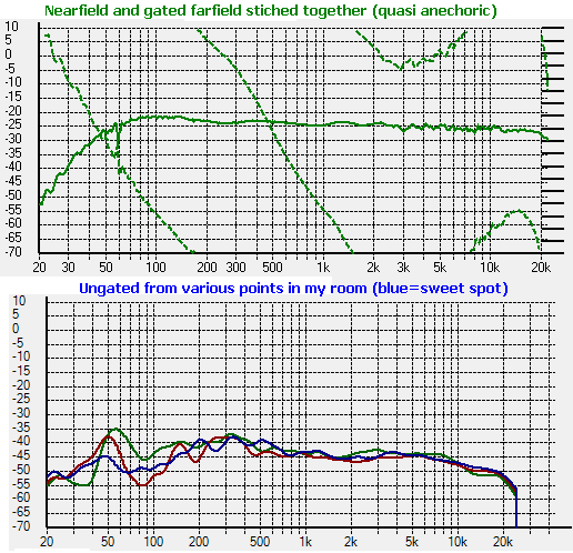

Hopefully these graphs will illustrate what we are talking about.
The 1st graph is the frequency response of my speaker.
The 2nd graph is how that same response is affected by the room.
Even the best speakers are at mercy of the room. And my room sucks.

what is the room size? carpets, amount of furniture? any treatment? speaker placement?
this is the in-room response of my old speakers, as measured with ARTA a few years back.
