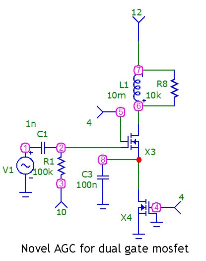

Good work, it looks like the trick for effective AGC with dual gate mosfets is indeed that Vg2 can be lower than Vg1 due to V(AGC). With source connected to ground, 0.5 V on g1 is enough, and keeping Vg2(max) at a value so that maximum dissipation isn't exceeded. I simulated the issue, with the BF992 at Vg1=0.5 and Vg2=2.5 Id=22 mA IOW in that case no more than 10V for Vd allowed. The difference in behavior is remarkable as well when simulating an AM signal. About 450mVp is the maximum of the signal on g1 before distortion starts to become visible.
This novel "never published anywhere" AGC for mosfet will solve all issues. Instead of a pinch-off control like used with variable u pentodes, this circuit aims to keep the current through the mosfet at the same value due to insertion of a (constant) current source at the source. With control voltage at node 3 between 0 and 2V (0V works as "delay" voltage) X3 has maximum gain, in this circuit ~43 dB. By increasing the control voltage, gain goes down. 10V control voltage remains below the gate-source breakdown voltage but in this circuit, gain then is ~-18 dB. IOW over 60 dB AGC range, and those who still want more, can get an extra ~20 dB by downregulating Vg2 of X4.
So, the current source MOSFET can be a low voltage type, maybe a BF2040 5 volt part?

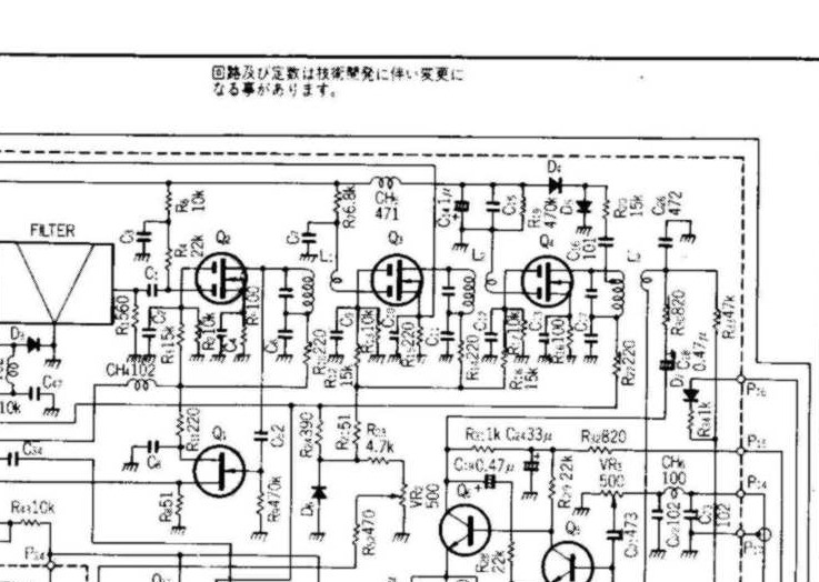

Just to throw another log on the fire - attached is the schematic of the IF strip of the Mizuho SG-9 main board. It's AGC is applying an increasing negative voltage to gate 1 of the dual gate mosfet, and gate 2 has a constant fixed voltage. The FET's are 3SK49 which looks to be a garden variety 200 MHz, 20 Vds, 40673 type part. The diode depicted looks to cross reference to an 8 volt zener, which seems a reasonable choice in that position.
This AGC is super simple and works quite well - a little fast for my taste, but not enough for me to go in and fiddle with the time constant.
I had to fix it earlier in the project ( the SG-9 came from a scrapper radio ), but I didn't pay any real attention to it other than fixing it.

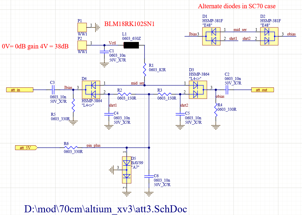

The current source can even be made with BJT + diode or 2 X BJT. It isn't critical because the of the decoupled source. Very long ago I was living close to a MW transmitter, 300mV on the "wire in a tree" antenna. The 1st IF had to face an input voltage no existing stage could handle - experiments led to the above. You're right about the speed: the control curve (Vcontrol vs Gain) is far from linear. The fast change happens in the region where Vg2 becomes lower than Vg1. For a first stage you can set up a proper control network with delay in a way that even with 1V rms input, no overload occurs. Hence the region 0...2V with little change in gain is useful because AGC in a first stage shouldn't influence the S/N of the demodulated signal.
That's the way I do it in my new 432 MHz transverter.
It is based on a HP/Agilent app note. Some PIN diodes do not work
at a MHz or below because of carrier lifetime.
Current starved MOSFETs are not the way to linearity.

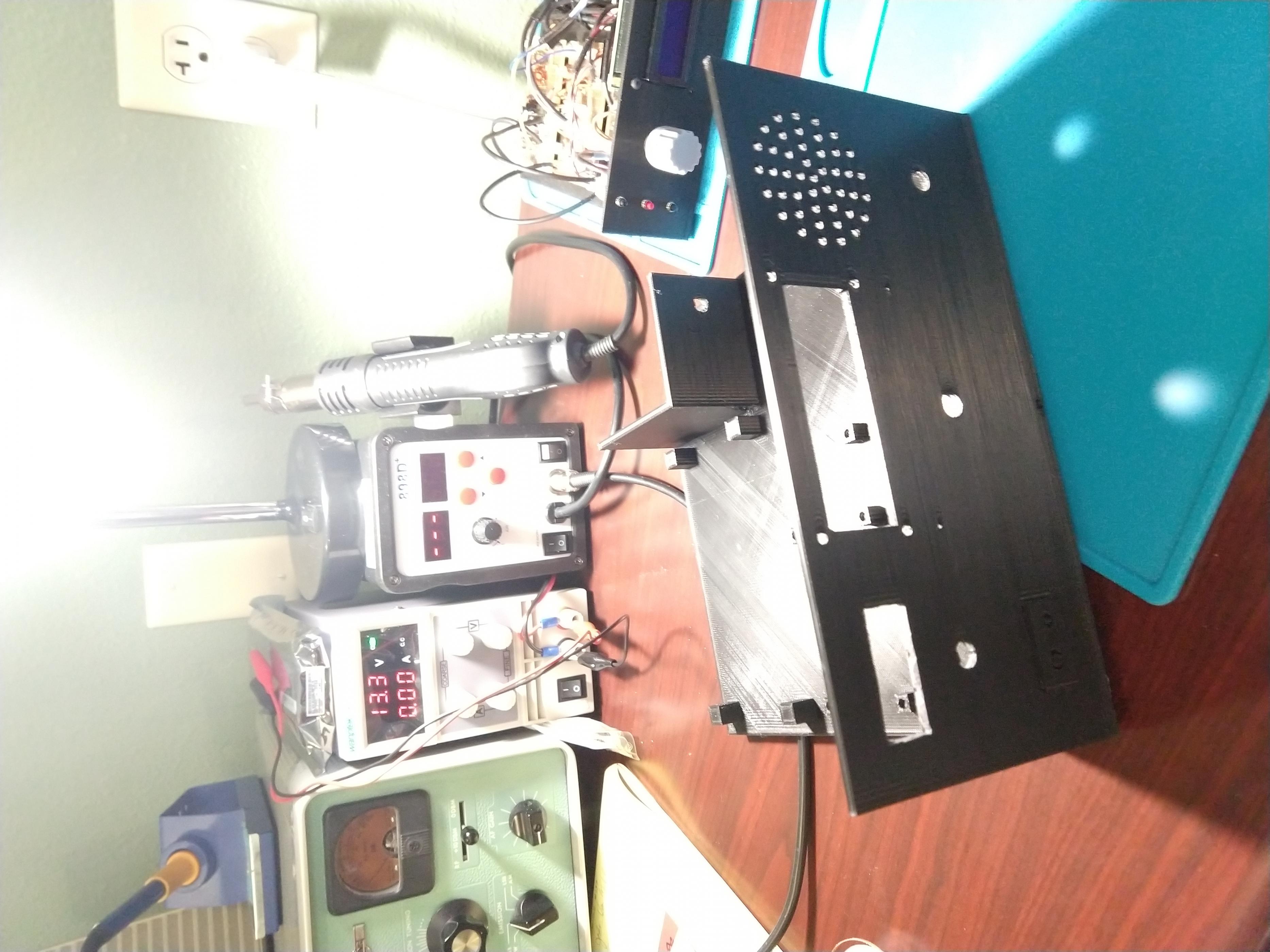

I printed up a preliminary breadboard so that I can have something to mount the boards on and begin to test them for function.
I scored a dozen genuine Central Semi 2N3866 transistors on eBay, so in addition to the may or may not be 2N3553 parts from AliExpress, I now have some transistors to burn experimenting with a push pull PA for the transceiver.

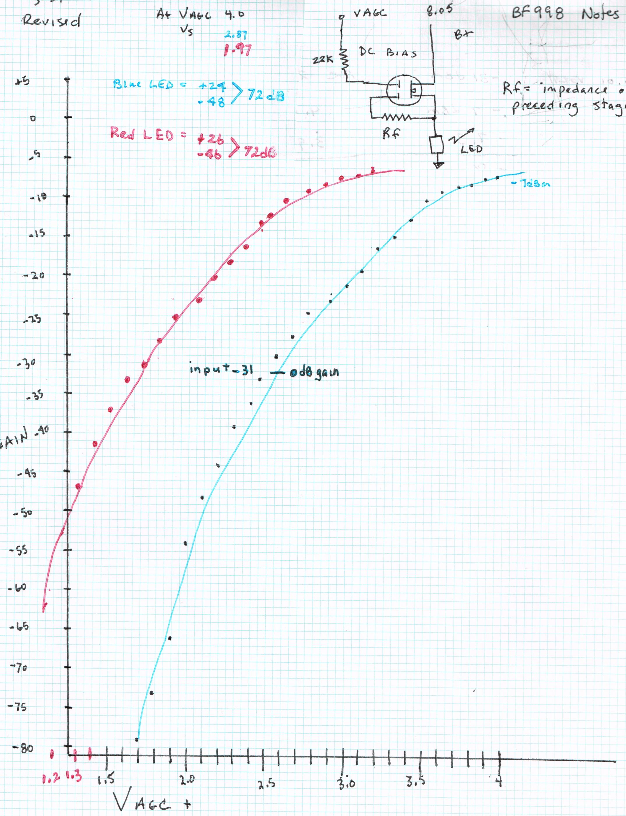

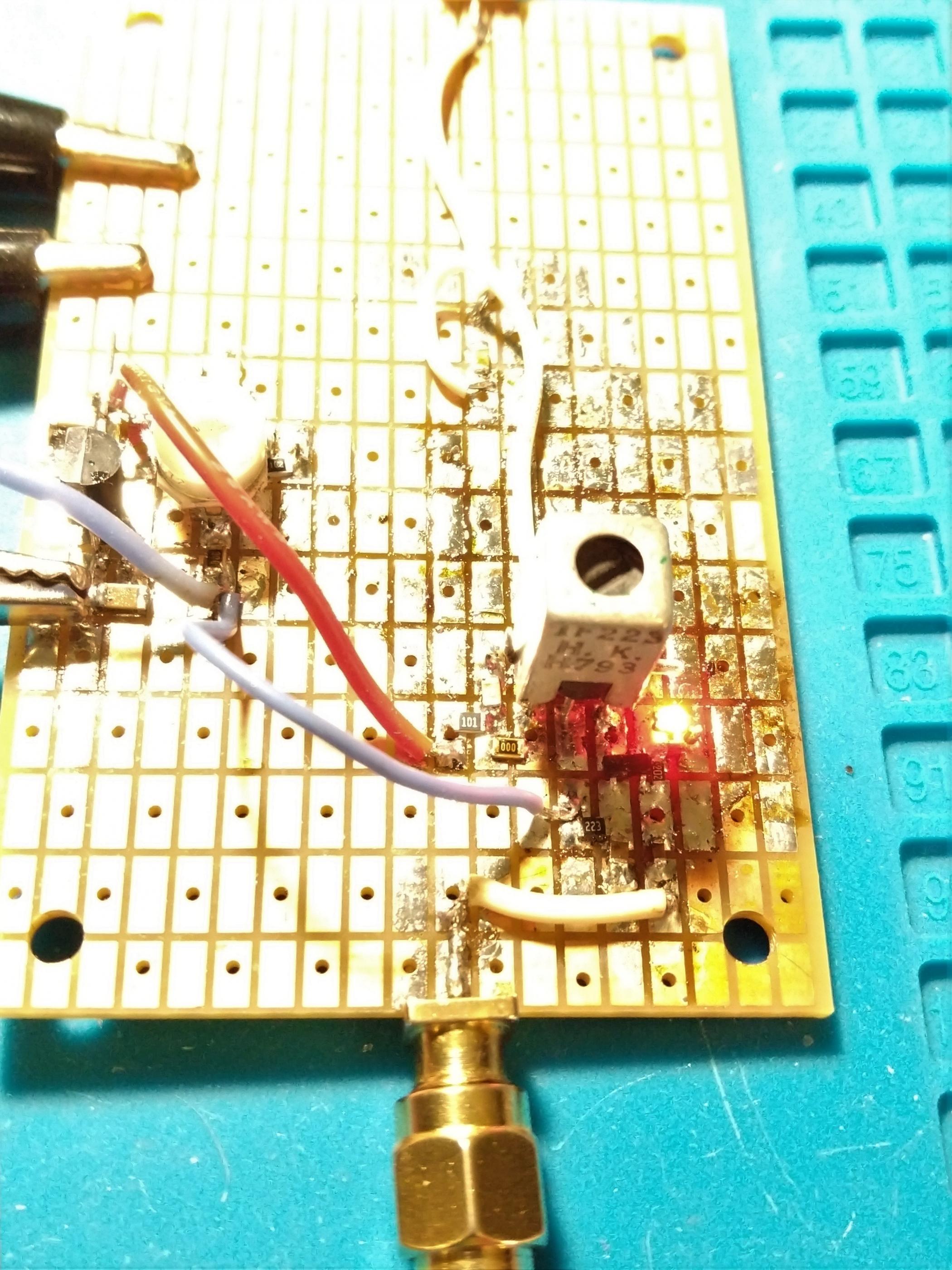

So it works a lot better now. I think this is a BF998 transistor; I've burned up a few and the marks are no longer readable on this one. But I think it is a BF998.
The best technique is to put the source at DC ground through the LED, and then bypass it for RF. The value of the resistor connecting the source to gate 1 becomes mostly unimportant, and can be set to the impedance of the preceding stage for easy impedance matching. Right now I am using 2000 ohms. That value would have resulted in no gain in the prior iteration.
I tested with blue and red LED's, and regraphed everything. It does appear very practical to time the AGC according to the color of the source LED. Red shifts the gain curve to the left. I did not test LED colors between blue and red. Presumably the curve could be shifted right by using 1N4148 or similar diodes, but I did not try this.
Presently, a cheapo 0805 AliExpress red LED yields 26 dB gain, and 46 dB attenuation. A cheapo 0805 blue LED gives 24 dB gain, and 48 dB attenuation, the spread in each instance being 72 dB. This seems pretty remarkable for such a simple circuit with just one forty cent transistor.
I'm using a slug tuned IF transformer to tune out the funky harmonic distortion that comes and goes as the AGC varies, and it seems to have accomplished that purpose. The circuit looks very satisfactory on both the scope and spectrum analyzer. The picture is bad but there is really not much to see.
